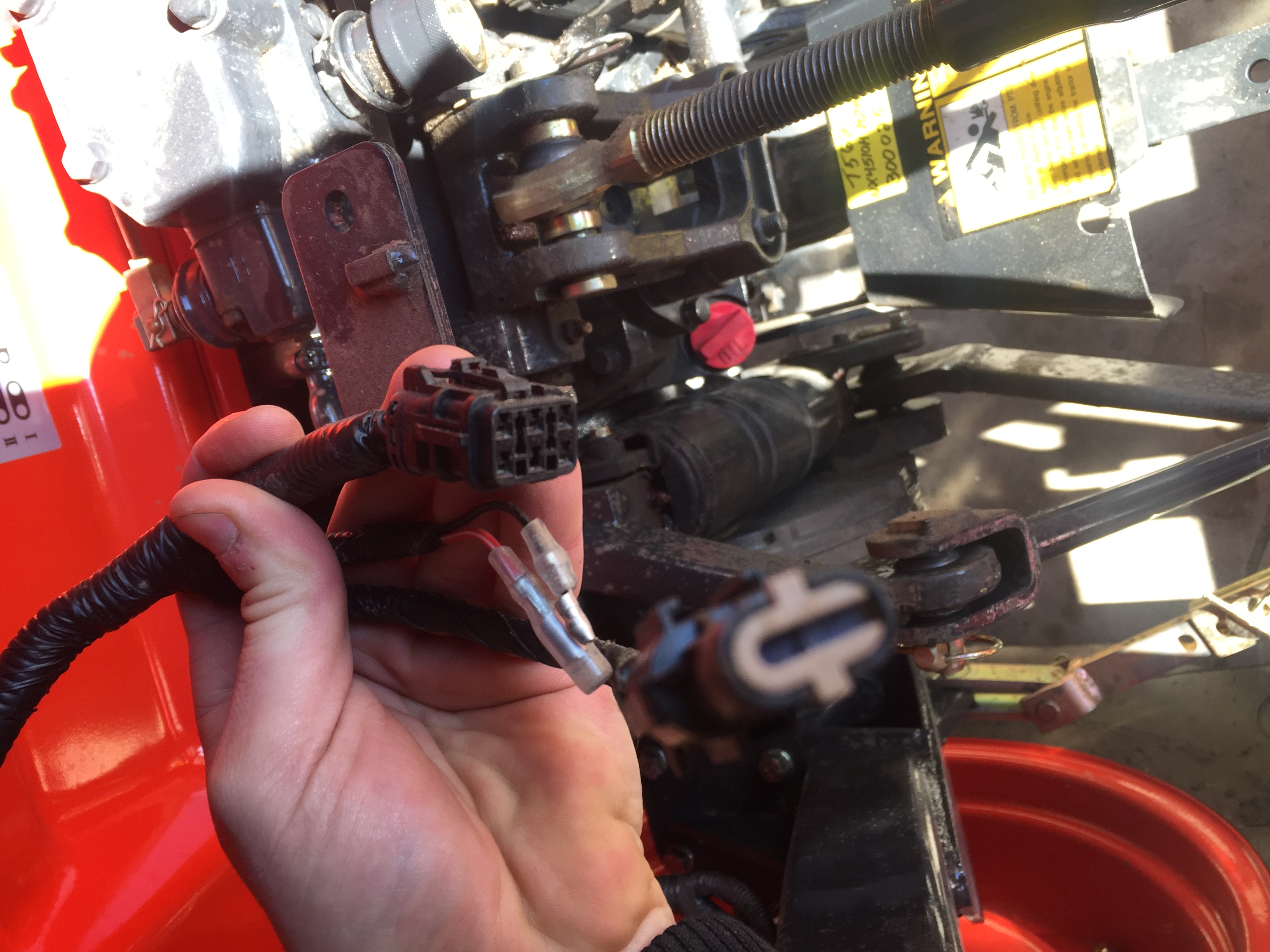

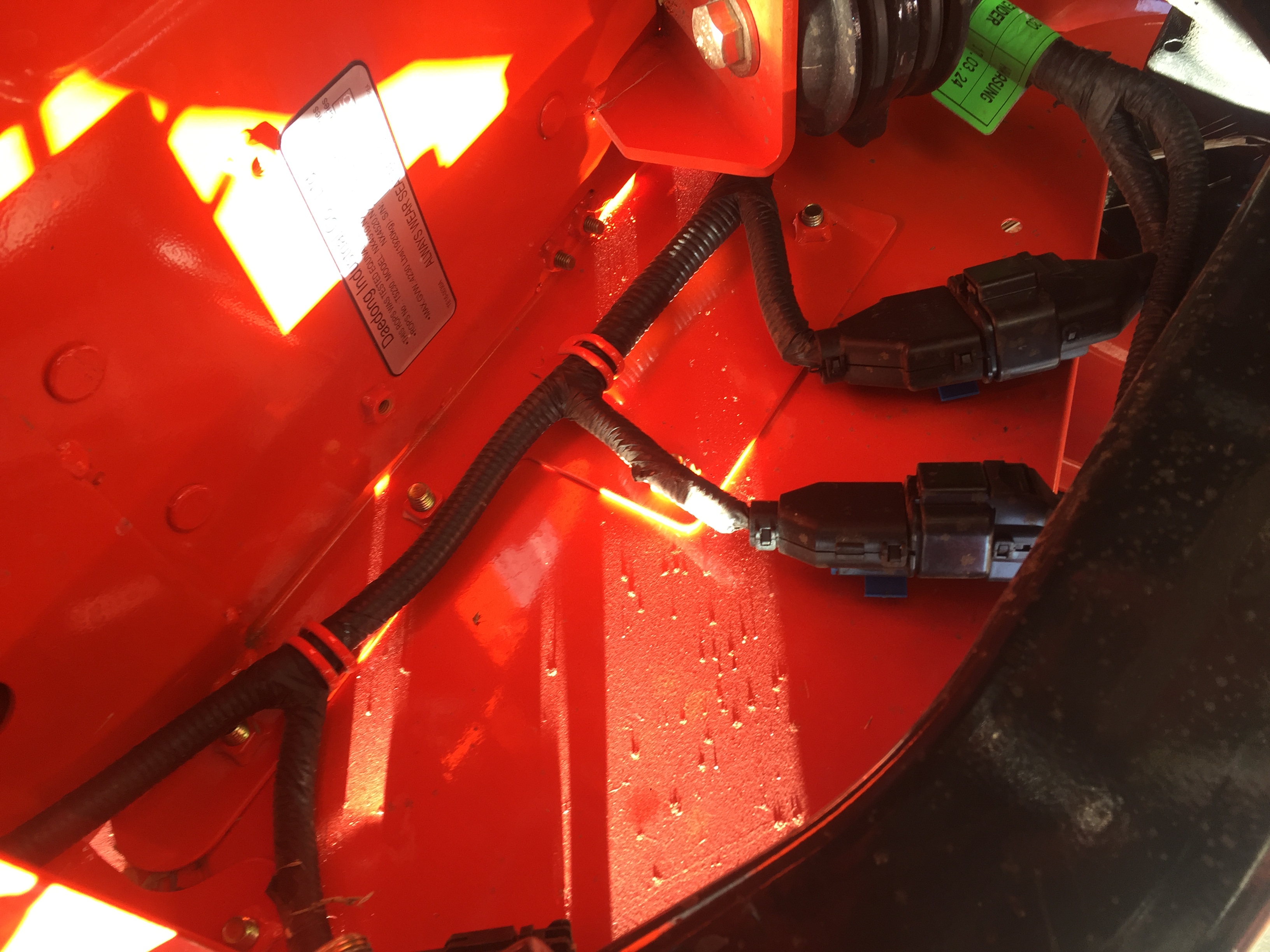

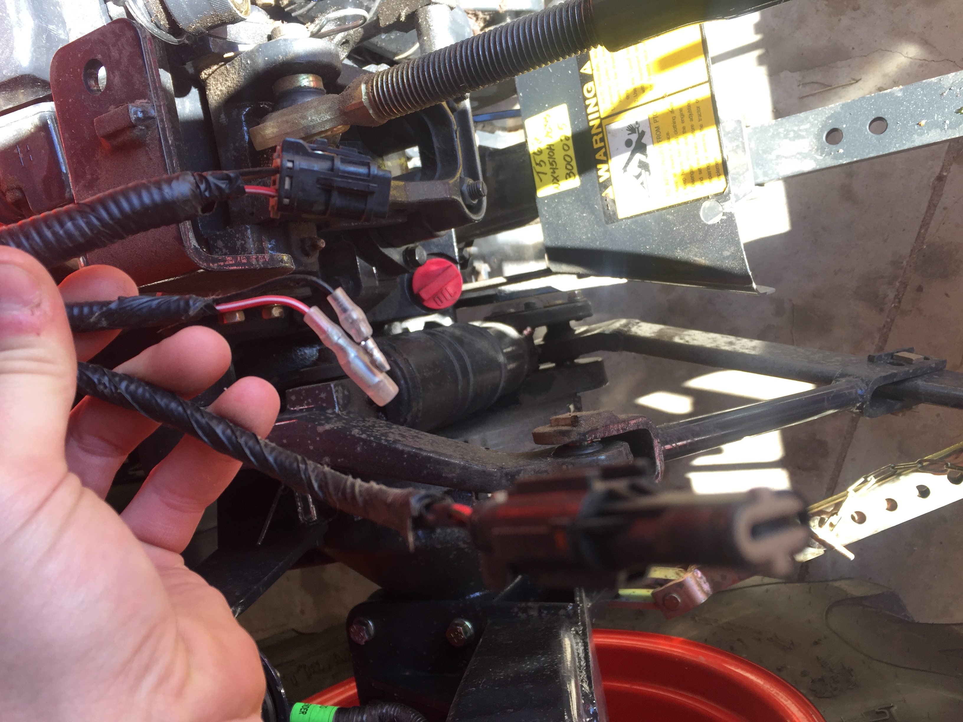

Hello,
I was wondering if anyone knew what these unused wiring attachments are intended for on the rear of the NX4510?
Thank you,
Nick
   / NX4510 rear wiring bundle question #2

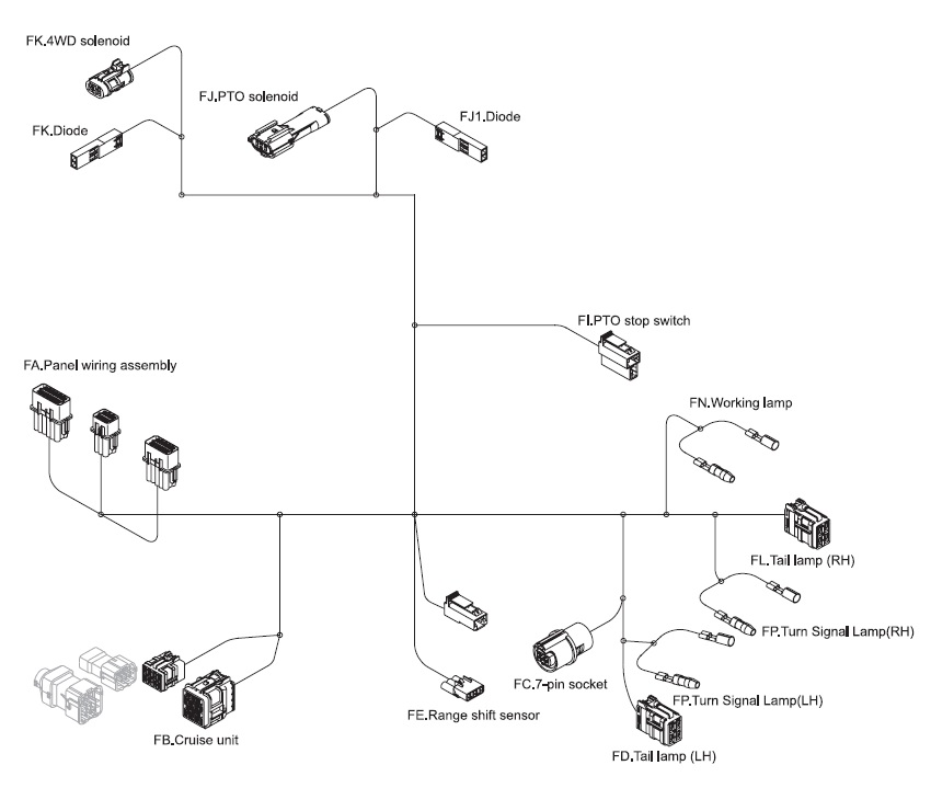

Well, the black and red wire, at least, may be for a rear work light option. My DKse's both had these extra wires in the back, I believe the fuse box even said "working Lamp". Volt meter confirmed. But I'm sure someone with an NX will chime in soon.
   / NX4510 rear wiring bundle question #3
Actually, looking at a wiring diagram i have here, it may be from your left hand turn signal (2 wires) and tail lamp, (harness)
Keep in mind this little diagram is from an EX tractor, similar to a DKse, but in Australia. Just happens to be what I have.
   / NX4510 rear wiring bundle question #4
If I'm looking at the correct diagram (big if) it shows a working lamp for the bayonet connectors, a beacon lamp for the oval connector, and the interface for a 7-way trailer socket for the square connector.
