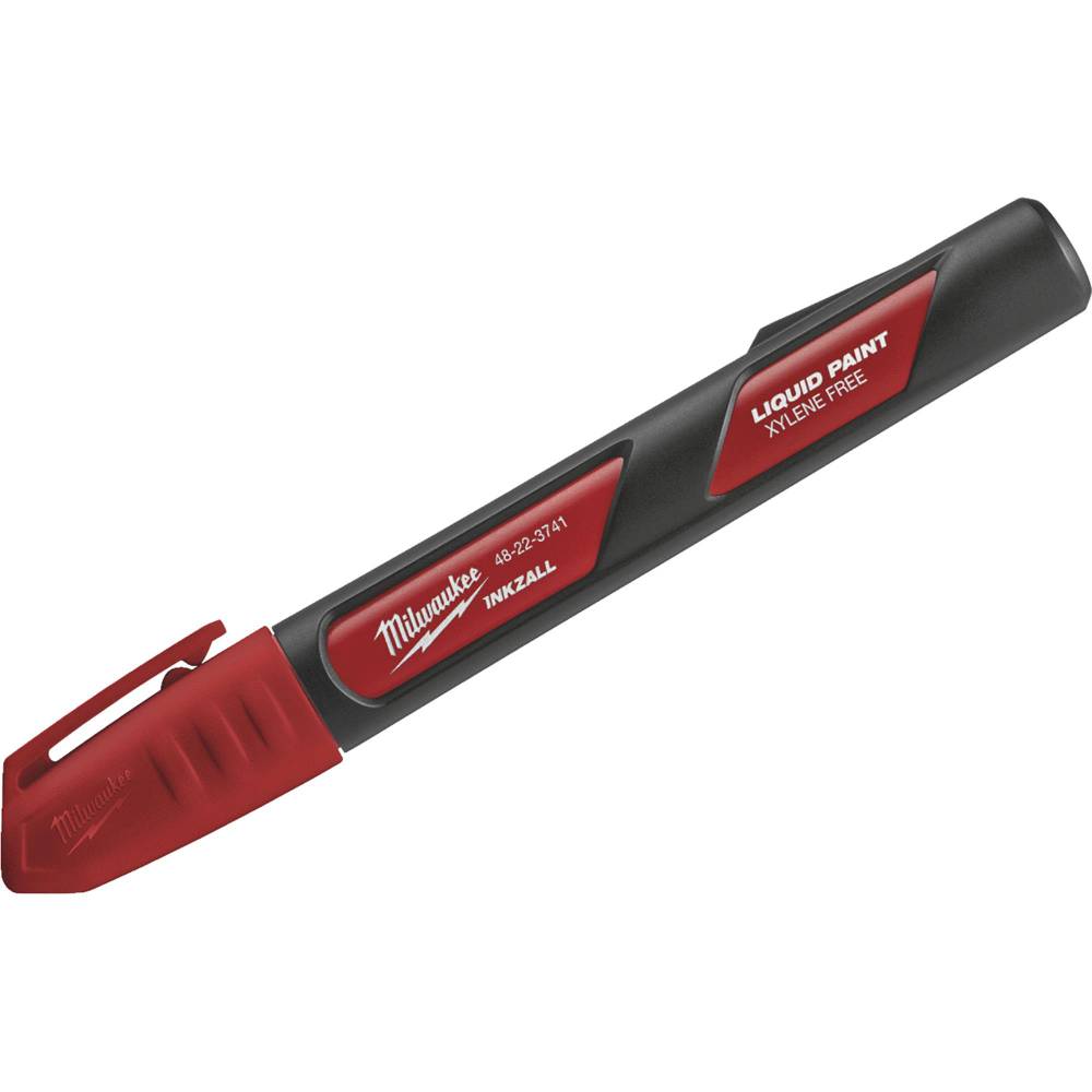

Use a paint pen. The ones that have the mixing ball inside. Like junk yards use to write on parts. Oil based and sticks to everything that sharpies won't.
Milwaukee makes a good one. a98dfc63-b6c5-42f5-8be3-8130cae3e4f4_1.a54037e96b9f042b3106312af0e7b52b.jpeg
