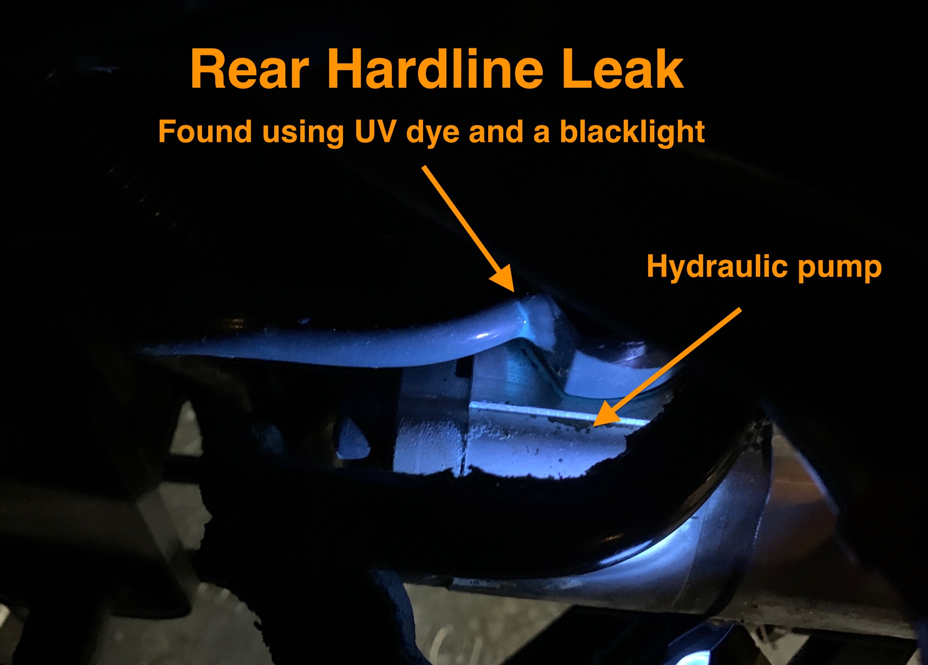

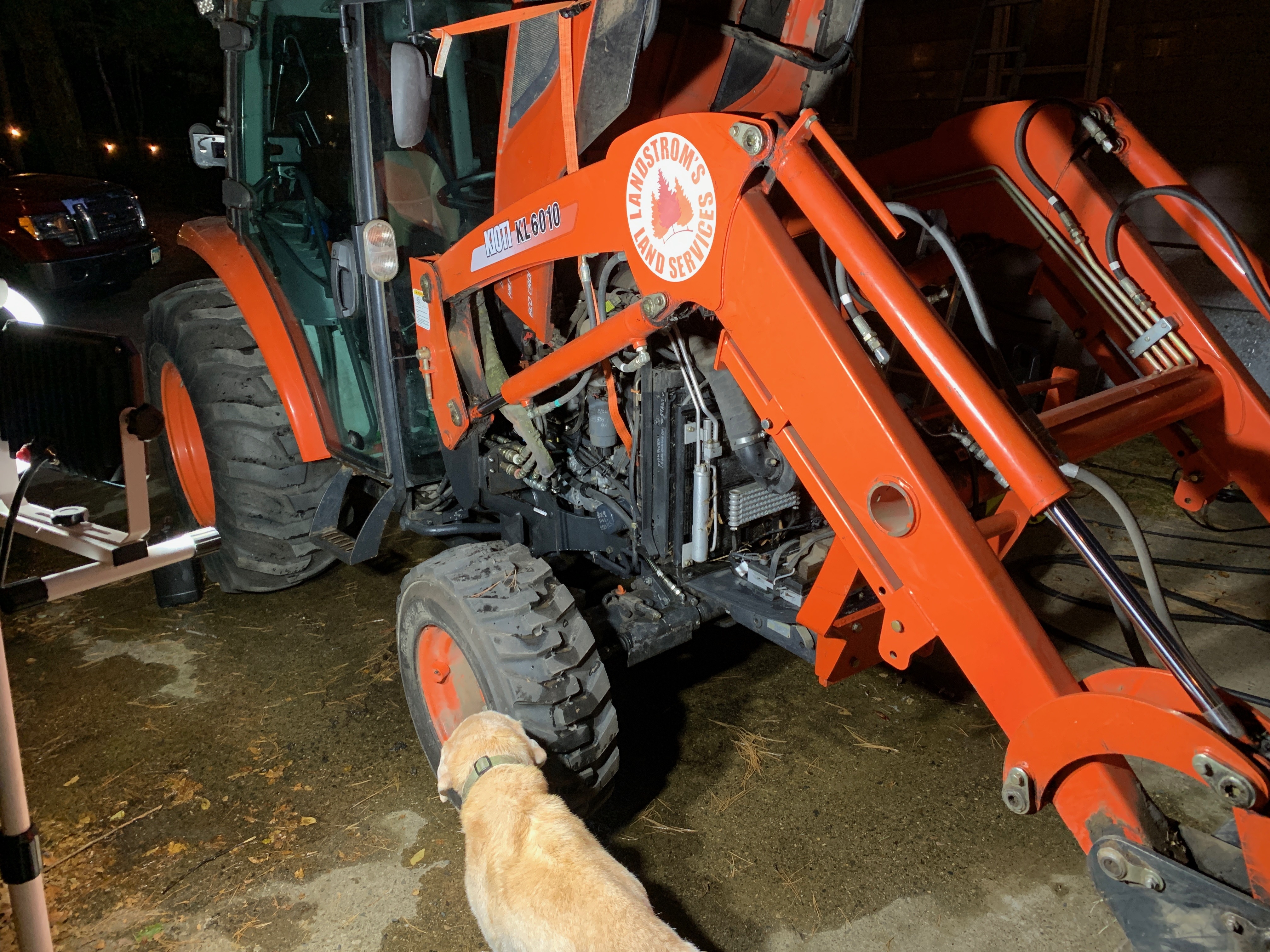

FWIW, my tractor has a hydro leak that is bad enough to be dumping about a gallon out every hour. Since it is getting cold out, my tractor came back to the Tinkerage and after trying to puzzle out the problem, I ordered hydraulic fluid dye and a black light and pressure washed everything.
As suggested above, it looks like it may be coming from the hydraulic pump, but everything is so slimed up, that I'm cleaning everything up as best as I can and will mix in the dye and use a black light to try to locate the source of the leak. Dye is a week out. Bummer.

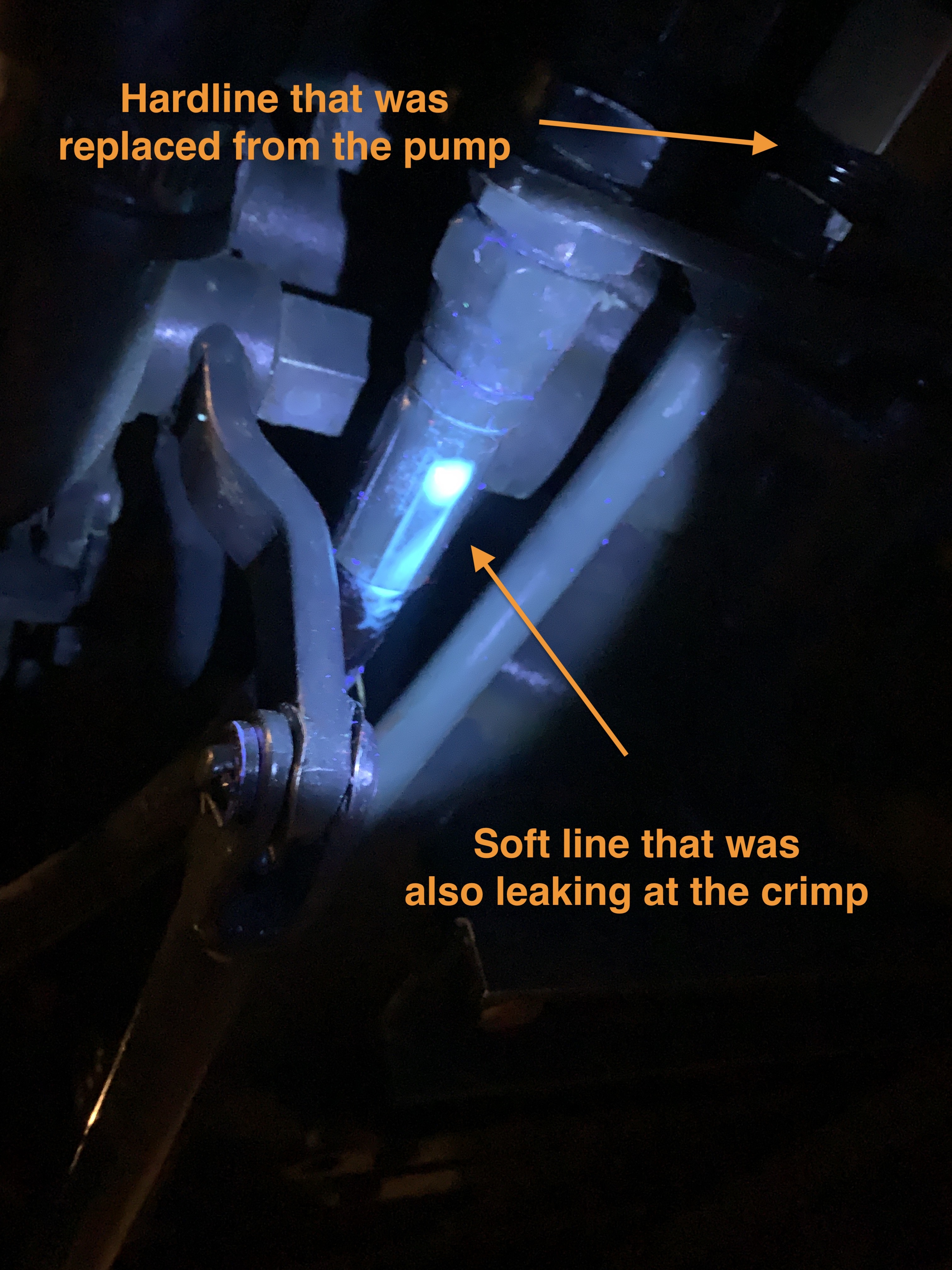

Did you have a chance to sus this out Eric? Mine is giving me problems again, similar symptoms to before, air in the lines; probably not the same issue (I'm not leaking fluid) but maybe your problem can point me to somewhere else to look?
I did. I had a hardline leak off of the pump and down where that hardline attaches to a bracket, a soft line going to the joystick was also leaking.
