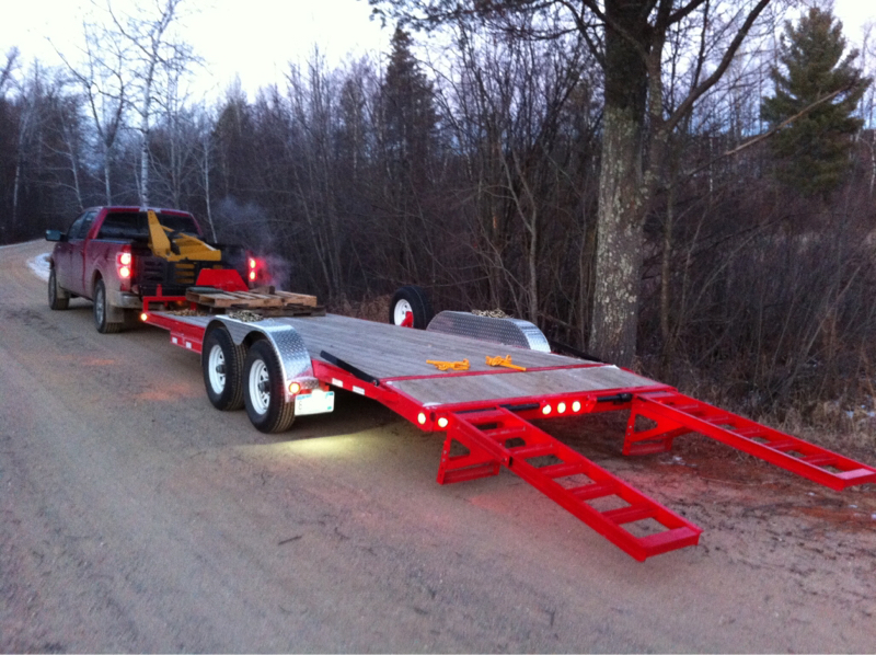

FWIW, the NX6010 is 78" wide with industrial tires.
You may also want to think about trailering as well. If I had to do it over again, I would purchase a 24' long trailer instead of a 20' trailer for my NX6010.

+1 on this. The trailering issue is something to keep in mind while you're shopping so you're not surprised later. If your tractor ends up being a full 84" sidewall to sidewall, you won't be able to move it around with a nice car hauler like Eric's, or with many other standard-width equipment trailers, for that matter. You will likely need a deckover or a rollback truck. My NX4510HST cab is 84" with the big Titan rear tires, which I love. But I knew about the hauling going in.
   / NX6010 vs RX6620 vs RX7320
I was not planning to trailer it. I was planning to have it delivered and that was it.
