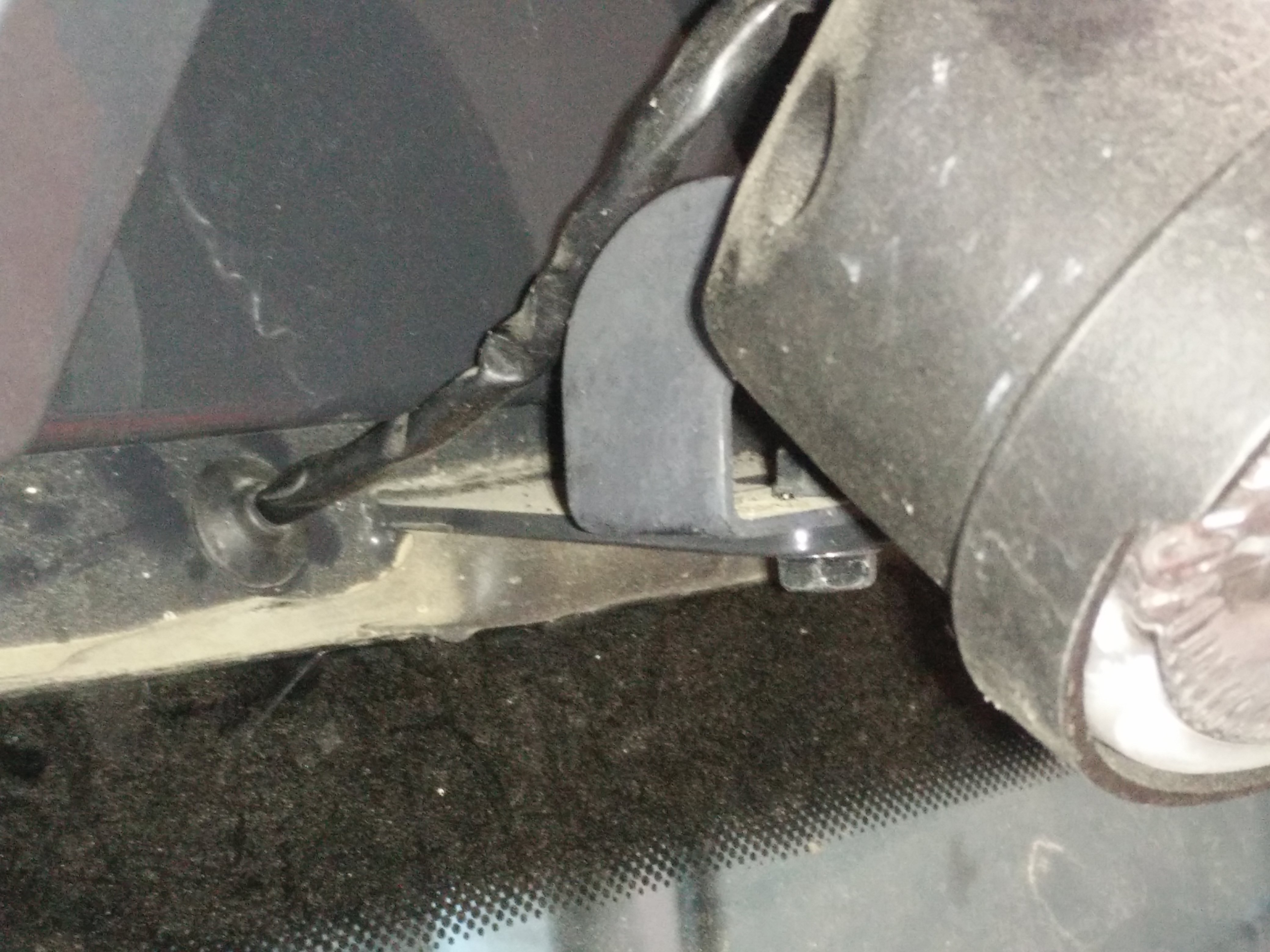

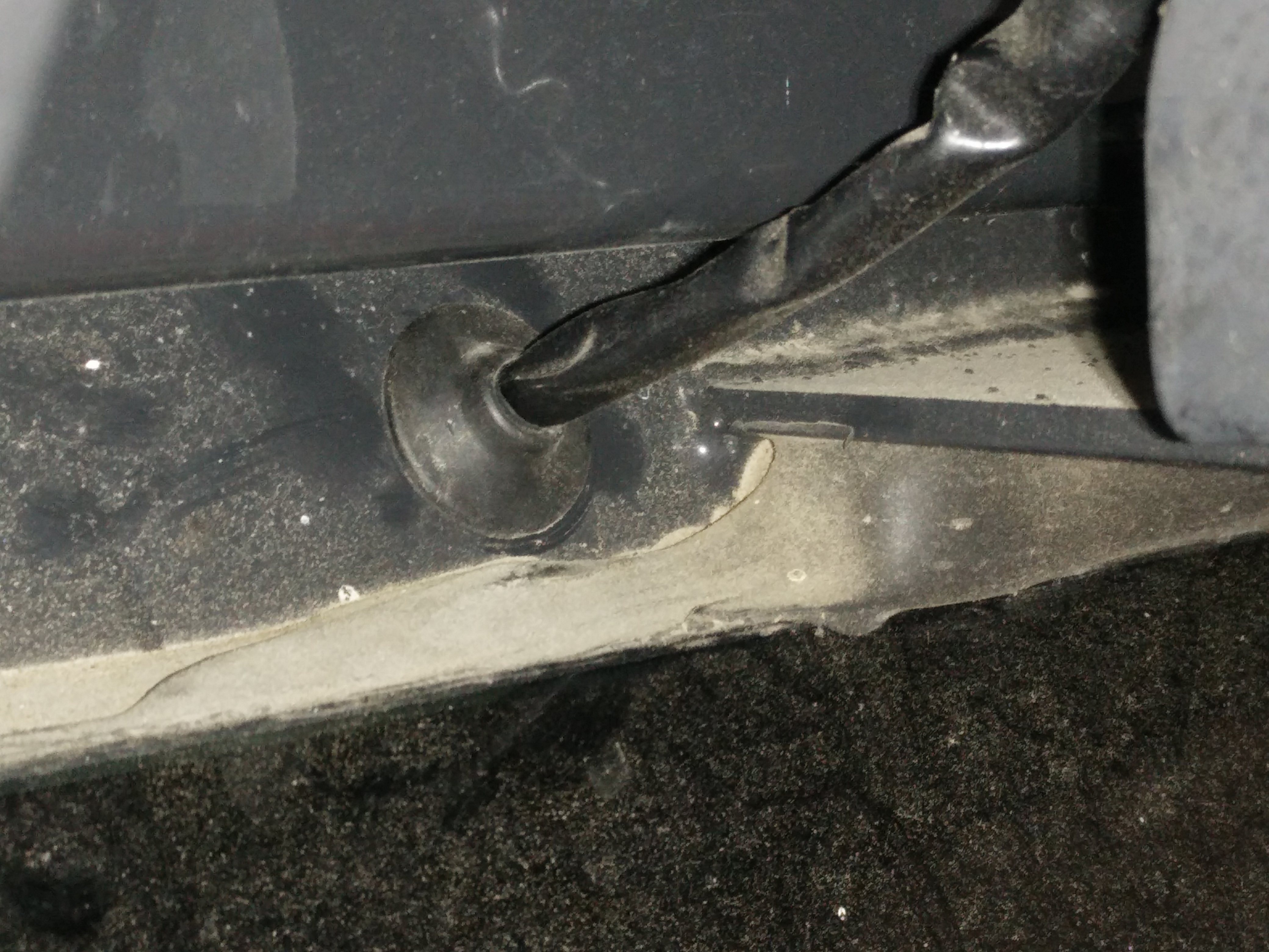

So did some more investigative work today as to where this water was coming from. First I took off the roof, well took off the nuts so I could raise it and take a look. I then ran the AC for about 15 minutes and confirmed both drains from the cab were working correctly. Water was dripping out a lot, and no water in the roof. I then ran the wiper washer for a few times and again looked and no water. What I did find was the grommet that seals the hole for the front work light power wire was popped out of its hole. Best I can think is perhaps water got in from a rain shower. BUT I rarely park my tractor outside and can't recall it recently being out in the rain. So not ready to say with certainty that was the problem.

Craig, try blasting the outside with a hose and watching for leakage. Best done using two people, one inside the cab and one outside running the hose.
I'd still look harder at the existing plumbing bits. Maybe try to plug up the wiper washer outlet and see if the pressure backs up anywhere: careful to not run it too much and stress the pump.
Also, check all the penetration points on the upper cab. Water can find itself in one place and then run elsewhere and the fan out.
To me it seems like you'd have had to have had quite a bit of rain in order to achieve that level of staining. For what it's worth, I have used "Awesome" cleaner (I think the carpet variant, though might not matter that much) to clean (use dabbing) the headliner in the wife's Golf (leaking washer fluid).

Dealer was out today and we decided the most likely source of the leak was from the grommet being unseated. He is going to reach out to Kioti and see if they will replace the liner under warranty.
