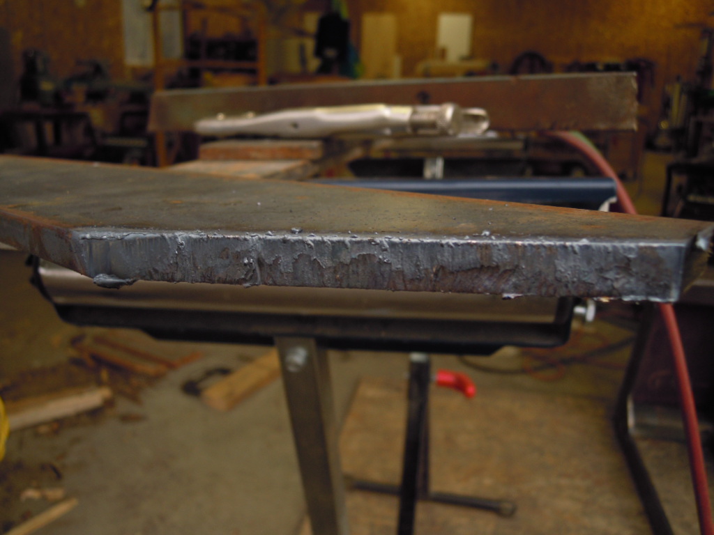

I'm a newbie at this and I'm looking for some help. I've been cutting some gusset plates out of 3/8" x 3" flat bar. First I cut the bar into 8" lengths with my abrasive saw and then I cut the 8" lengths on a diagonal using O/A.
The issue I am having is that one side of the diagonal cut is nice and square to the face but the other side of the same cut is on an angle. Sometimes the angle is pronounced. What am I doing wrong?

Sounds like a dirty cutting tip. That is the case in 99% of the times when cut is not clean. A clean tip produces a lot less slag on the backside also.
For up to 3/8" plate, an 0 tip would be the size to use. It requires less gas to operate and will cut 3/8" plate easily with about 35-40 psi on the oxygen and 5 psi on the acetylene.
Get your tip cleaners out and clean the tip till you get a long feather like in the ShieldArc photos and hear it sounding like it is sizzling.

Sorry guys but no pics. I already ground the pieces and some are welded in place. The cut is not bent in the middle. It is weird. One side of the same cut is square to the face and the opposite side is at about a 75 deg angle.
I am using the 0 tip as that is what my Victor booklet states to use and this is a new tip. Maybe only used it for 15 minutes but I will clean it.
After looking at those pics of SA's I think this may be the issue. I'm still not sure what the neutral flame is supposed to look like (even with the pic staring me in the face) but I know for sure my cutting flame does not look like SA's pic. I've been adjusting the cutting flame to get suck that orange flame back to the tip of the blue flames. I've had that jet engine but thought that was wrong. Know I know better and will try again. Thanks for that SA.
For preheat, should I preheat the whole cut area or are we just talking about the start of the cut, to get that puddle started?

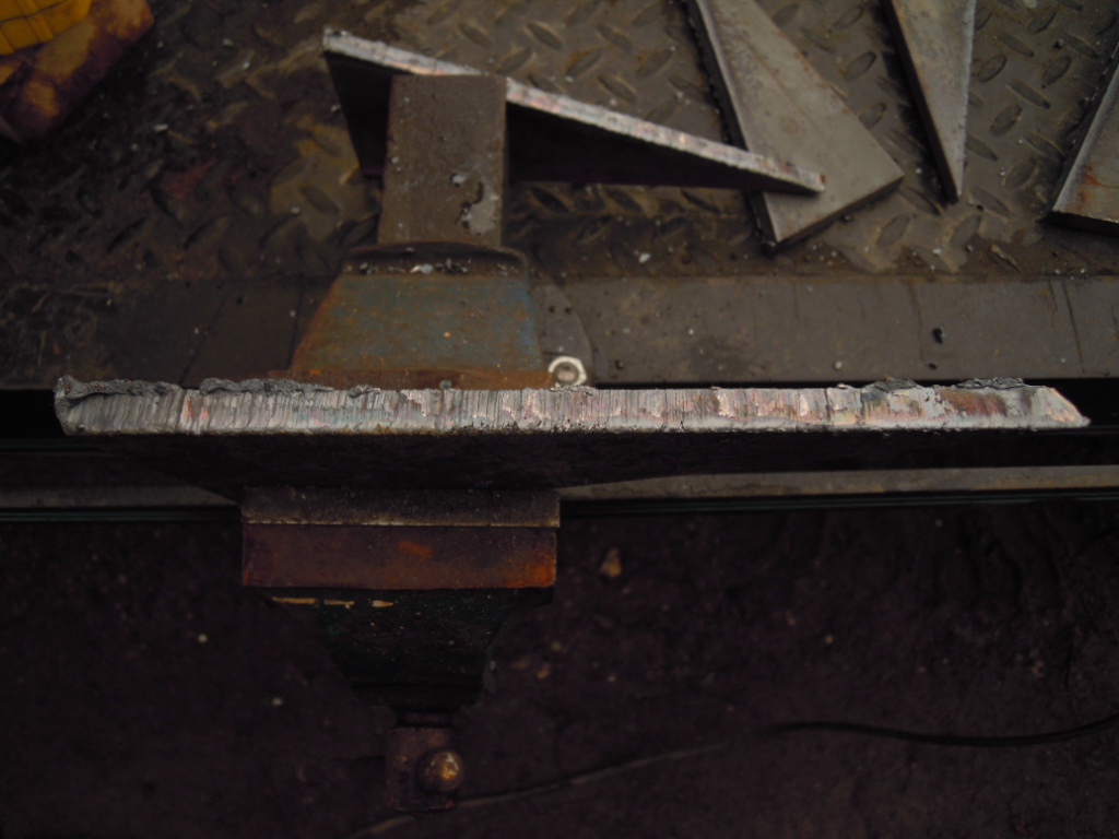

I tried to watch it but after about 5 minutes of downloading I was only able to view the first 40 seconds and then the infeed stopped. I'm in the country and have satellite internet service but it is not very fast and this happens a fair bit.
I did watch another video this morning before heading back out to the shop and I think that, combined with your pics helped. Anyways I only made 2 cuts today and I was very happy with the outcome. Here is a pic of one.
I don't know why the second pic is there. It shouldn't be. I tried to delete but can't.

Hibilly those are very acceptable cuts!:thumbsup::thumbsup: You are well on your way.;)
Mike, I angle the torch, especially on thin material. It's all a matter of tip size compared to metal thickness.
