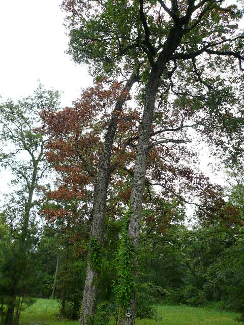

Hate to say it but you've probably got oak wilt.
Have you been buying and storing firewood around the trees?
Have you had a tree service doing any work on them recently?
Oak wilt has killed thousands of acres of live oaks and red oaks here in Central Texas. It is expensive to treat for it; you're better off planting resistant oaks (in the white oak family), than treating your current trees.

okay, here's 3 shots (ignore the live vine- that's the only green thing on the tree:(

Anthony,
I agree with KB...It's most likely Oak Wilt. I've heard that it was over this way. My brother in the San Antonio area lost about a dozen on his place. It could also be root rot with all the rain we've been getting but I think that's stretching it a bit.

It really sounds like oak wilt. I am in the process of losing 4 oaks in my front yard right now.(it has been moving thru my are for about 4 yrs now) not much you can do they say you can dig a 4 ft deep trench around the tree and sever the roots from other trees (my neighbor did this and it did not work).
I have been told not to cut it down until you see bark falling off and that they sometimes go dorment to try and fight it. I have one tree that has had it for three years and appears to be coming back. I did however lose the biggest in my front yard this year( about 3 1/2 ' in Dia)
It kills red and white I have been told Bur oak is the most resiliant but I do not know first hand as I do not have any on my property.
