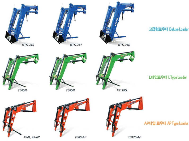

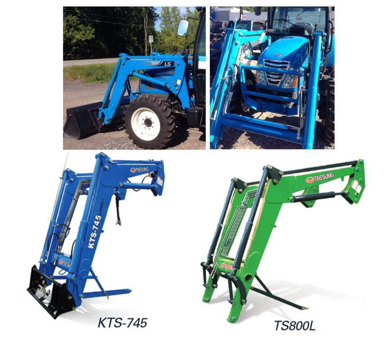

Here are the FEL pictures from the Taesung product catalog and of a new XU5065CPS thanks to TBN member Deerherd. They appear to be very similar designs, and the listed specifications for loader height, weight capacity, dump pitch, etc. are roughly equivalent (but not for the model numbers listed in the pics).
Taesung also has had business relationships with LS since 2008 and Kioti, TYM, Mahindra before then. If isn't AmerEquip's loader on the XU, can understand why these Korean tractor companies would source implements domestically for tax, freight and/or QA/QC benefits.

Yea they are similar but still not the same. What type hoses are there on the LS tractors? If they are metric well made in Korea SAE US, yet that is kind of circumstantial evidence but it might be correct. :D
   / OEM for LS-branded LB3101 Backhoe (for XU series)?
Thanks, G. When it gets here I'll examine more closely and report back on both the FEL and BH. For now I'm 99.9% certain the BH is a Taesung design... who manufactures/assembles all the individual pieces could be another story.
