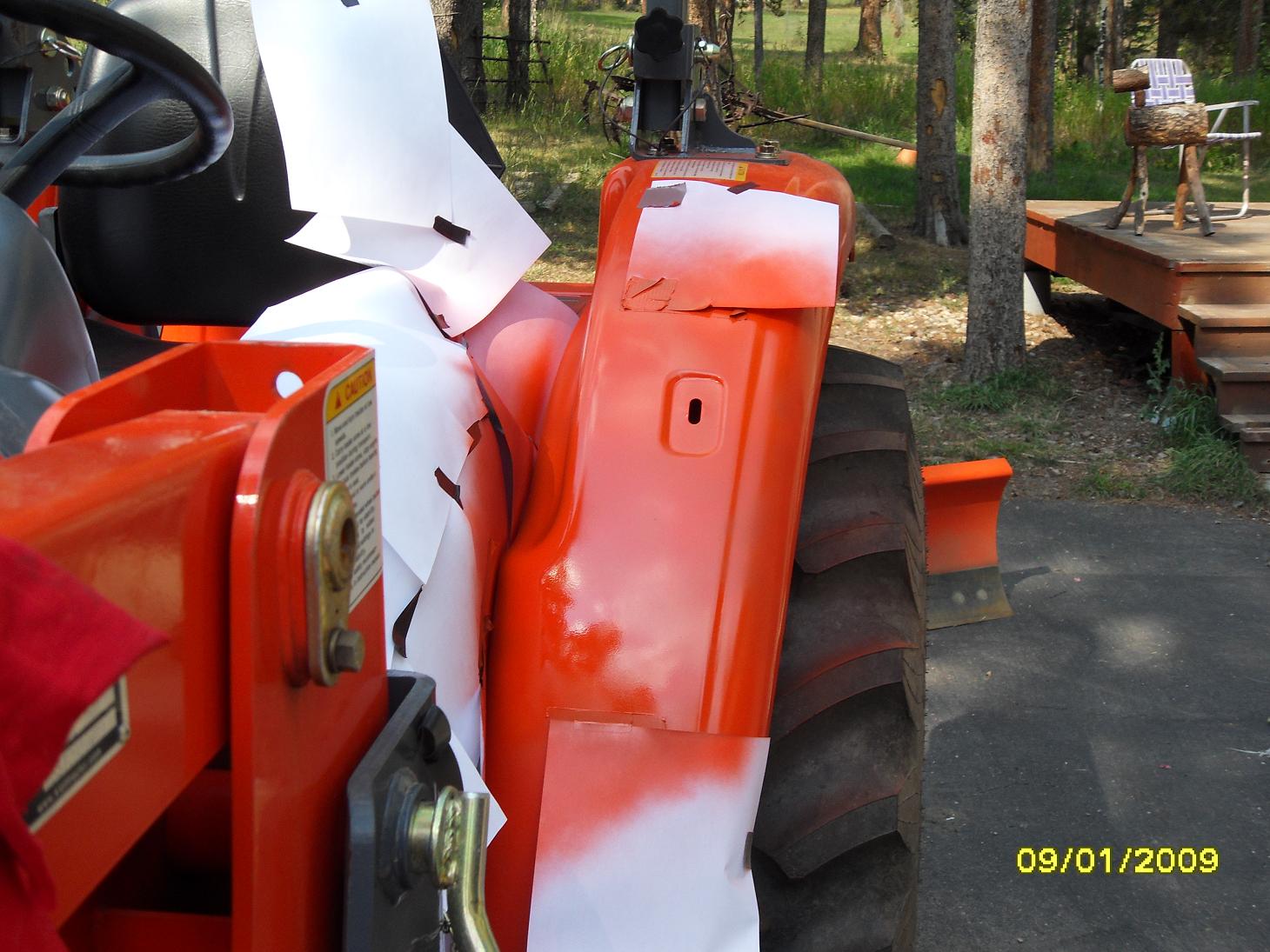

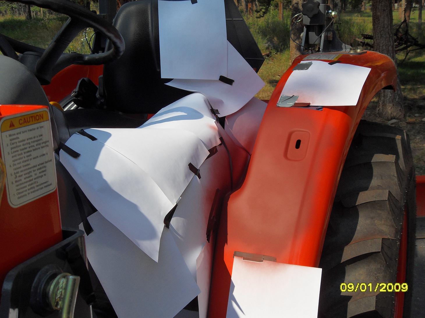

I feel your pain brother. When My tractor was a few days old I took the seat out to drill a extra hole in the slide for the PERFECT seat height. Brilliant move I thought.. but when putting the seat back in I slipped and dropped it on the left fender ... GIANT scratch / gouge in the paint.
I sanded it down and used some red primer, and then some Chevy Orange and it matches pretty darn good to my eye. I think it was duplicolor 1620 .. I'll double check that.
