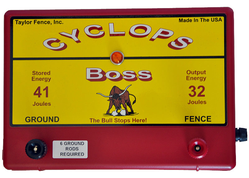

Good solid advise given to you in posts B 4 IMO. Also how long/guage is wire extension between E-charger and power box ? What type brand charger you using ? How many joules ? Can you borrow someone's elses box and see if it does same thing ?
