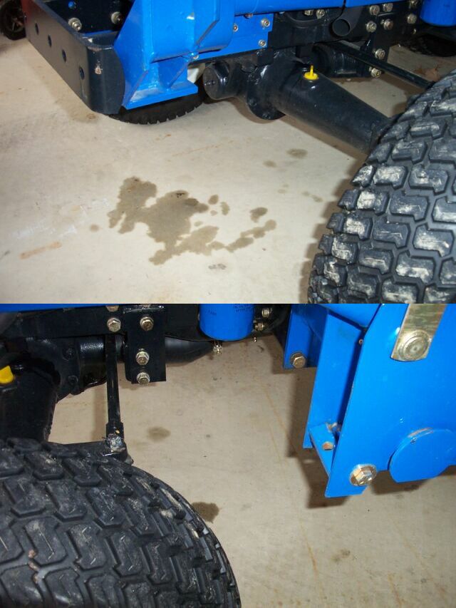

I was out in the garage the other day and I saw some melted snow under my tractor. A few days later it was still there. /w3tcompact/icons/hmm.gif Hmm, that should have evaporated by now. Uh Oh, on closer inspection its hydraulic fluid. It's dripping from the hydraulic filter, the frame, all over actually. I'm gonna do a closer inspection today. This will probably result in a warranty repair. No big deal except for the transporting part.

Try tightening the filter and lines before you send it to the dealer.

The filter has never been changed, only have 35 hours on the tractor. The last time I used the tractor was two weeks ago to clear snow off the driveway. Hydraulic action was slower than usual. I am pretty sure that was caused by the cold outdoor temp.
Also, there is hydraulic fluid dripping from the frame from the front of tractor all the way back to the bellhousing area.

With fluid on the ground that far forward I would be checking the fittings around your power steering, or posibbly the hydro pump itself. Oil way back to bell housing was probably blown there by the fan.

Checked it out the other day and found that there is an oil cooler in front of the radiator. This little cooler is covered with oil and seems to be the source for the leak. I also found some drops of coolant hanging from the frame. Called the dealer yesterday and they picked up the tractor this morning for warranty repair. I hope I get it back before it snows. /w3tcompact/icons/smile.gif

Finally got my tractor back from the dealer today. It's return was as mysterious as it's departure. After my initial call, the dealer just showed up and took it. Two weeks later it shows up in my driveway. I guess they're not much for communicating. Anyway, I called the dealer and he said he replaced a ruptured hydraulic cooler and a split hose leading into it. He also fixed a leaky coolant petcock valve. And the best news: No charge for repairs or transportation!
