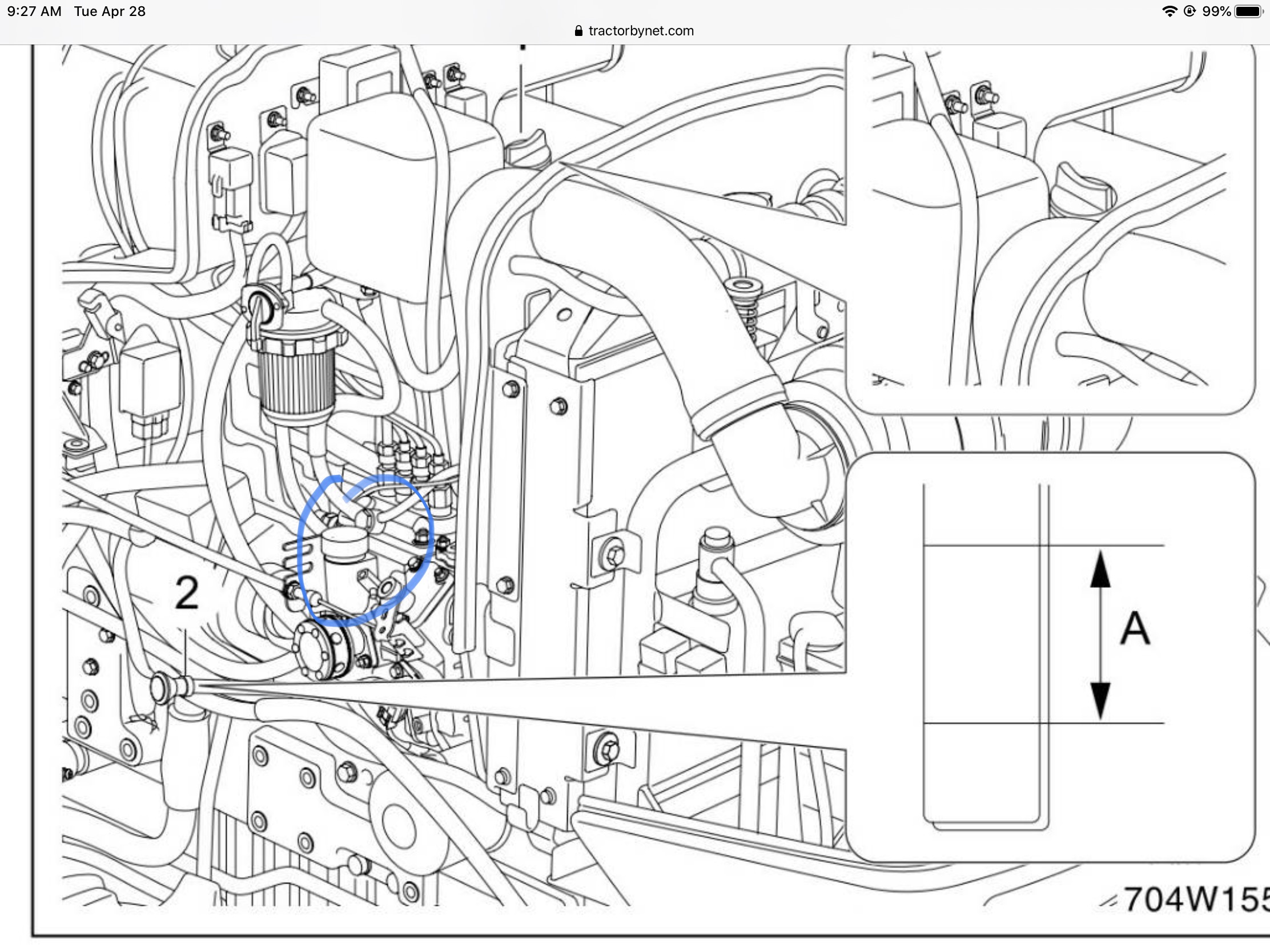

Kman, if you fill through the valve cover pour very slowly. It is possible to fill the valve cover faster than it drains down to the sump. The oil can travel through the breather hose to the intake and fill up any cylinder that has its intake valve open.
There is another oil fill at the orange cap near the injector pump. Blue circle in pic.

Good catch! Yes, if there is a side oil fill, by all means use that one.

That is exactly what I had read about oil traveling though the breather hole.

Amvcane: Good catch indeed.
My CK4010 has the upper oil inlet on the valve cover permanently secured now and capped by the factory, and my proper oil inlet is now plainly marked on the inlet nearest the dip stick. So that service manual picture is marked wrong for the newer tractors.

My book does not show the top option it shows the side only - I believe the top is sealed....

On my Kubota M6040 there is only the low fill port as AMvCane has shown.
Be safe - fill thru this lower port.
I have a metal funnel with extended flex nozzle. Temporarily wire it up to an arm on the FEL. 12 quarts - simple as pie.

Bring you up to date. I had the dealer come service my tractor and he showed me the spot to fill the oil in by the dipstick with a big orange cap lol. Now I know for sure where to put the oil next time I will do it myself.
