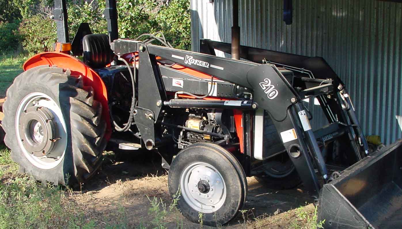

I have a MF231S that I bought with 222hrs. The problem I have is that I can't find any information in the owners maintenance manual where the previous owner had the 50 hr service performed.(I bought the tractor from a dealer who didn't have contact with the prior owner). So, do I go through the Tractor as if the 50hr service wasn't performed or what should I do? At the very least I am going to change the oil and filter(15W40 Rotella). My main concern is the tranny and hydraulics. Any suggestions?

Oh BTW nice looking tractor /forums/images/graemlins/wink.gif
