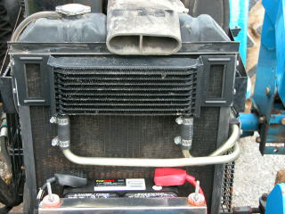

OK, got it in! WooooHHhooooo looks like it will fit fine on my 1925, now just have to order the other side one.
What they did was remake the steel fixed lines and put the bend at the end into the steel line instead of having the hose make the bend. The rubber lines are just a little straight piece of 5/8" hose.
I am not sure where they intend the convulted tubing to go, but thought I may sort that out when I get mounting it.
Looks to me like it will definetely fix the problem that I have with these cooler hoses.
And I just realized I can order direct from Messik and they are a dealer / supporter here. Here comes my order!

OK, the before, with the attempt with the 5/8" pushlock hose. Just did not work out as desired.

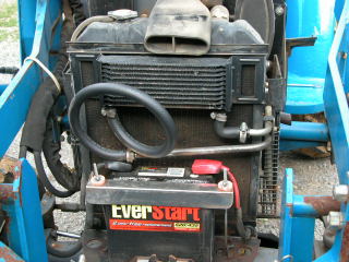

And this would be the after.
I am very satisfied that this is the way to go, would not be a question in my mind to do it over again. Wish I had done this right at first and not tried to "save" money.
As a side note, there is a spring and check ball to keep the cooler from overpressurizing that sits on top of the hydro filter. When you change out that line, it comes out (or you can pull it with a magnet) I never knew it was there, but ended up reading it in the manual when the spring showed up, and I was going /forums/images/graemlins/confused.gif anyway, my thought is that I am going to order a new spring, just to insure that it is working as well as it can.
I am VERY happy with this repair, and believe it should eliminate that problems that I experienced in the past, but I guess only time will really tell.
Oh, and I put the convoluted tubing over the lower line, it looks like the battery cables will want to rub there, so it was a logical place to me. I did not see any other potential clearance problems. I will keep an eye on it and make sure that something does not crop up though.
