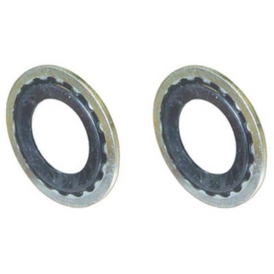

Can someone tell me what size threads the motor oil drain plugs are on L3x30 tractors?
I want to pick up a couple of seal washers prior to the next oil change. I am probably going to switch from what looks like copper washers to ones with rubber o-rings built in. Currently there is a slow drip from one of them and retorquing didn't stop it.
FYI I looked up the parts on several websites and none of them gave the thread sizes.

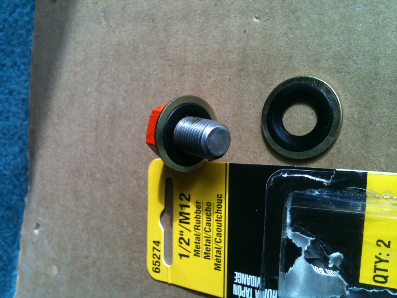

In case it helps anyone else the threads for the engine oil drain plugs is M12x1.25
   / Oil drain plug size?
Washer: Oil-Tite 65724
Cost: $3.99 form AutoZone for package of 2
