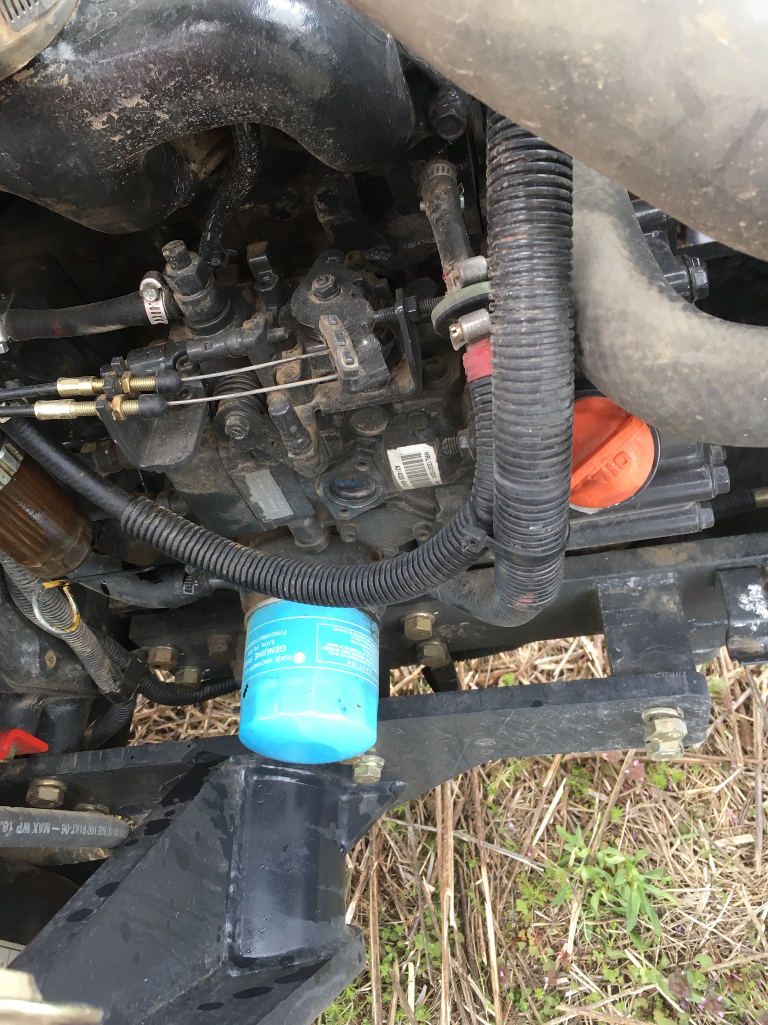

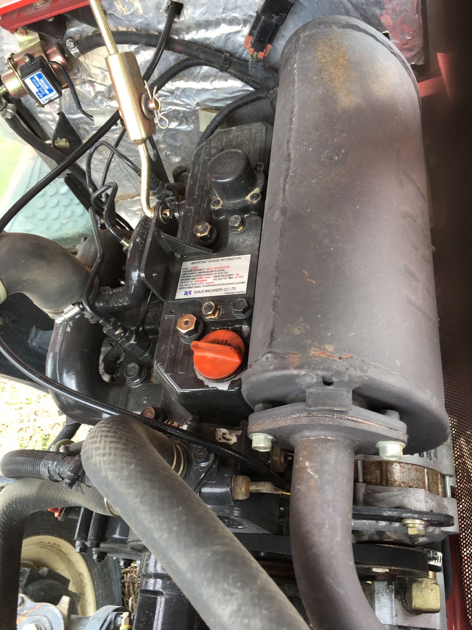

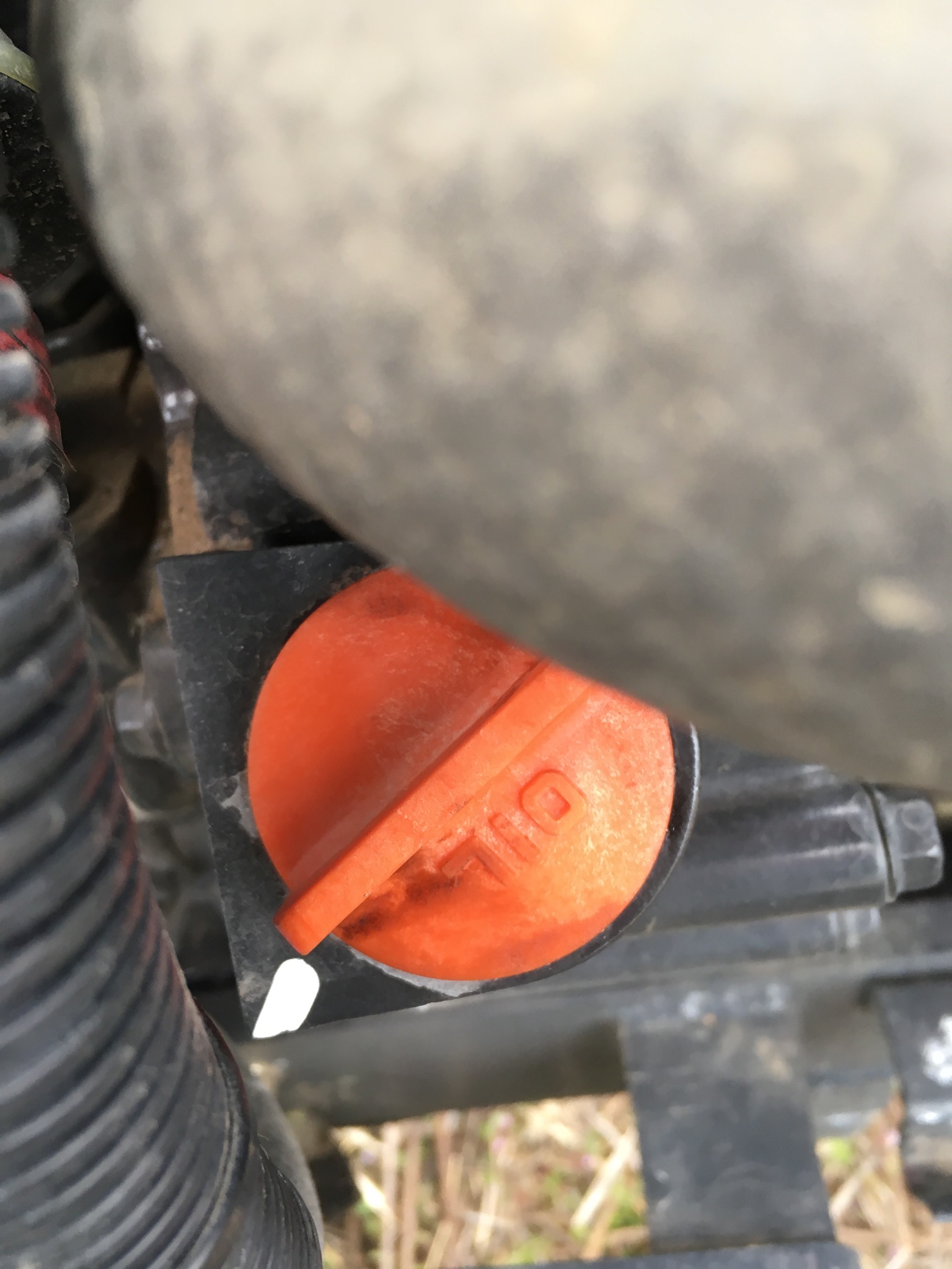

I bought a 2910i and am going to do an oil change and don稚 have books yet. . I found the dipstick, full, but very black. I think I should be able to locate the drain, I didn稚 look though. My confusion comes in that it appears I have 2 oil fill locations 1 on the top of the motor and one on the right side of the motor forward of the dipstick. Both say oil on them. Which should I use or does it matter? Are they both truly oil?

Yes any one will work ,They have two on some engines for different engine applications
   / Oil fill confusion #3
It's an engine thing, nothing to do with tractors. Drain plug is on the bottom just like your car\truck and the fill is on top. Kinda silly to add a 2nd fill. Use the one that's easiest to use. It's black because it's a diesel.

Thanks guys. That was my thought but wanted to confirm it.

Same for all 3 JD (Yanmar) engines. The bottom one on the JDs is harder to get oil into it without the oil leaking around the lower end of the funnel, either at the end of the funnel or the top of it because of the tip involved to use it. You can get a straighter shot using the top one.

I used the lower one on the front of the engine. The DPF on my 3725 is larger than the muffer you have and makes access to the filler in the valve cover more difficult.
Somewhere on this forum I read about someone who filled the engine from the valve cover and the oil didn't drain down into the crankcase before the engine was started, and it was damaged. I don't know if that was the real problem. I could see on some engines that the oil drain from the top end might not be very large, especially if the engine does not pump a lot of oil up there. Modern car/truck engines circulate a lot of oil and have good drainage from the top end so this shouldn't be a problem for them. In any case, checking the dipstick before starting would ensure that there's oil in the sump.
