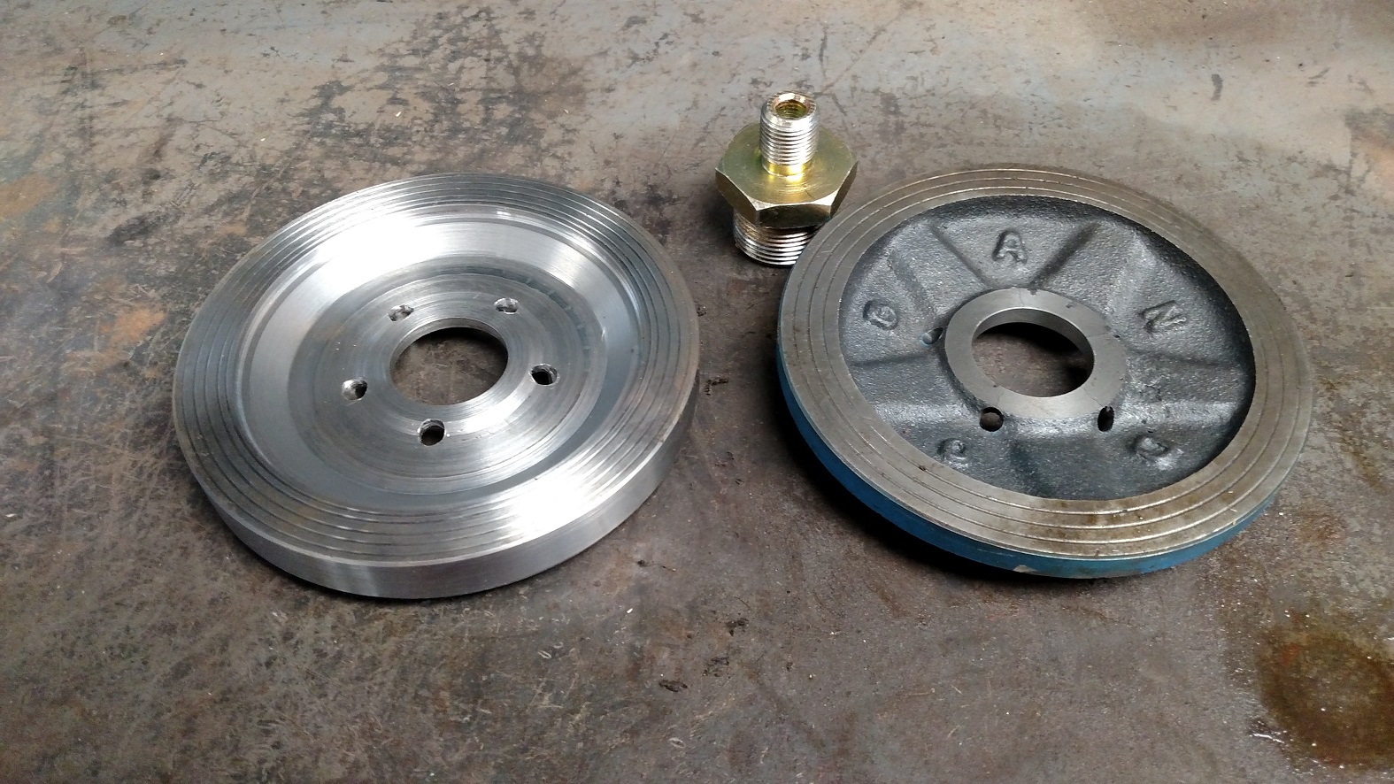

Feb 5, 2016 / Oil filter adapter. #1 LD1 Epic Contributor Joined Apr 30, 2008 Messages 22,537 Location Central Ohio Tractor Kubota MX5100 Bought one of the $40 ones and it cracked. No luck returning it and the thread I posted about that whole story got deleted. Anyway, I decided to make one from solid steel instead of the cast.

Feb 8, 2016 / Oil filter adapter. #4 The Fred Veteran Member Joined Jun 19, 2013 Messages 1,290 Location hOOterville Tractor Boost it and Lose! What's your goal, curious. Adding a filter? Thanks, Fred
Feb 8, 2016 / Oil filter adapter. Thread Starter #5 OP LD1 Epic Contributor Joined Apr 30, 2008 Messages 22,537 Location Central Ohio Tractor Kubota MX5100 Its an adapter to use a normal spin on filter instead of the cartridge type with the separate outer housing

Feb 8, 2016 / Oil filter adapter. #6 murphy1244 Super Star Member Joined Nov 25, 2011 Messages 16,326 Location Ohio Tractor Kubota 1120 RTV Kioti DK-40, MF-135, Ventrac 4500Y Nice job LD1. Did you do the machine work?
Feb 8, 2016 / Oil filter adapter. Thread Starter #7 OP LD1 Epic Contributor Joined Apr 30, 2008 Messages 22,537 Location Central Ohio Tractor Kubota MX5100 Yep. Forgot to post this....its what it started like.
Feb 8, 2016 / Oil filter adapter. #8 P pappy60 Member Joined Oct 3, 2013 Messages 49 Location Edinburg, VA Tractor JD 770 Nice job... How is it fastened down ???
Feb 8, 2016 / Oil filter adapter. Thread Starter #9 OP LD1 Epic Contributor Joined Apr 30, 2008 Messages 22,537 Location Central Ohio Tractor Kubota MX5100 The center threaded adapter. Threads into the existing block threads and accepts the spin on filter on the other end. The plate I made just directs the oil where it needs to go.
