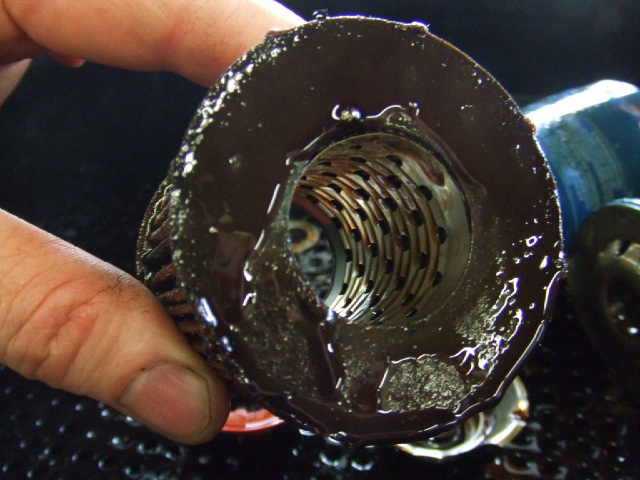

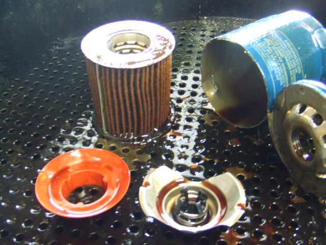

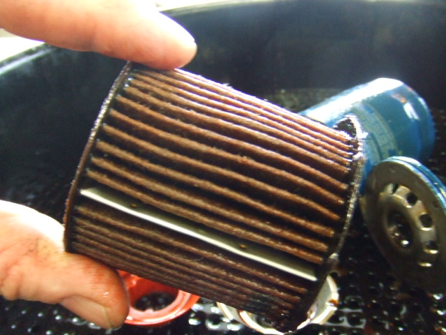

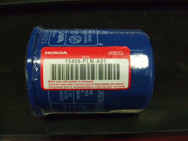

Honda cars uses a nice oil filter made by Filtech. It's a direct cross to 1365. Very nicely made filter costs me about 6 bux.
15400-PLM-A01 or A02 fits almost every Honda and Acura out there. Honda motor company can't be wrong, made in Amurica too! DSCF0557.JPGDSCF0560.JPGDSCF0559.JPGDSCF0558.JPG

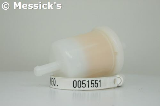

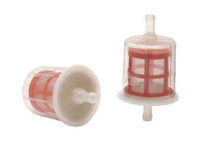

When I got my BX2230 back in 2005 I researched the filters and was shocked that most of these cross over filters were used in motorcycle applications and that a motorcycle enthusist had done reviews along with cutting the cans apart and unrolling the paper and it showed the small size of the elements then. Plus never ever use the WIX/NAPA fuel filter 33972 they spec for the application as it is only a 50 micron screen and not diesel filter paper.
