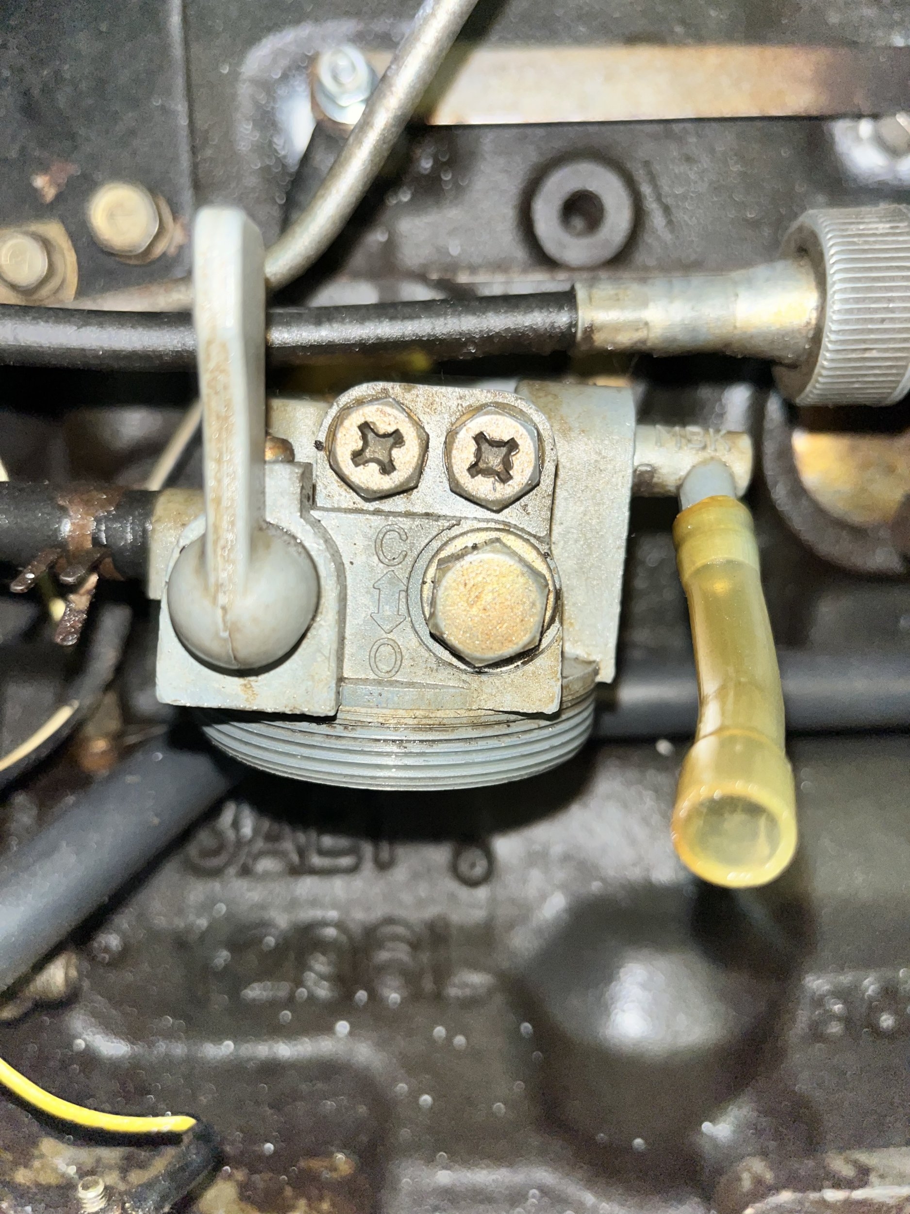

Just for information for other TL 2300 useres I share ho I selected & replaced other filters.

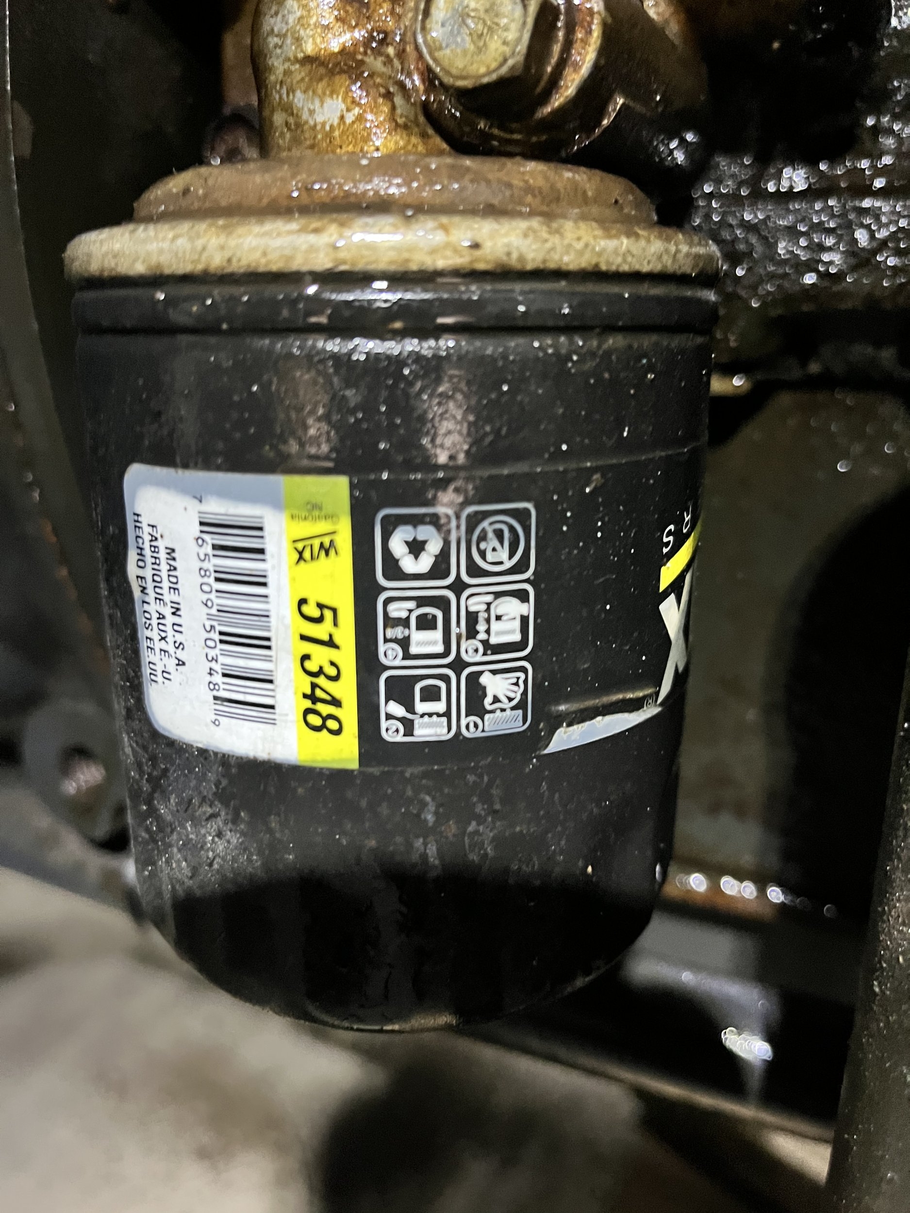

I have just changed engine oil filter filter and order the fuel, I hope it will fit.
ISEKI TL2300

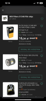

Engine oil: (Ford C-Max, Jeep Liberty)
WIX 51348 (price 4 Euro)
