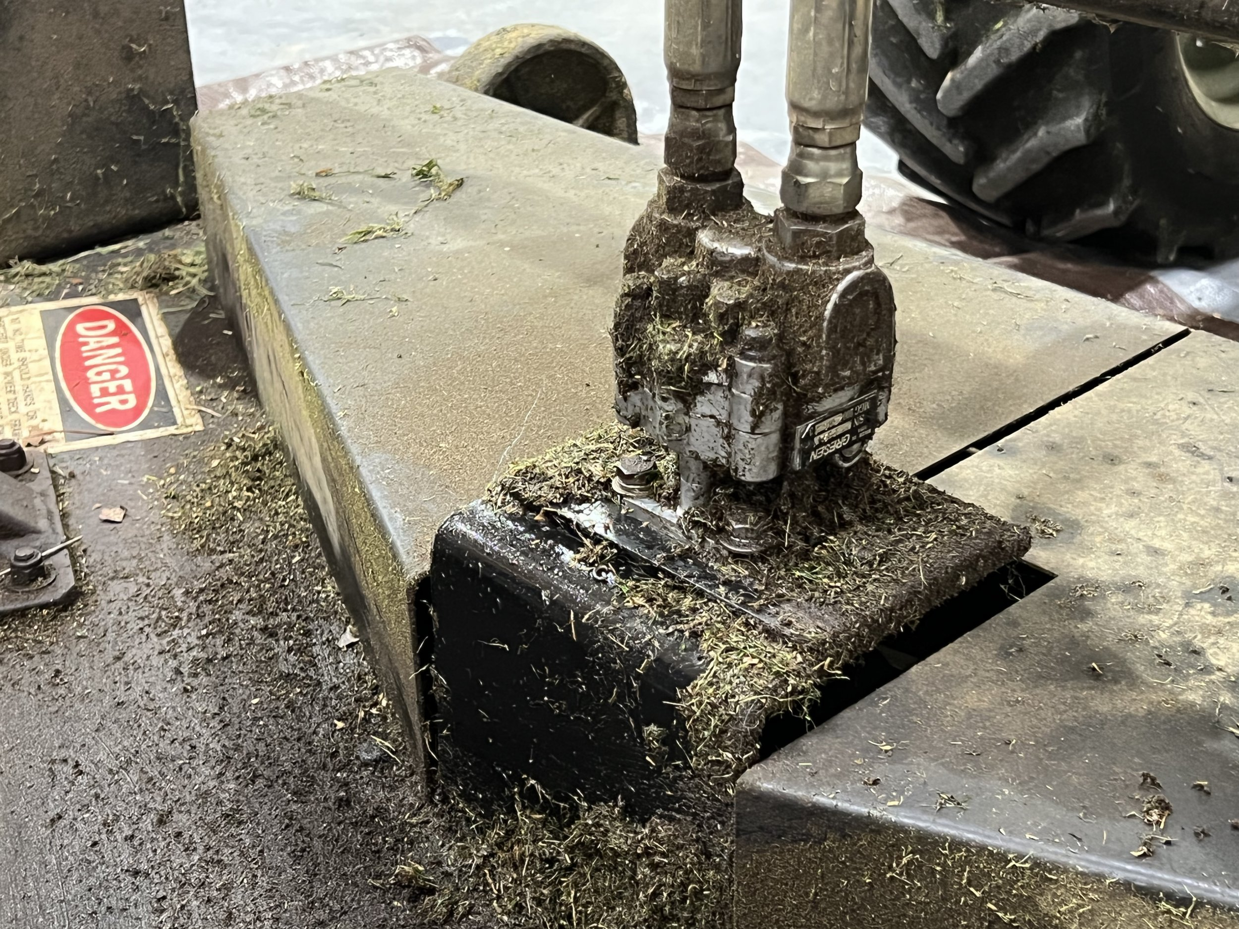

I still have less than 200 hrs on my PT425, but the finishing mower is one of my used attachments with unknown hours.
I normally use another smaller mower to save hours on the PT, but the grass was very tall from all the rain.
Anyway, there was a sizable oil leak at the deck’s hydraulic motor after the last mowing. It probably didn’t help that I let the mower stall briefly a couple of times in tall grass.
Question is how to fix? Does this typically mean a new motor is needed? I’m not very DIY so I may just buy a new motor and have someone put it on, unless it can economically be fixed or rebuilt.

Sorry to hear about your leak; can you share a photo of where it is leaking? Depending on where the leak is, it could be a loose hose or fitting, a break in the hose, or yes a motor problem.

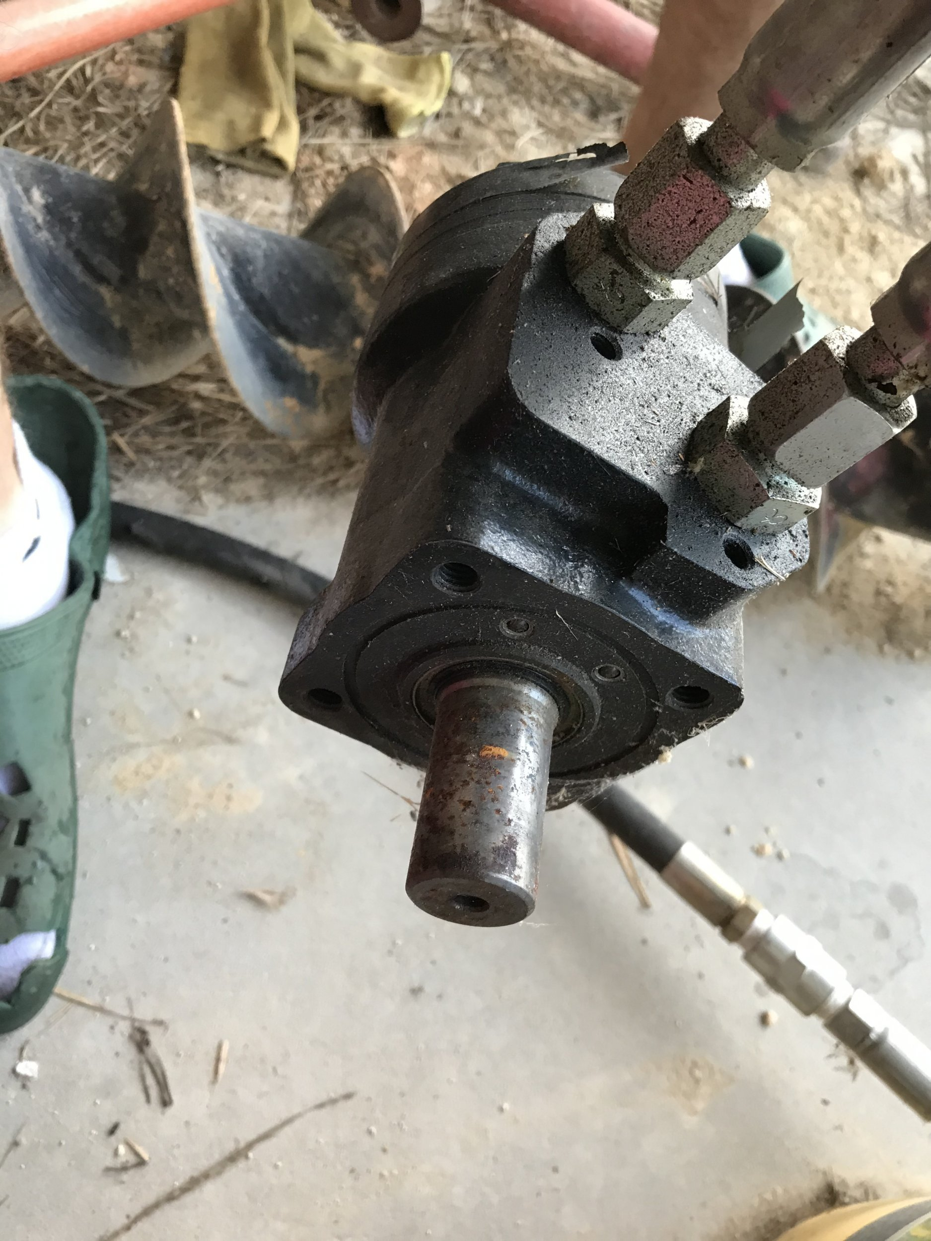

Send pictures of the motor. I have a couple of hydraulic motors that came with my 425. We might be able to work something out. I am not far from you. In Sweetwater. I have no idea if they would even be the right rpm's but we can start with pics.

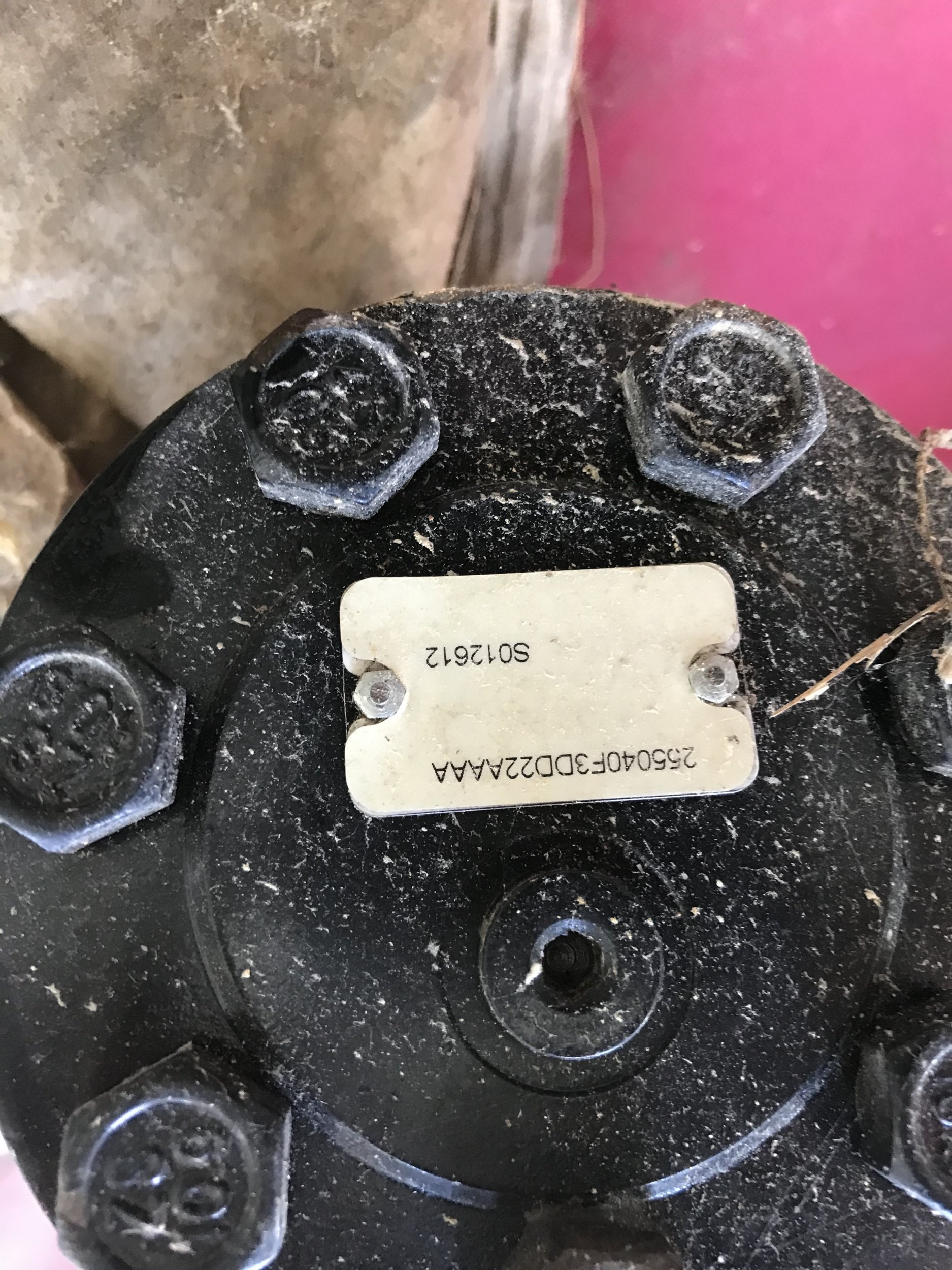

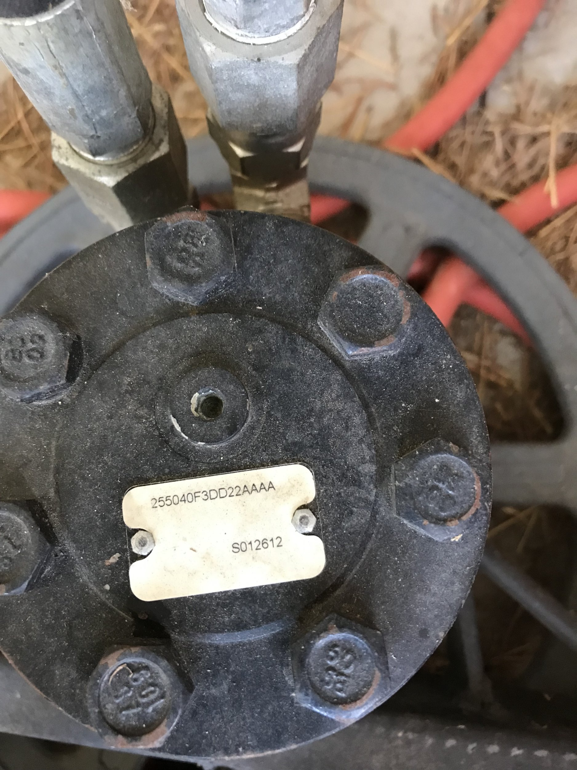

Here are the motors I have, they seem to be the same as each other.

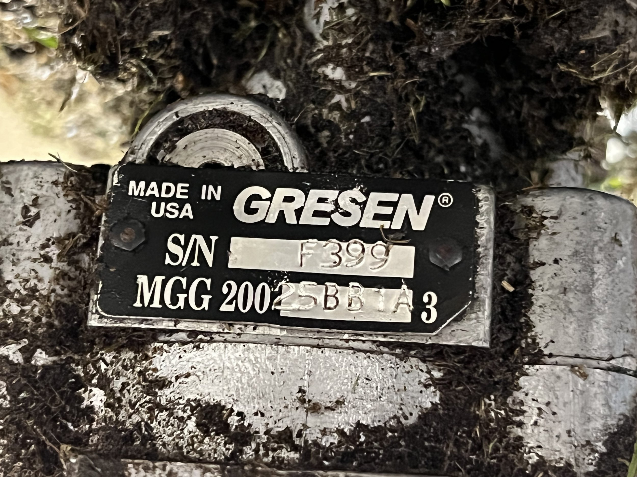

Here are some pictures of the motor and nameplate.
@Ink - unfortunately it doesn’t appear to be a match to your motors. Much smaller and higher rpm.
Doing some research on the part number, I think I found the replacement motor on eBay here for about $285. Still not 100% sure the problem is in the motor. Anyone know if these are throwaway or repairable?

Thanks for the photos. Not to be troublesome, but where exactly is it leaking from? The clean spot to the left of the tag?

Definitely looks like it is different. I haven't run these motors with the pto yet to see the rpm's. May have to do that soon. Good luck.

I’m not exactly sure where it’s leaking. Just noticed it when I finished mowing last and was ready to call it quits. I’ll investigate it some more.

Here are some specs I found using your part number. Appears to be 1100 - 1600 RPM. I guess that depends on psi and flow rate… not very familiar with hyd motors. It looks like my motor is up to 5000 rpm. Your motor looks closer to the one on my brush cutter.

Thanks for the information. As I said, these came with the tractor when I bought it. I have been thinking about making a hedge clipper out of a sickle mower. These motors just might be the ticket. Sorry it won't work out for you, as I have two of them. Good luck with yours. I hope it is an easy fix.
