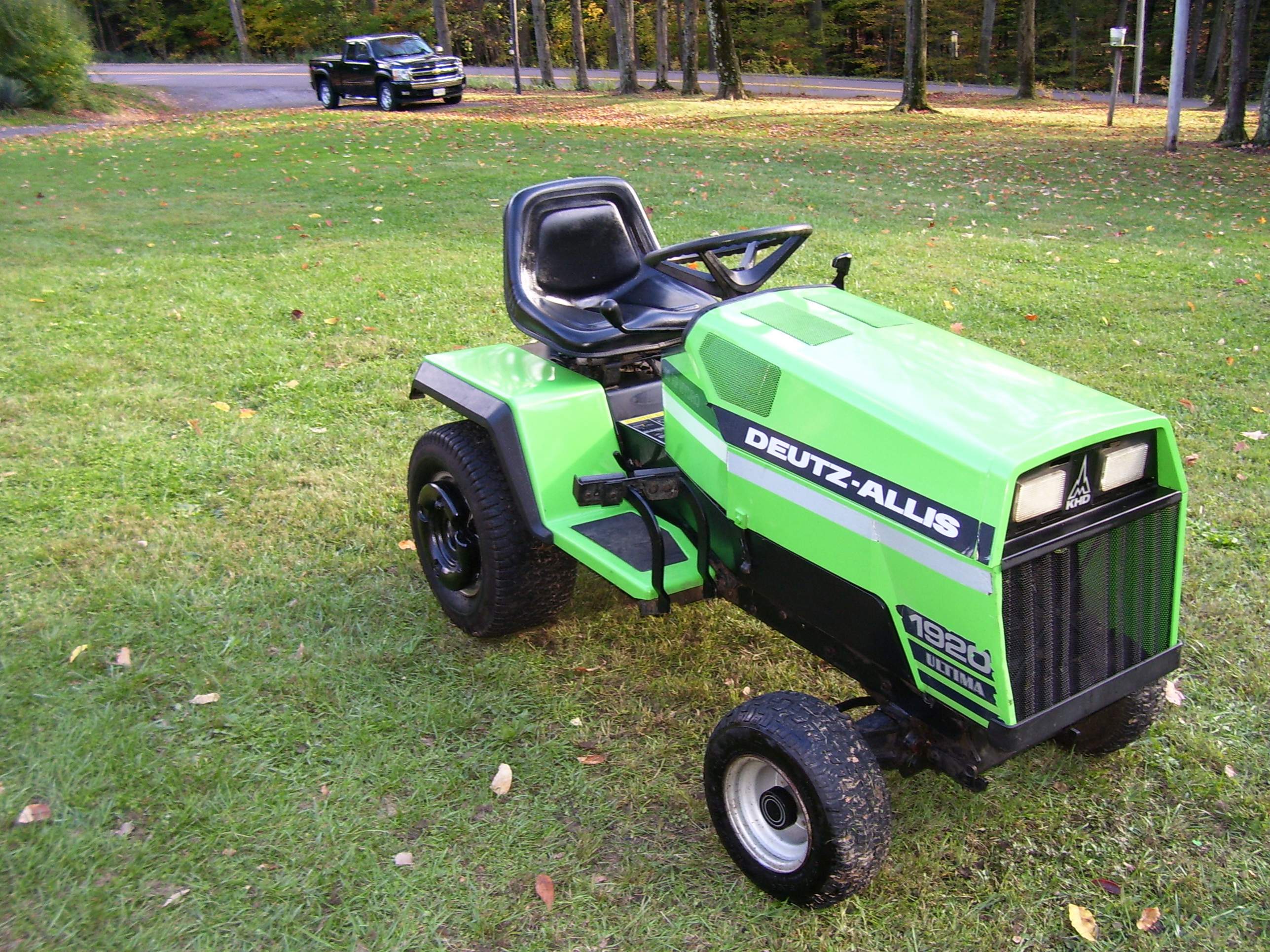

I have a deutz-allis ultima that has a bad oil leak that seems to be coming from the fly wheel area. When I pulled the fly wheel cover I found the fuel pump only being held in place by one screw about half way in and I was wondering if this would be the cause of the leak. Redmule

Best way to find out is replace the missing screw(s) and tighten them down, clean everything up and run the tractor.
Are you sure it was an oil leak?

Big time oil leak coming from the fuel pump. Replaced the lost screw and cleaned ever thing up and now there is no oil. Dale
