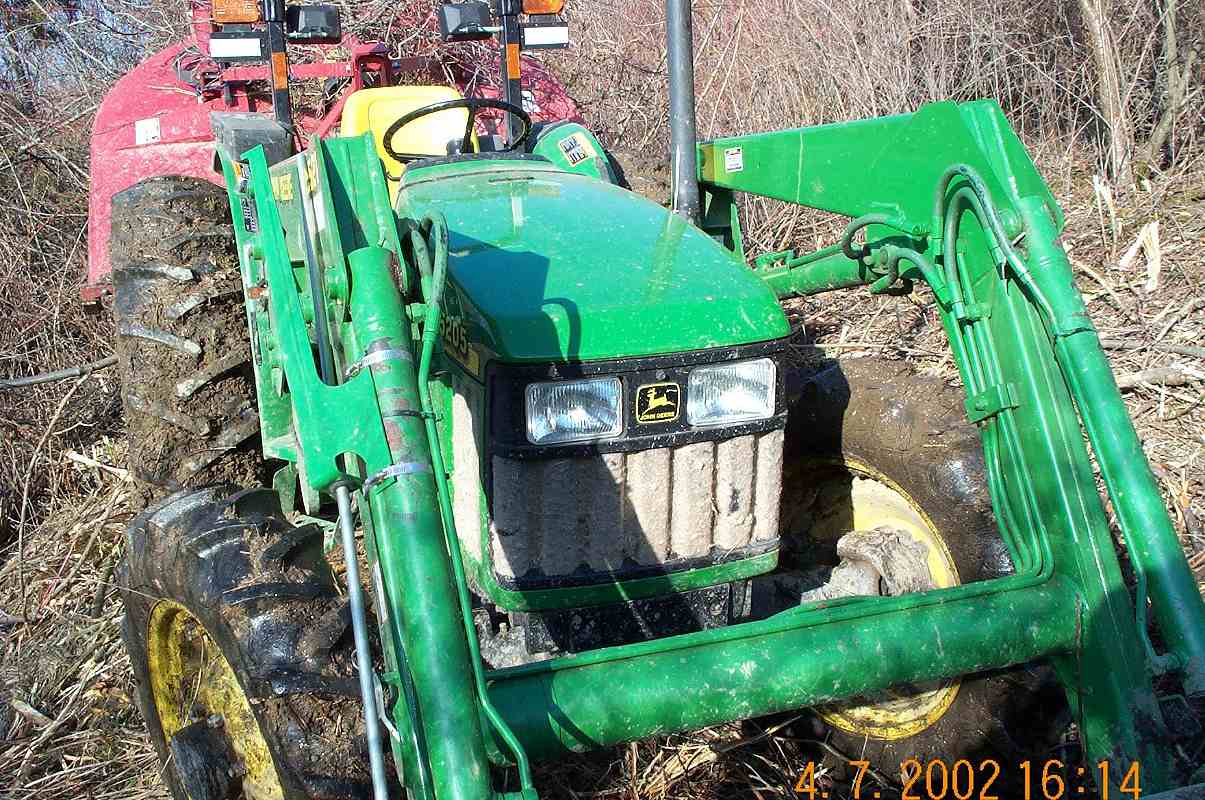

<font color=blue>...stopping every 20 minutes is getting old...</font color=blue>
Ahhh... depending on what you're brush cutting, the cleaning times will vary... but that's the nature of the beast... /w3tcompact/icons/smile.gif
I will stop about every 45 minutes and clean things up... I have a brush I carry mounted inside the engine compartment... so it's there all the time...
Don't wait until the "temp gauge" is going toward's red... get into a system of checking the grille area and clean it up... and soon it becomes second nature for ya...
<A target="_blank" HREF=http://www.tractorbynet.com/forumfiles/13-205594-GrilleCleaningTime-800.jpg>Here's after about 15 minutes of junk and "cattails"... so depending on what you are cutting at the time... times will vary...</A> /w3tcompact/icons/wink.gif
