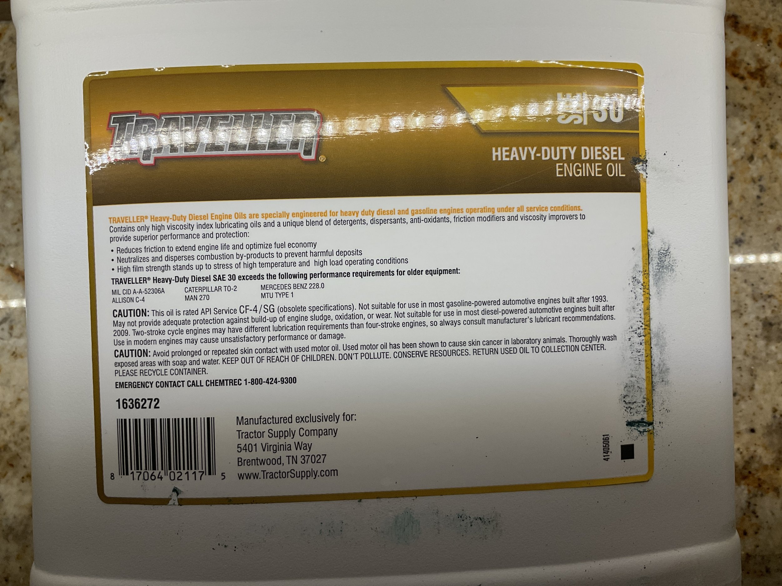

Hi all, need some help in determining if I used the right oil in my kioti CK25 hst. All I could find at TSC was
Traveller heavy duty diesel oil, manual calls for cc or cd, they were out of stock on most types!
Anyone have any knowledge that would put my mind at ease if I could leave said oil in engine? Thanks in advance! ☮️✌🏻 This is the oil I used!
   / Oil Question #2
Yep you’re good. Cc and cd are long obsolete, so as long as you’re using a C oil that is higher alphabetically you’re good. Although I would have used a multi grade like a 5w40….

thanks for the help bro!👍🏻🇺🇦☮️✌🏻
