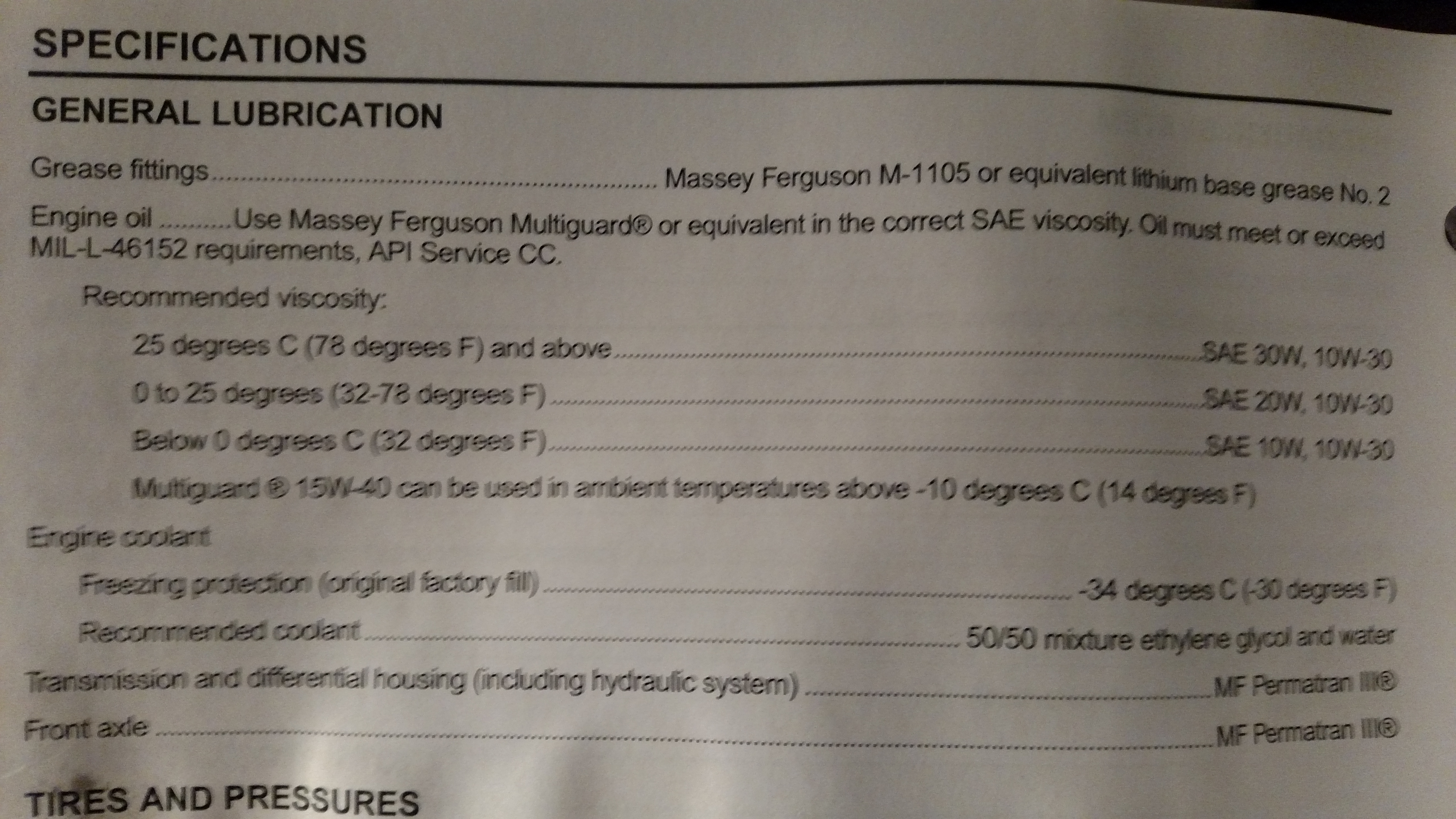

My Manual covers the GC2610 also and it ranges from 10w-30 on the low and 15w 40 on the high. I use Rotella T6 5w 40 in mine. I know a lot of guys do. I'll post a pic, of the page in my manual, from my phone if my snail mail gmail ever delivers the pic.
   / Oil Spec GC2610 #3
Here you go!

Friend of mine had a bunch of Amsoil 15w-40 synthetic blend that shows API CI-4+ I'm thinking of using since it was cheap (free). API CC is an old spec and from what I can gather CI-4+ is superior to CC and should work without a problem.

Amsoil is superior oil! That should work great. Though if you notice it starting hard in sub 0 you may switch to a 5w or put on a heater pad.
