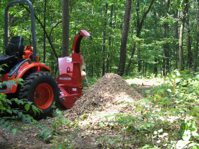

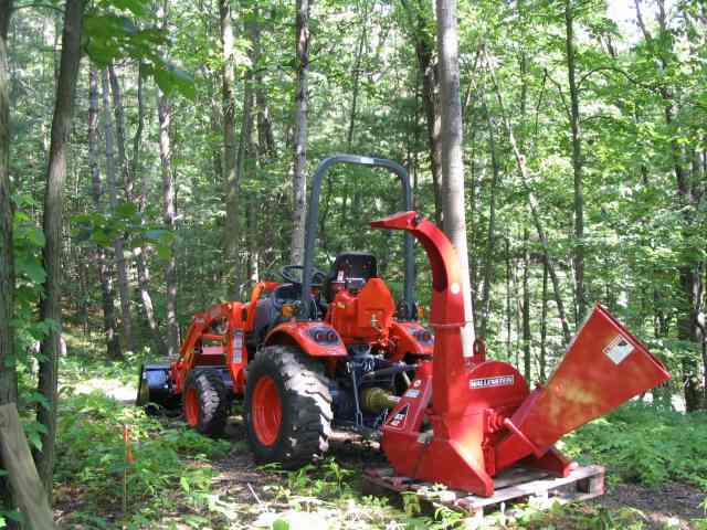

People have had good luck with the Dr Chipper on machines with less hp than yours has. I have also heard good things about the Wallenstein BX42 chipper on tractors your size, and smaller. I have used one on a BX, and it worked fine. Here is one on a Ck20 Kioti:
   / OK, a dumb question to some, but...
Thanks, Chuck. Very helpful and encouraging.

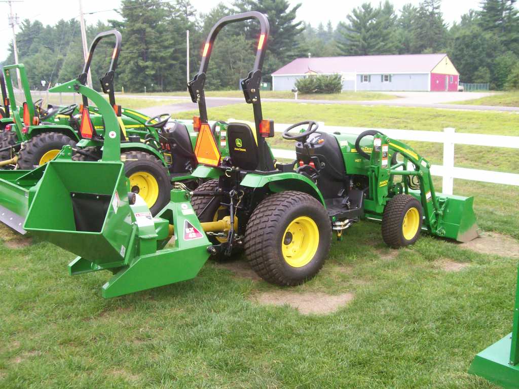

You are welcome! I would look at what hp gas engines the manufacturers are offering before becoming too concerned about the power of your diesel. I think the biggest gas engine DR offers is 18 hp.... gas. Your diesel will have much more torque than that! The Wallenstein is offered with a 13hp gas engine too.... Have fun, and be safe. Here is a Wallenstein on a tractor like yours:
