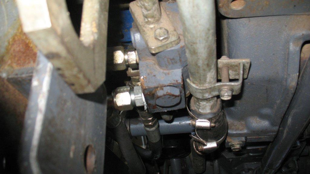

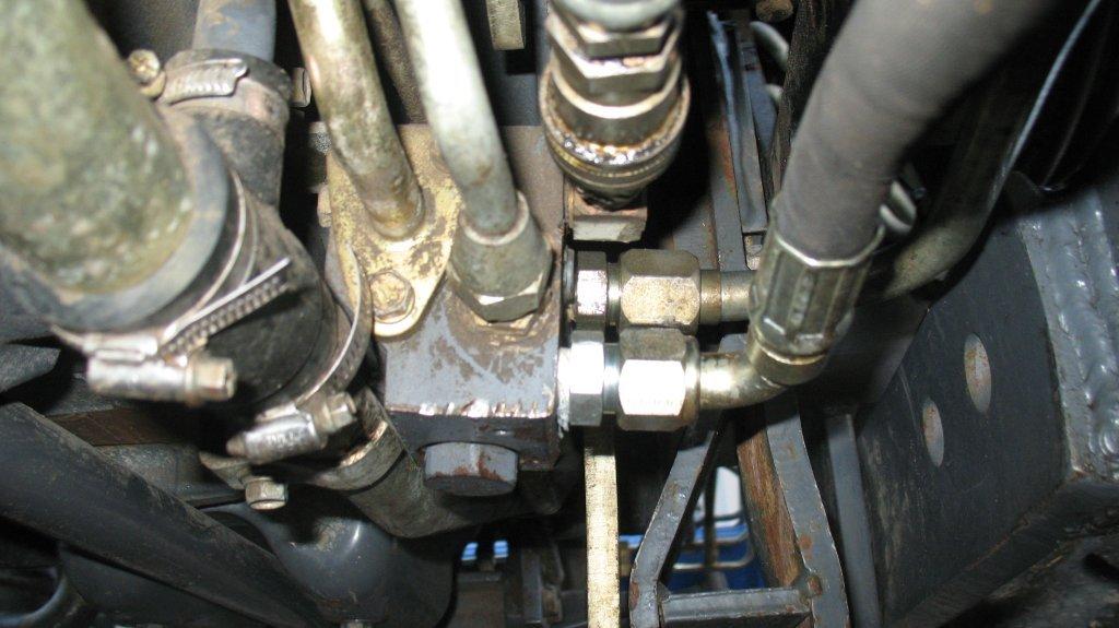

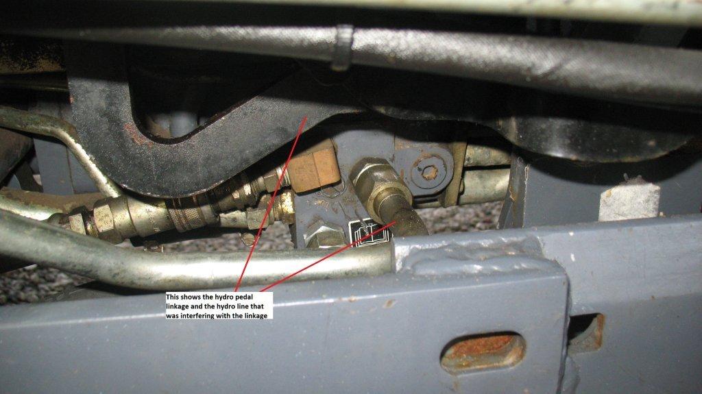

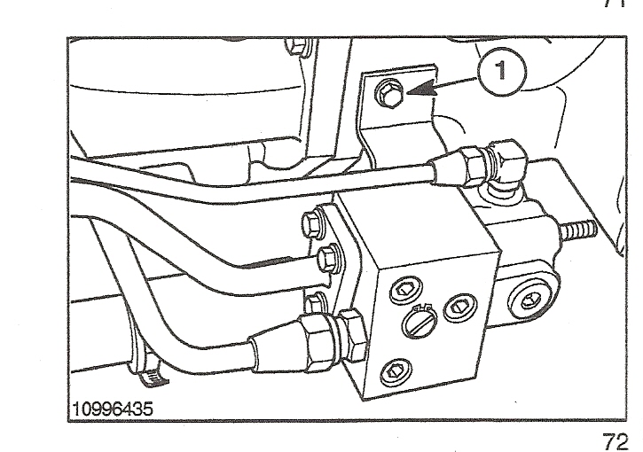

Actually came out pretty good considering how far up the lines were pushed. The block is held in place by a bracket. I've attached the drawing out of the manual, bolt (1) secures the bracket. That bracket was bent up and somewhat twisted. Pic second from right shows the offending line and the pedal linkage that travels in a downward arc as the pedal is depressed. Before I repositioned the block that line was about an inch away from the linkage. The diagram from the manual does not show the joystick lines but the plug ports are there to see, the lines connect to those ports. Prior to repositioning the block the larger diameter hydraulic supply line was out of alignment with the rubber tube section stretched and angled. After repositioning that line is in pretty good alignment once again. If my hoses (lines) look different than others it's because I have a Backhoe line kit on that replaced the power beyond steel line with the QD rubber hose. Anyway here are the finished pics.

Well, it looks pretty normal to me, especially with the backhoe quick connect and flexible hoses. That front fitting on the diverter valve (from the pump) was the one that recently gave me fits. Yours seem good, sealed, and tight. Did you have trouble keeping your sub-frame bolted up? I've never seen one welded. My bolts came loose once and I had to tighten them, but I was surprised to see yours is welded. Maybe your dealer did that as a way to guarantee the subframe stays in place with a backhoe attached.

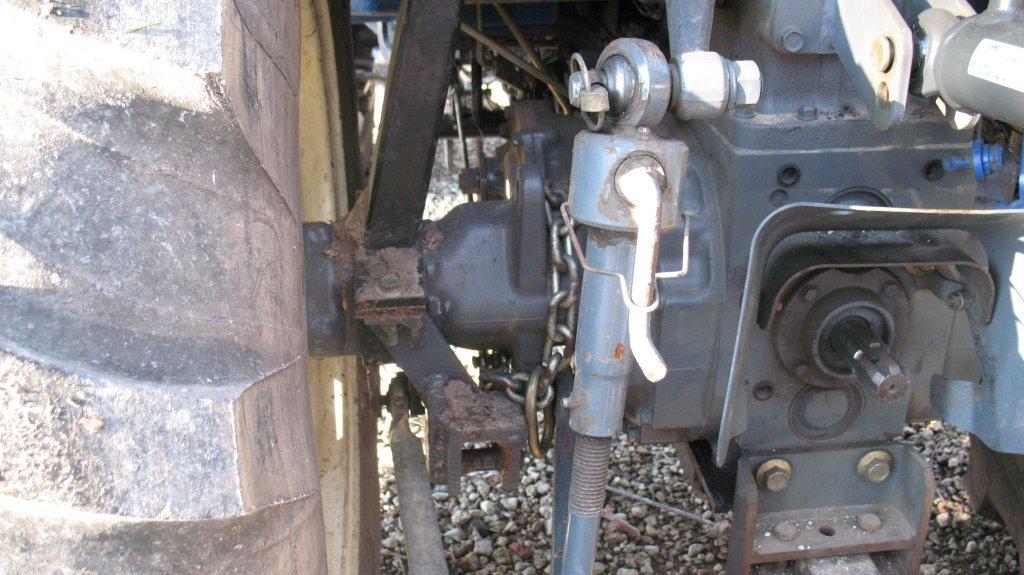

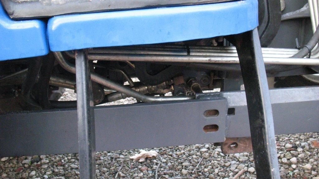

Good eye Jim, I was wondering who might call me on the subframe. I made that extension on the subframe from some bar stock I had laying around. The purpose was to move the frame reward and at the back end I welded up a pin housing that connects to the ROPS frame. My backhoe uses the 3 pt lift arm pins for support as well as it's own subframe (not pictured). I wasn't comfortable with my rear axle housing carrying the load that the backhoe puts on it so those auxiliary pins I made are now used. The backhoe is a tad lower now because I didn't want any interference of the 3 pt arms and also the sway stabilizer bars. Every thing works well and there is clearance for all movements but it's tight. I just feel better about the setup now. Here are the pics :)
