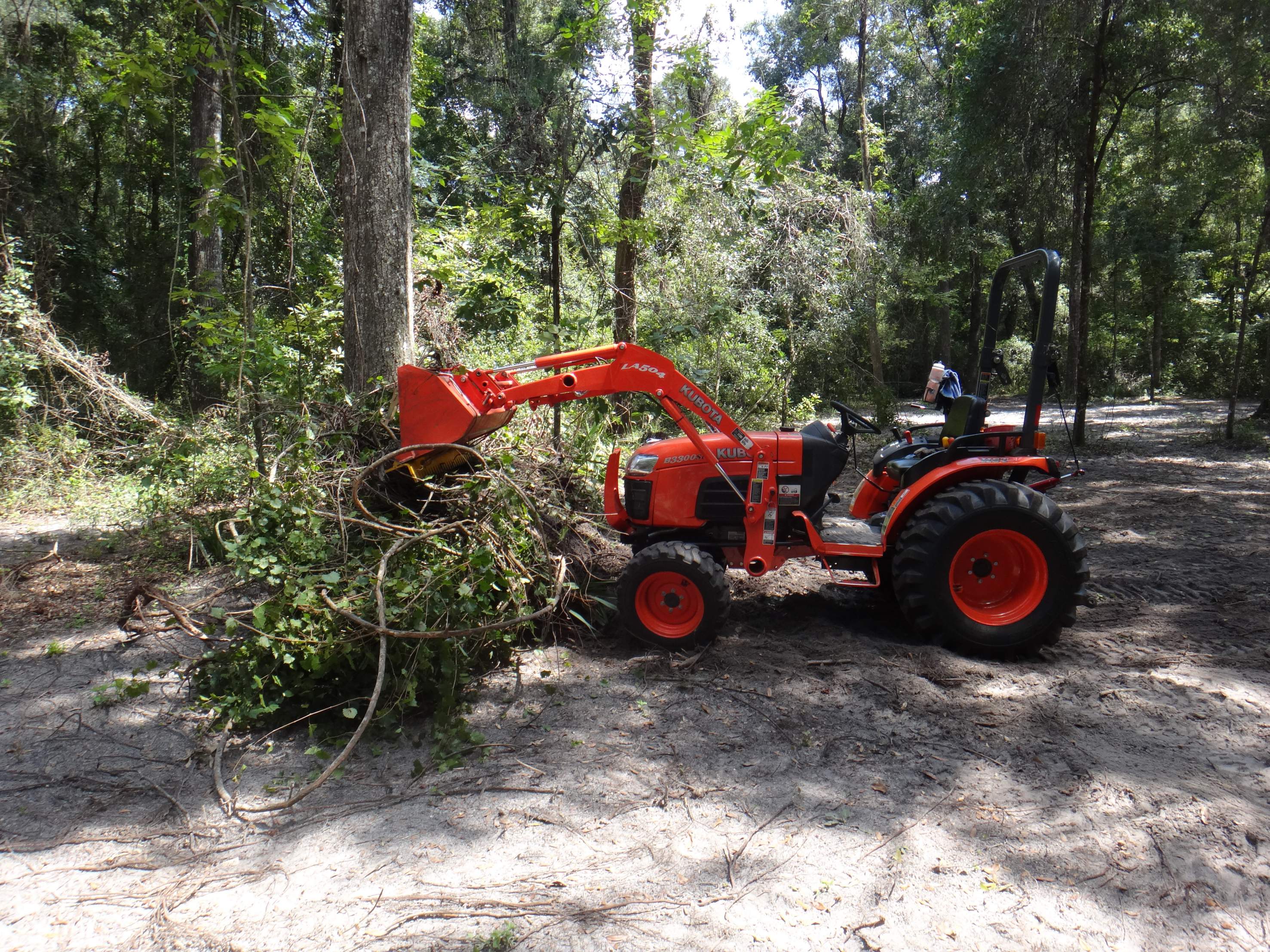

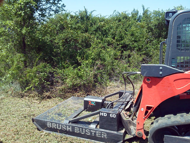

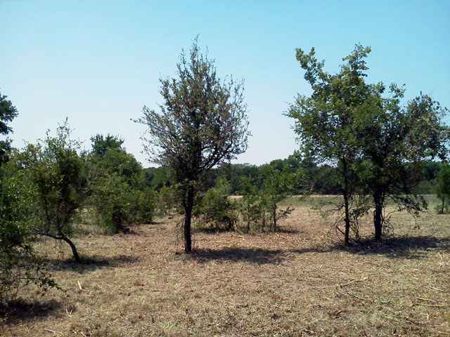

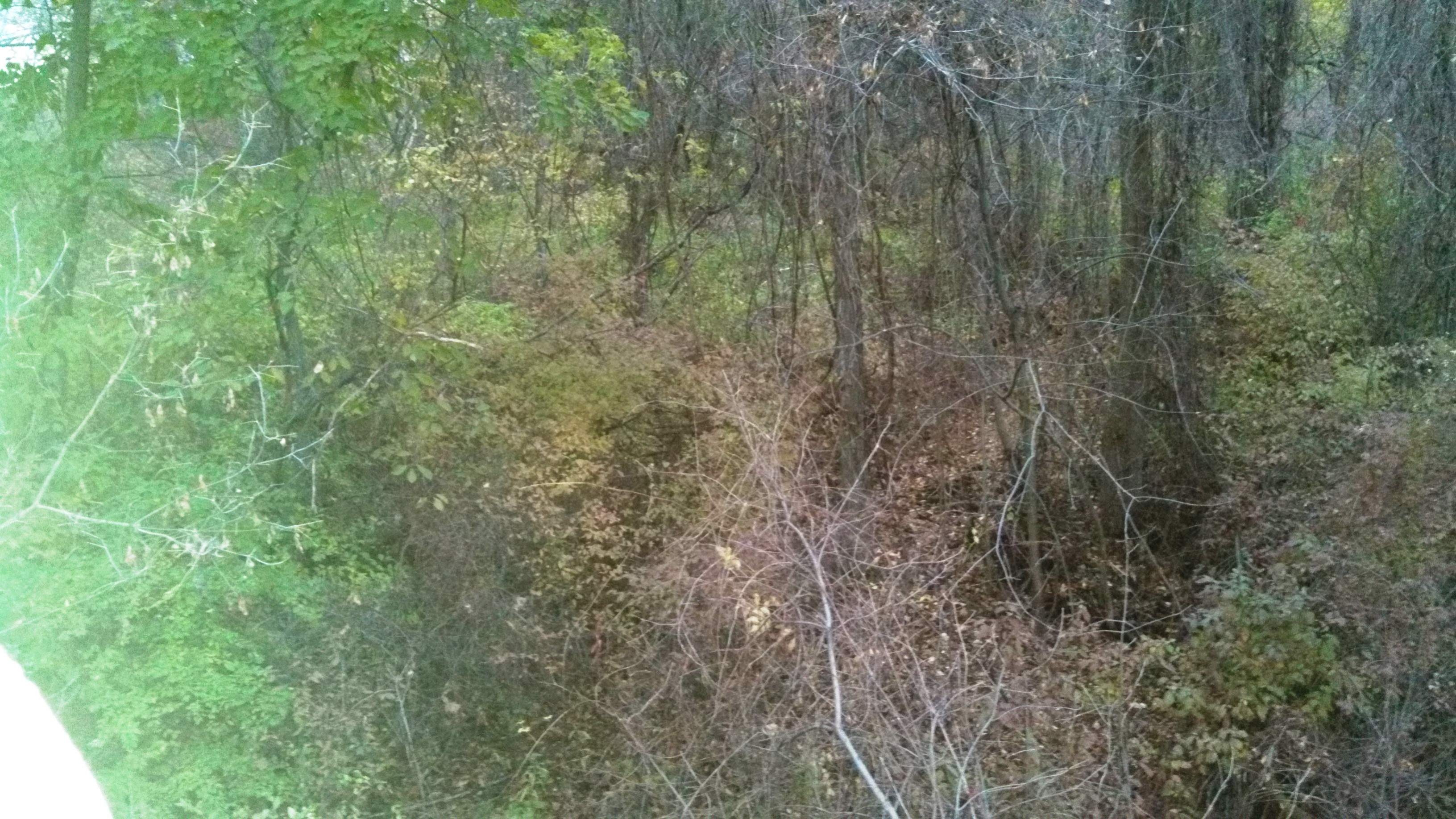

I have a small area about 1/2 acre that is mainly small shrubs, small trees and vines. I want to clear it out (leaving the larger trees) and level it out. I want to use the area as a little camp site since it will be right next to our pond.
I have a Ford 1900 tractor with FEL and a 5' Bush Hog
What would you suggest i use to clear this out with? Should I rent something to do it? Or would the tractor do the job and if so what attachments or anything would i need?
   / Okay need a little info and help clearing a small area. #2

Its a Bush hog squealer, not sure how heavy duty that is. I am more worried about fence and old metal stakes, (this is part of an old railroad bed)

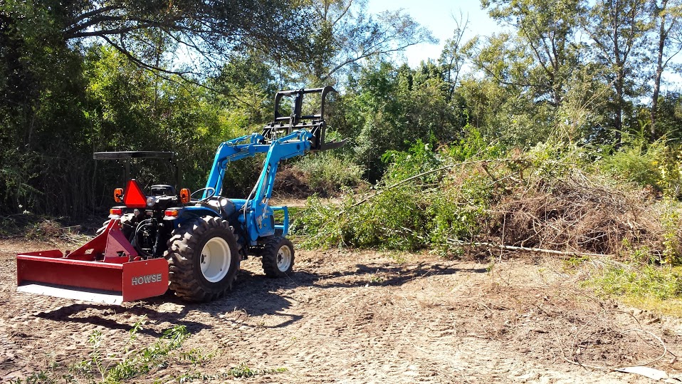

You could use a ratchet rake and then brush hog the area, or rent a CTL with a hydraulic brush hog (shredder). A hydraulic shredder will easily cut up to 3" material and make short work of the job.

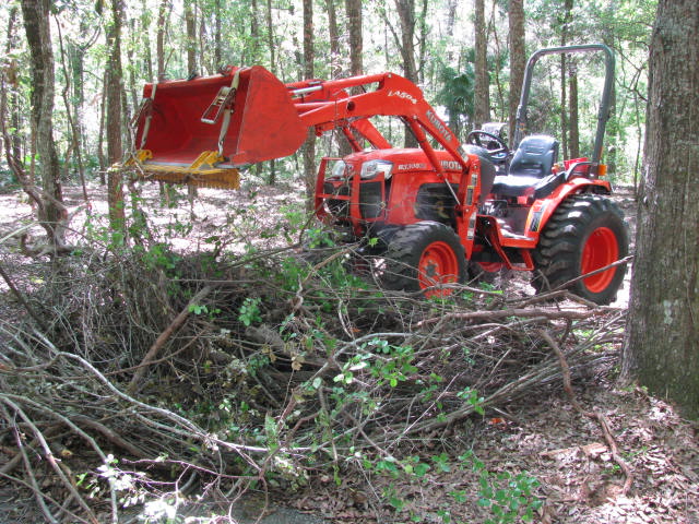

I'm clearing this 1 acre overgrown pasture with a ratchet rake, and grapple. The ratchet rake is one of the most useful attachments, especially for the money.
