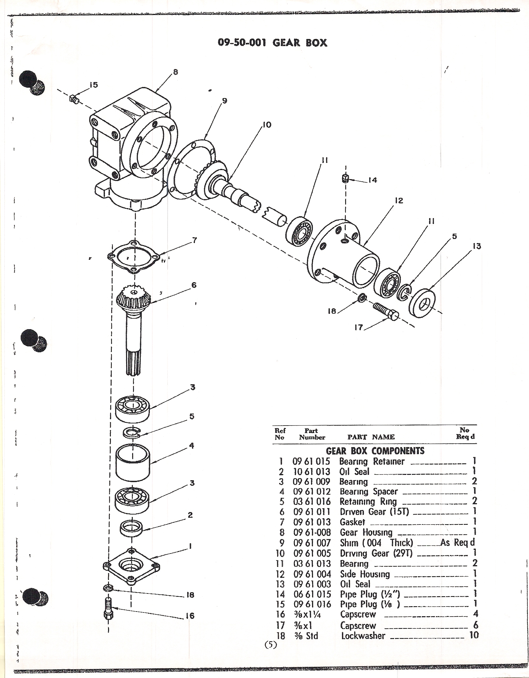

View attachment 308014Can you post a photo of the cutter and I will help ID the thing? I am looking for a gearbox for my Lilliston Flyin' Scot mower. It is about 50 years old or more and I am having a similar problem finding the exact replacement part. Post on this forum or drop me an email. I am new to this site (just signed up), so, I do not know the exact protocol for posting images. Good luck and post an image.
The drawing you posted is it from manual you could PDF and email. Any idea where I can order parts? I need spacer item 4. From diagram
   / Old Cutter with Warner Gearbox #7
The .pdf file page was from the gearbox owner's manual (Lilliston Implement Co., model - Flyin' Scot . I am really not sure how to attach the entire manual to this post, but, I'll give it a try. Some parts were previously available from Lacal Equipment, Inc. Lacal Equipment Replacement PartsLacal Equipment Street Sweeper Parts - Mower Parts - Snow Plow Parts.
did you ever find a warner box parts list I have one that looks close to the pic you have the bearing are a little differant but the box looks the same thanks for any help you can give.mine marked n 80 on mower tag gear box is marked h6 17 on bottom 3 b stamped on side
   / Old Cutter with Warner Gearbox #9
I still have not found a gearbox or source of parts for mine. Been through a few tractor and implement yards in north Florida and south Georgia looking. Most of the Warner Auburn gearboxes have the model stamped in the cast iron housing, either on the side or the back. I'll keep looking and let you know if I find anything that looks like it will work for you.
