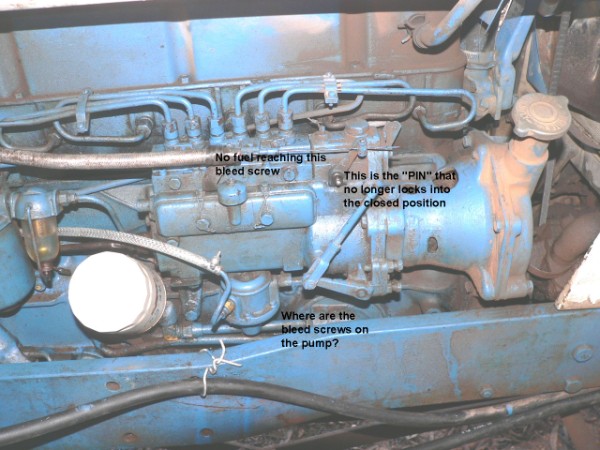

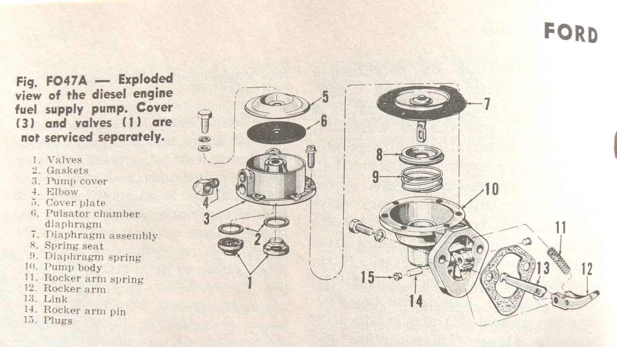

I know this is an old post but I'm having a similar problem with my Ford 6000 Diesel after replacing the fuel delivery hose.
I installed a remote starter switch to allow the engine to be cranked from the pump side (can''t reach the starter in the cab) and have managed to get some air out of the system - mainly at the number 6 injector BUT no fuel is coming out of the main bleed screw and the separator bowl is only half full so there must be an air-lock somewhere - probably in the pump. The attached picture is an exploded view of the pump on this model but I can't see any bleed screws.
Also, there is a "push-in" pin above the govenor arm and in the past, the engine would not fire unless this device was pushed in and locked. Now the pin will not lock in. Please see picture
Any ideas welcome - also does anyone know where a pump seal/diaphragm kit could be obtained please

Not sure if it helps but the bleeder on my pump just looked like a regular 1/2 inch nut. I overlooked it until my neighbor pointed it out. Good luck.

My bet is that it is the "bolthead" that is just to the right of the fuel lines on top of the pump. that is what it looks like on my 1710.

If your separator bowl is only half full, you may have some debris in the tank. This is pretty common, especially on older machines. I knew a fellow who was having a similar problem, and he had a hickory nut that had fallen into the tank unnoticed. It remained in the tank until it became saturated with fuel and sank to the bottom. Every so often it would find its way over the outlet and stop the fuel flow.
