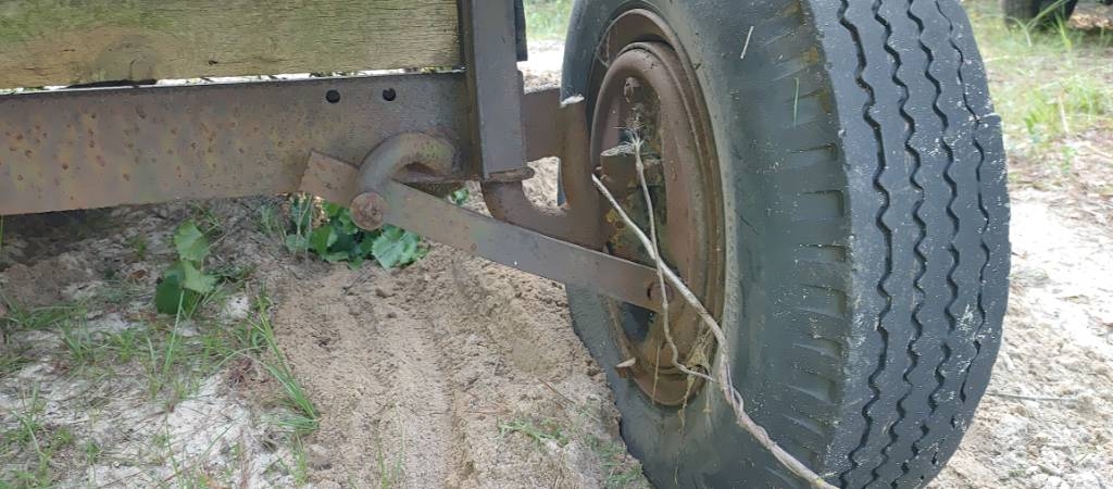

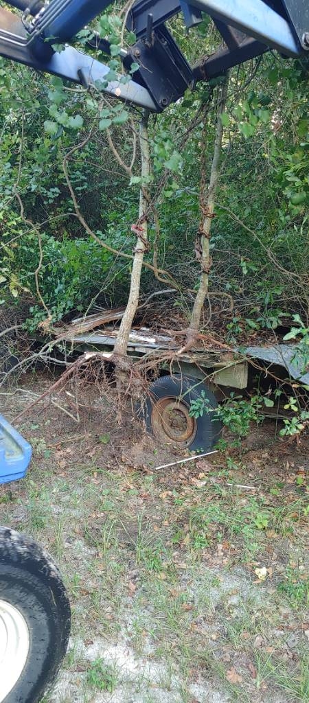

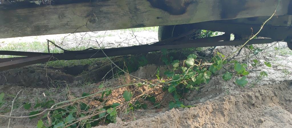

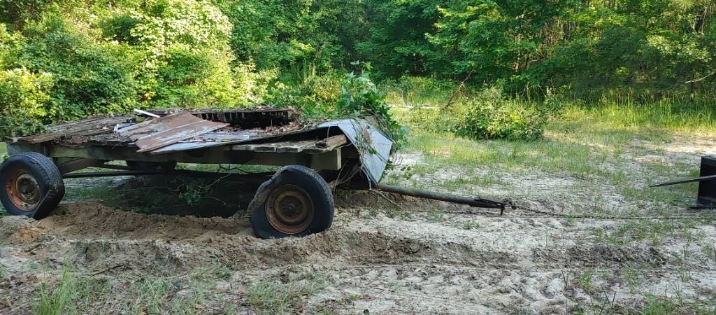

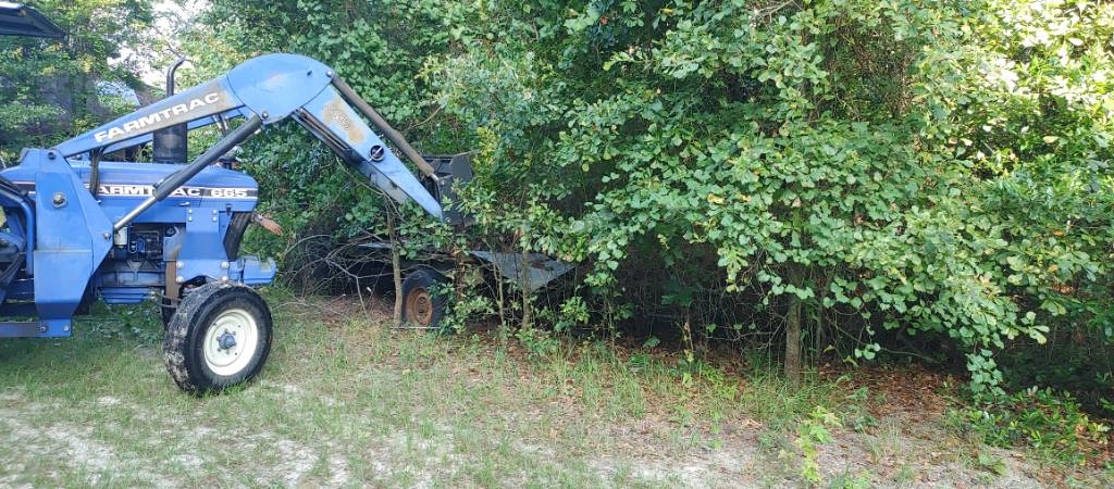

This was my dads, dads old wagon. My grandpa passed away in 1994. Me and my dad dug it out of a bunch of overgrowth today. I want to rebuild it. I have 3 daughters who take after their dear old dad, and love tractor rides, so I'm sure they'll love riding on a hay wagon pulled by a tractor.

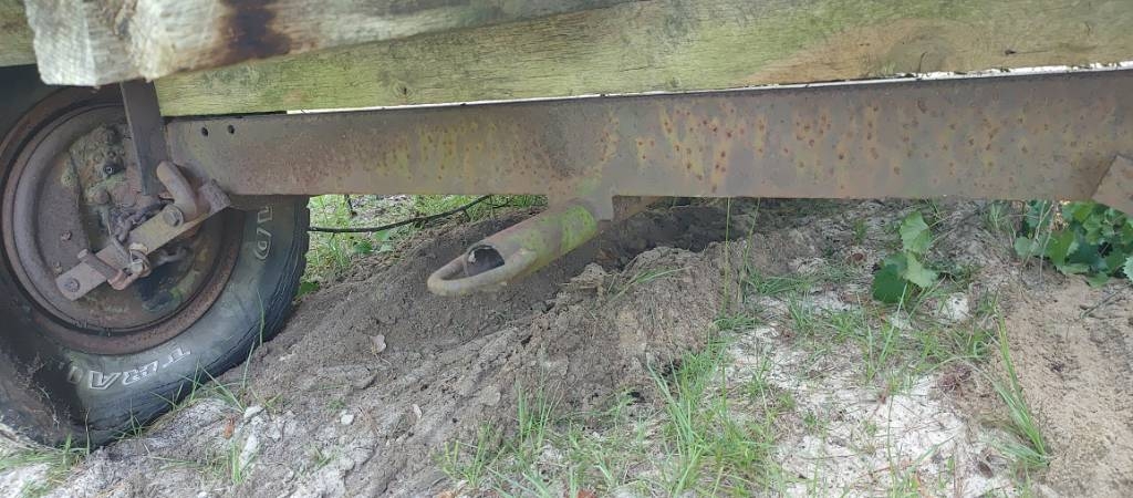

This thing has drum brakes on all 4 corners. Trying to figure out if this thing is a certain brand, or if it was something my grandpa had pieced together. I know that the front steering setup is slapped together with a bunch of metal and welds, and the round tubing is broken, and held in place by a piece of angle iron that's welded to it.

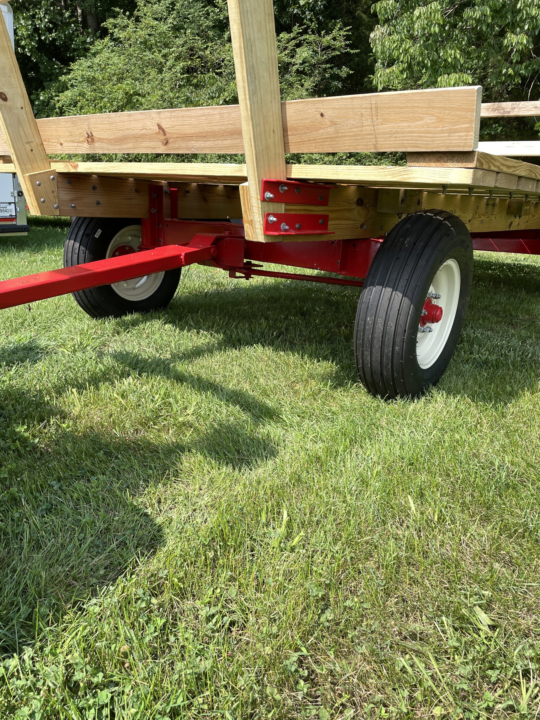

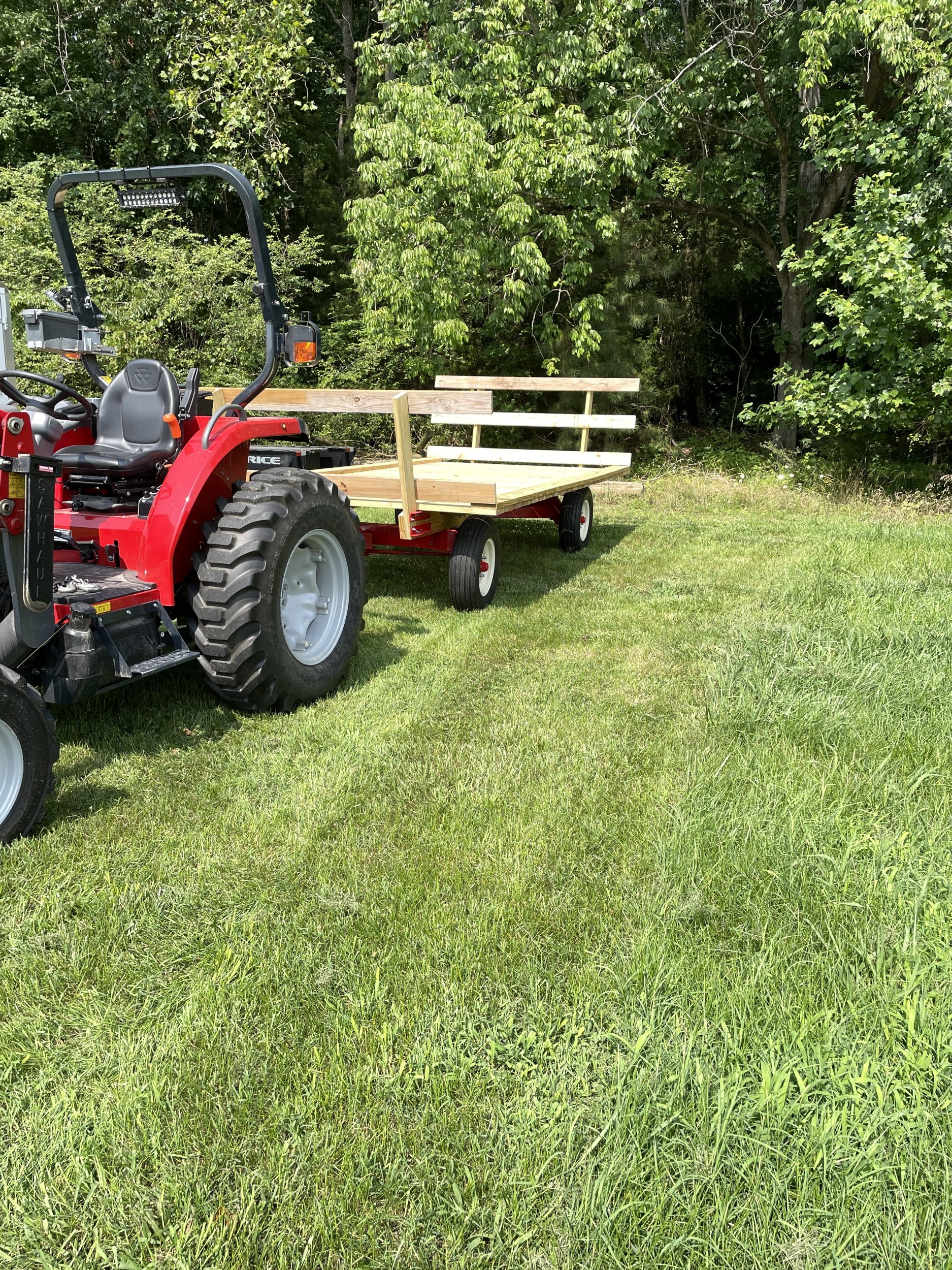

I pulled one out of the woods a few weeks ago. Just finished a 'resto' job on it today. It was a good project and will now be used for hauling hay on the farm, oh and for my wife's 'Fall display'
That looks very homemade in every way apart from maybe the cross beams? Big project!!

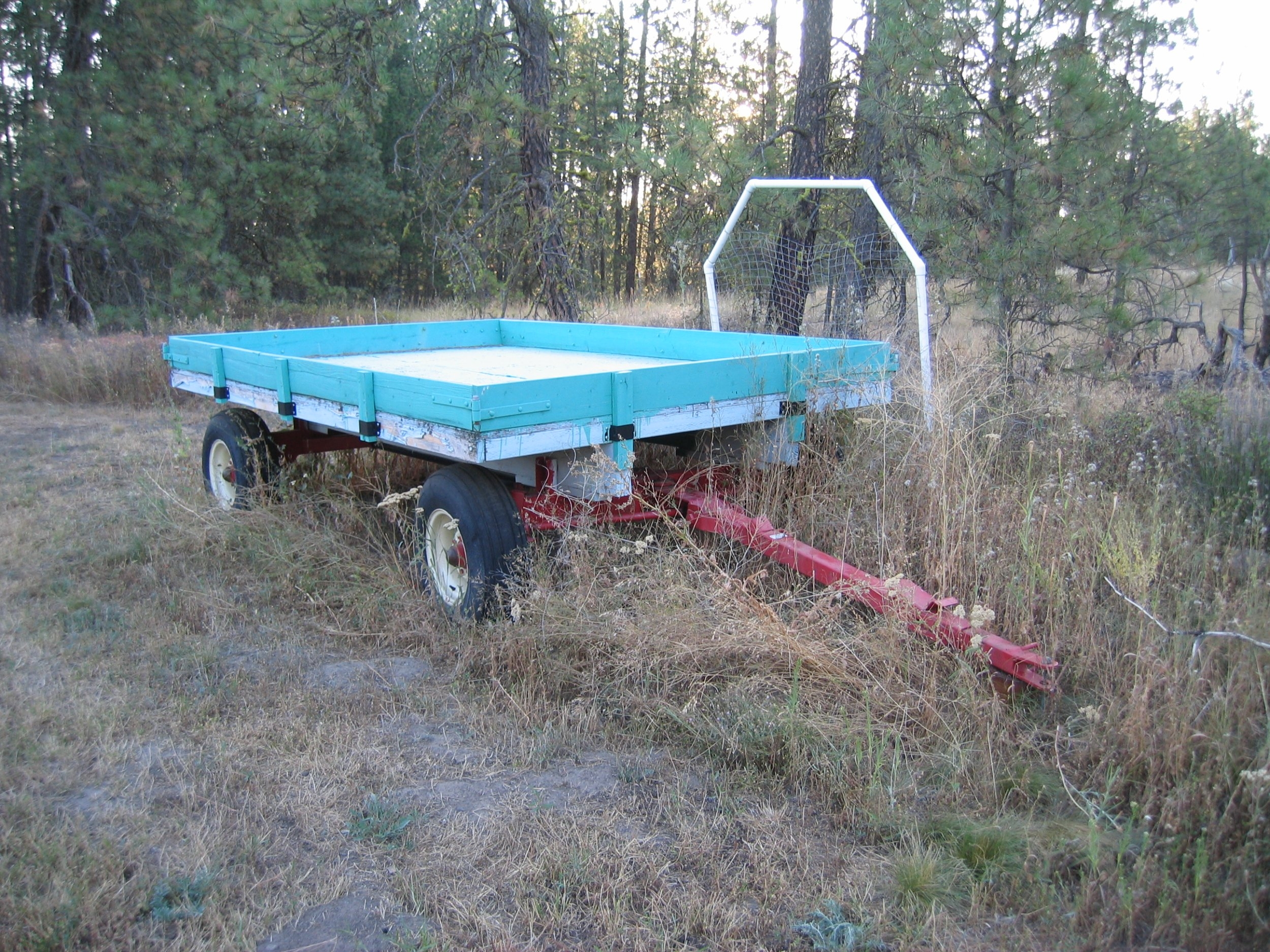

   / Old hay wagon #3
Certainly does look home made. I built this one about fourteen years ago. I bought a brand new ten ton Horst undercarriage. Built it up from there. I use it to haul large rocks and chunks of pine tree trunk.
   / Old hay wagon #5
If you can get grease into the pivot points and get the wheels to spin freely, then all you really need is to tear off the old wood, blow some paint on the frame, add new tires and a new wood deck. If the wheels are rusted beyond use that will add even more to the parts list dollars. Don't expect to be able to buy wheels or spindles or other "standard" wagon parts that fit.
It's definitely homemade. I wouldn't be surprised if they removed the brake shoes and internal brake hardware when they put it together. (?) Shouldn't matter but it would just be added weight that might rust up over time and keep it from rolling freely.
If the wheels will spin and the steering will move from side to side, it might be worth fixing for the sentimental value. Nothing handier than an old hay wagon . . .

I think I'm going to cut out the piece of large angle that's holding the center tubing together, weld in a section of round tubing in its place, and then probably run maybe a .25x2.5x2.5 square tube between the axles on top of that to brace it even more. Act the same way a subframe connector on a Foxbody Mustang or other vehicle acts. I may even use square tubing the same height as the axles to sit flush with the tops of them. I'm also thinking about trying to source some old C-channel beams to use instead of timbers to run the length of the main support for the top boards. Maybe even build a frame around them with some angle that the board would fit in and screw to. The I could mount some I-bolt or whatnot to the frame to tie round bales and things like this down with.

That looks like homemade running gear under that wagon with the hubs coming from an automobile. That would explain the "slapped together steering" and the drum brakes on the hubs.

Many were farmer-built on old car frames and axles.

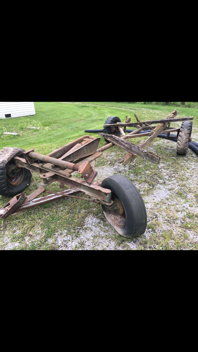

   / Old hay wagon #13
I pulled this out of the weeds last year. It was my great grandfathers and great uncles.
Has old 8 lug hubs on the rear and 5 lug on the front. Definately cobbled together.
Appears that the front was a wagon at one time. Dont have a clue what happened to the rear. Has a hoist on it. Cylinder is shot but I have plans to use the hoist with a new cylinder on a dump trailer build that I have a 5200 lb axle for.
Will try to make a short wagon and refurb it for sentimental reasons.
