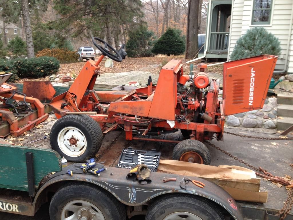

Hi everyone,
Was wondering if anyone could help me out. I got an old Jacobsen "Out Front Commercial" tractor. I'd like to get it ready to blow snow this winter but it hasn't been run since 2008 - supposedly it ran when it parked. It needs a lot of work.
The plan is:
1) Get engine running decent
2) Get chassis in working order
3) Get PTO and blower working
Step 1 of the plan has not gone as smooth as I thought. The engine is a 1.1 Ford industrial engine and is supposedly identical (except stroke) to what's in a 1980 Fiesta.
The tractor didn't come with a key so I had to replace the ignition switch. Old key switch:
I got a new one from Napa (pn: 7-01854) with the same connections on the back but am getting seemingly no action through the switch. The switch is getting 12V. If I jump from the hot terminal on the switch plug strait to the starter, the engine turns over. While doing that with the key "on", I get no spark. Wondering if anyone is familiar with this switch. I would at least like to get the engine turning over with the key, then I can worry about getting spark.
New switch:
Jumping from the hot terminal on the plug to any other terminal seems to do nothing. I'm wondering if the starting function goes through the Motorcraft Ignition Module or something:
Also, there are some plugs (fuse holders?) coming out of the conduit on the breakout to the alternator and ignition module. Anyone know what these are for? Have any idea if they should be hooked to something?
I've tried to trace wires but it all goes into conduit and most of the components share wire colors. Does anybody have any ideas on how to make one of these old ford engines turn over and have spark (with the key switch and ideally the factory harness)?
Thanks in advance,
Matt

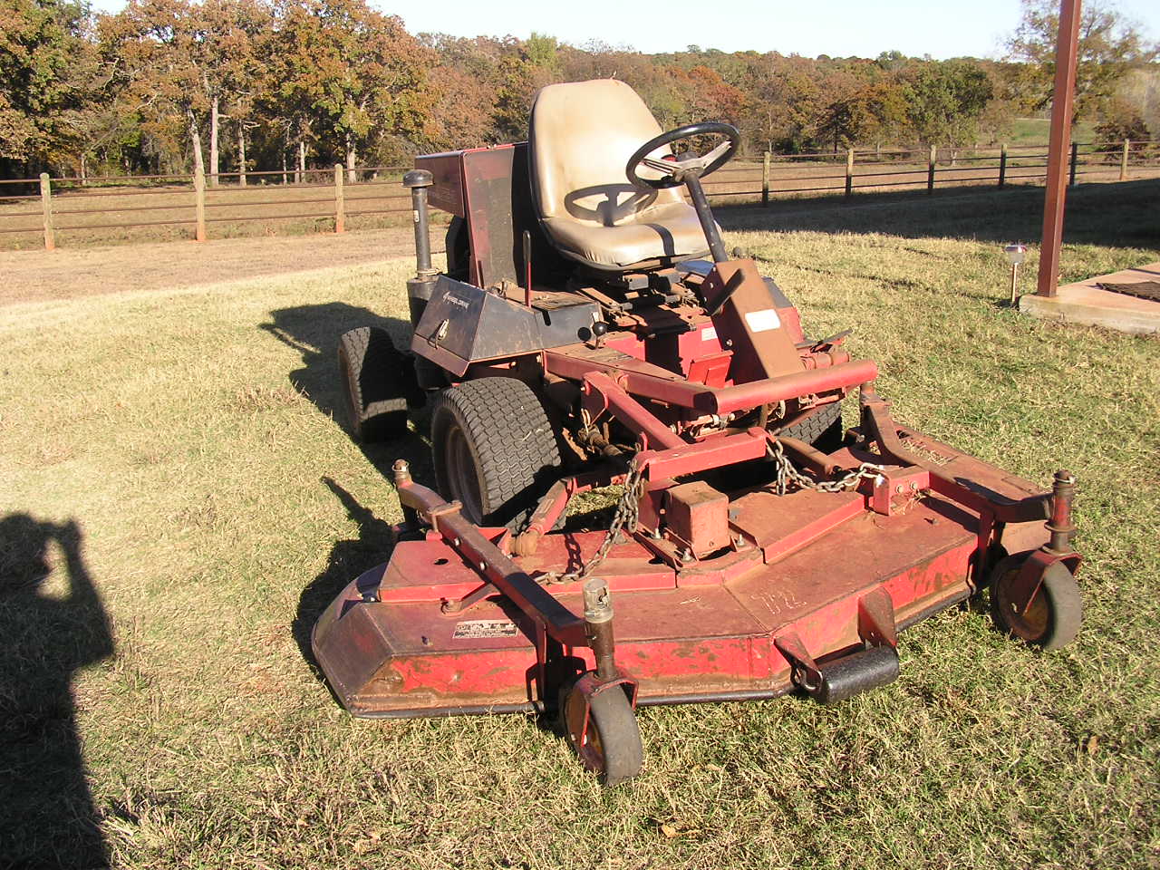

The new key looks like a generic riding mower switch. Will your new key work in the old switch?
There are some safety switches in the circuit that won't let it try to start. My TORO has PTO, HST Neutral and seat.
You should be able to get a manual with a wiring diagram for it.

Xfaxman covered it. Try jumping the parking brake switch, PTO switch and seat switch and see if that fixes it...

UPDATE
Not sure if anyone is interested in this project but I have some updates:
It's running and driving! but not very well.
This gets very long winded. I put question cliff notes at the end if you want to skip to there and give a noob some advice.
Xfaxman was right on. I found the neutral switch on the transmission was rusted and gummed up. When that was freed up it turned over with the key and had spark. I then tackled (or was tackled by) the fuel side of the motor. When pulling the old fuel lines, I found this:
Who needs a fuel filter when you have a bic pen tube?
I do. Along with a new fuel pump.
I could see rust in the bottom of the fuel tank so I removed the tank which involved taking half the machine apart:
Wire wheel to the bottom of the tank revealed great fun:
I had a shop patch it up and line it with a lifetime warranty:
About the same time I put new tires on it and a new seat.
With the new fuel system and a cleaned out carb I had the engine running. Step 1 from my original post complete. I then took on getting it moving under it's own power.
A big challenge I had was finding the right drive belts for this machine. If anyone is crazy enough to own one of these dinosaurs and is even crazier to want to put money into it, the follow info may be useful.
