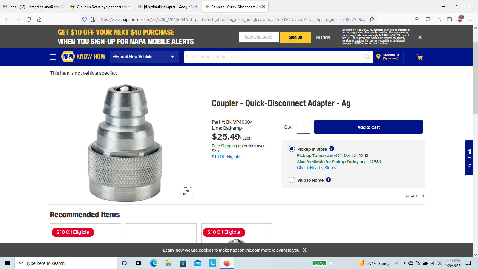

You mean like this?
   / Old John Deere hyd connectors. #3
Those adapters have been available for about 50 yrs but they sure have advanced in $$$$
I got no problem with that price. They make so many fitting types that I am not familiar with all the correct terms to identify the proper plugs and couplers.
Thank you for the link. I thought I posted that the other day and must not have done it correctly. My local Napa is long gone and was kind of hoping to find some on a shelf at a farm store. I forgot the forum had a hyd section. But those are exactly what I was looking for.

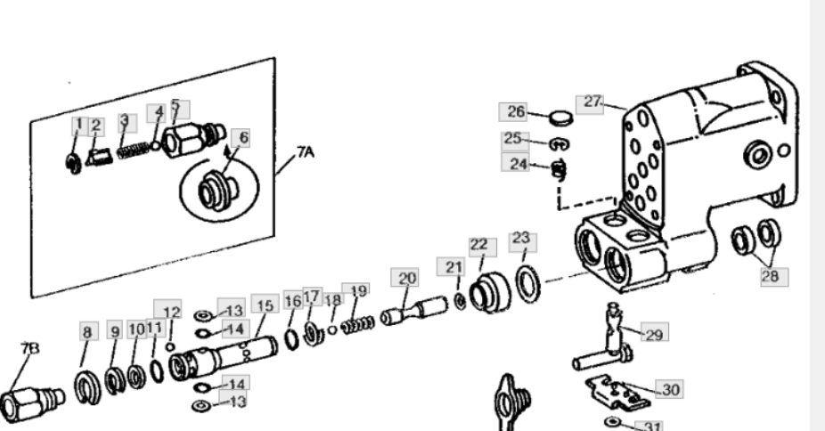

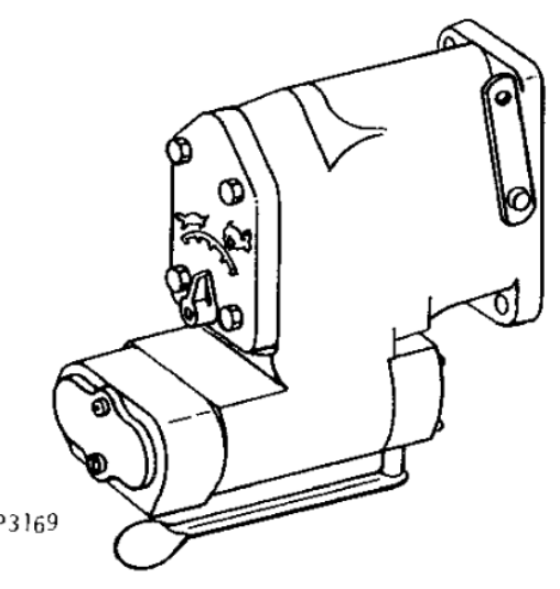

No JD 20-40 series utilized old JD style male tips & 2 levers(item 29) under body that controlled oil flow but didn't relieve hyd pressure similar to 50 & 55 series with single lever under scv body that utilize ISO parts such as photo that I previously posted. Newer SCV with single lever will interchange with older style but command a higher price
