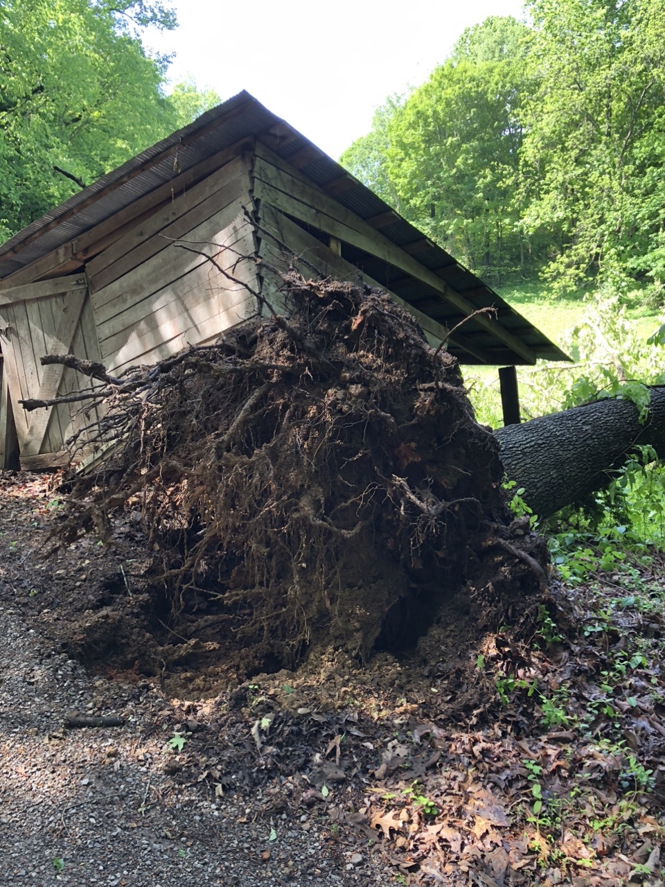

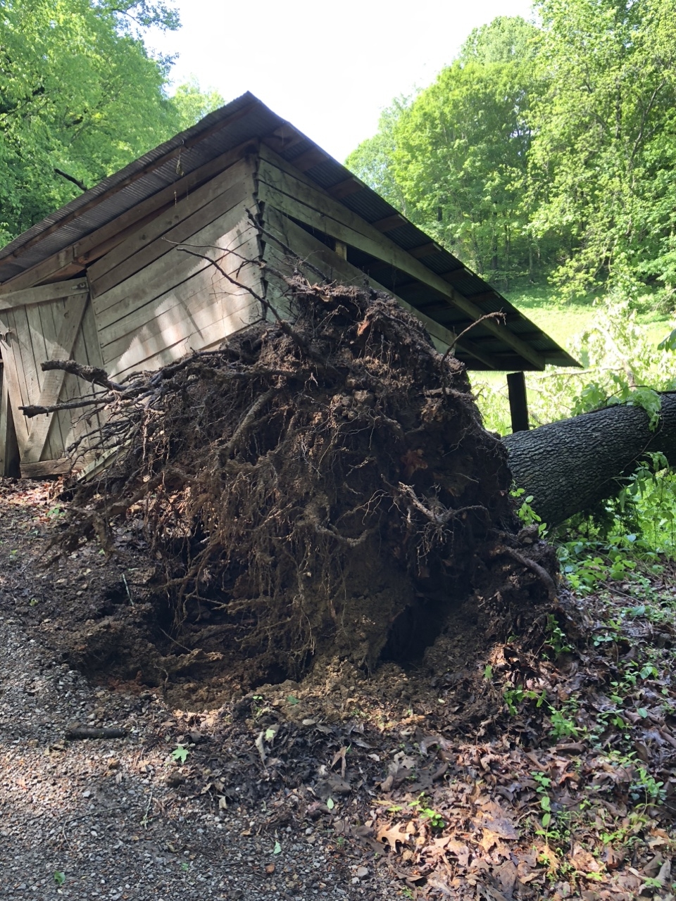

Had red oak come down this week. 34” diameter 120’+ tall. Decades of leaning, weathering storms finally succumbing force of gravity. Age like gravity wins in the end.
Jacked up the corner of the steer/goat shed about 4’.

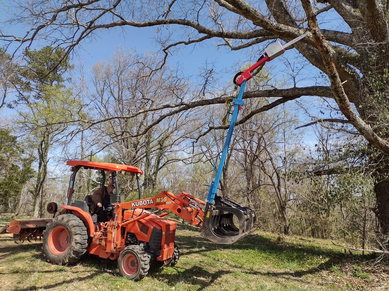

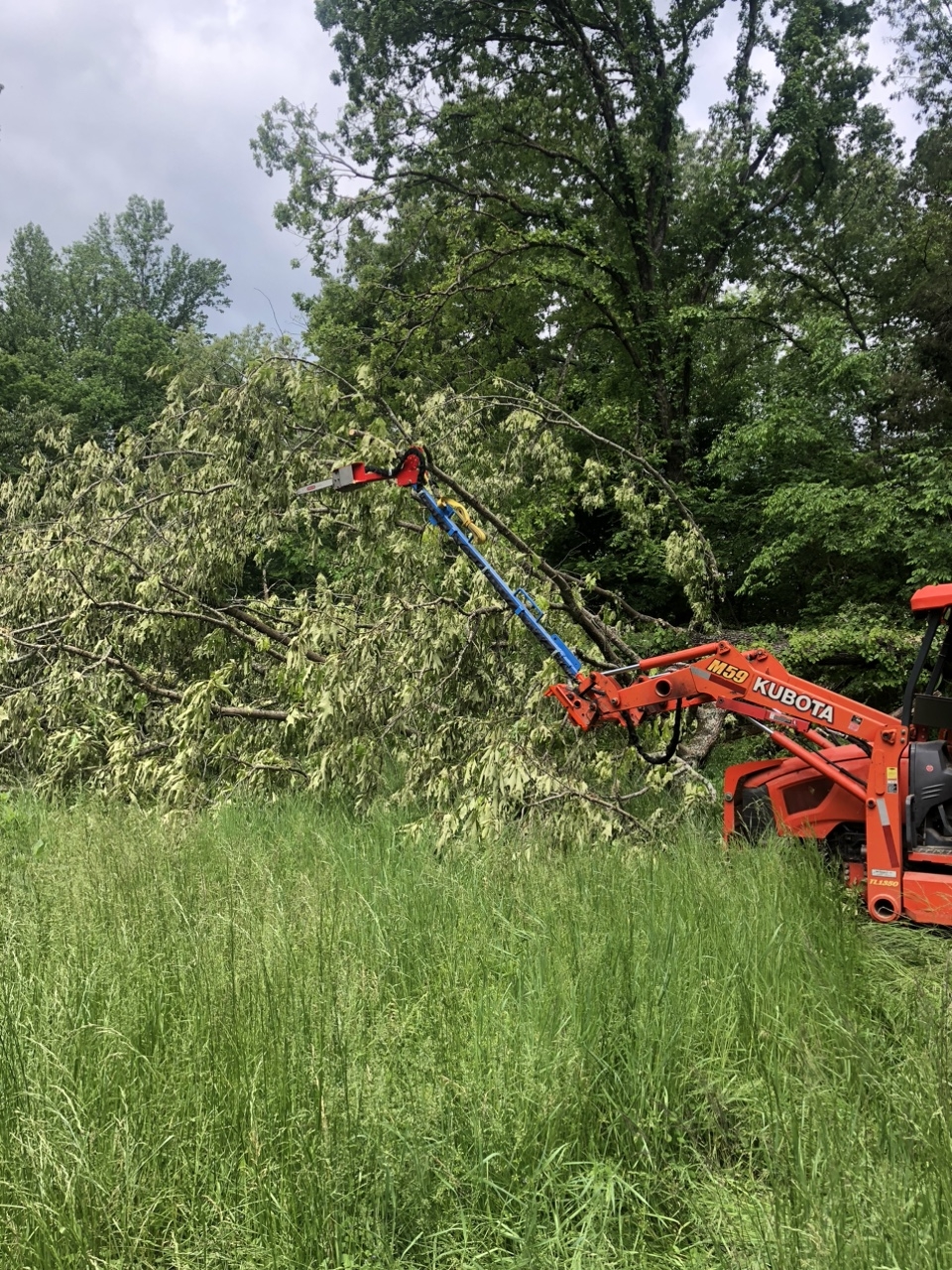

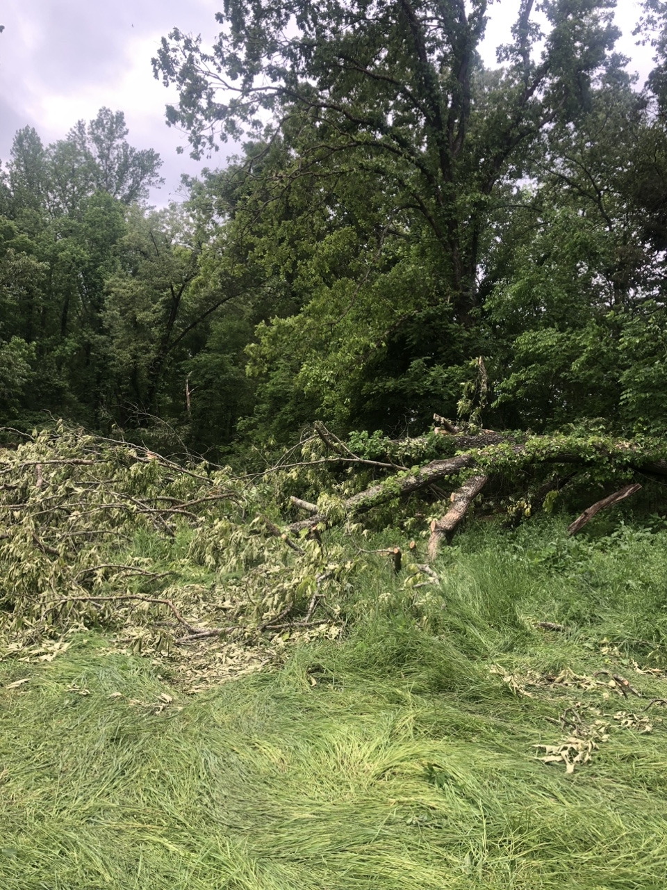

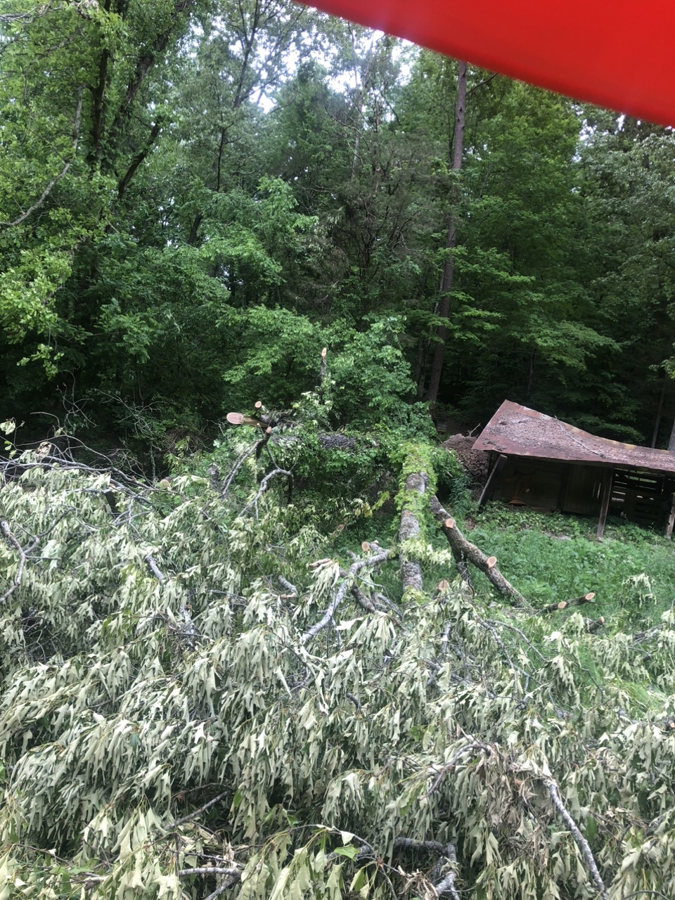

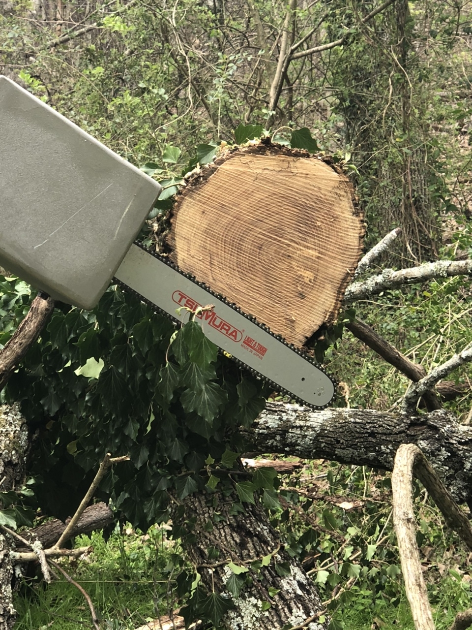

Have 50 years experience cutting trees. It is a risk complicated by age. Using a hydraulic polesaw I built, cut the limbs into 10-12’ sections. Sure beats being on the ground in the danger zone. Hate admit it but not nearly as quick or strong as I use to be. 70-80 cuts took about 3 hours. Stopping to put the saw chain back on twice and replace the bar once. Thickest cut 14” and all cuts at idle.
Now can use the grapple to haul the limbs away to the gulley.

Pardon my ignorance, but what attachment is that on your FEL to operate the chainsaw? I live in the middle of the woods and that would be an awesome addition for clearing around here.
   / Old man and tree #3
I believe it’s a hydraulic powered chainsaw rigged up as a pole saw attached to his FEL. I’ve seen power line crews use hydraulic pole saws from bucket trucks. There are hydraulic plug ins for the saw in the bucket.
Nice setup and looks like some good firewood if you cut firewood.
   / Old man and tree
There are several manufacturers now of similar saws. LimbHog, LimbSaw, limbinator. Built this one to match my scrap pile and needs.
Have next 6-7 years of firewood cut. Being next to 300 year wagon road and farm buildings be a risk of milling the lower log section.

well done rig. all pole saws sometimes get pinched high up. have you run into any problems with pinching w/a arm that length? good work.
