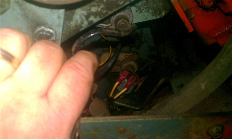

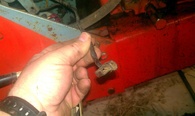

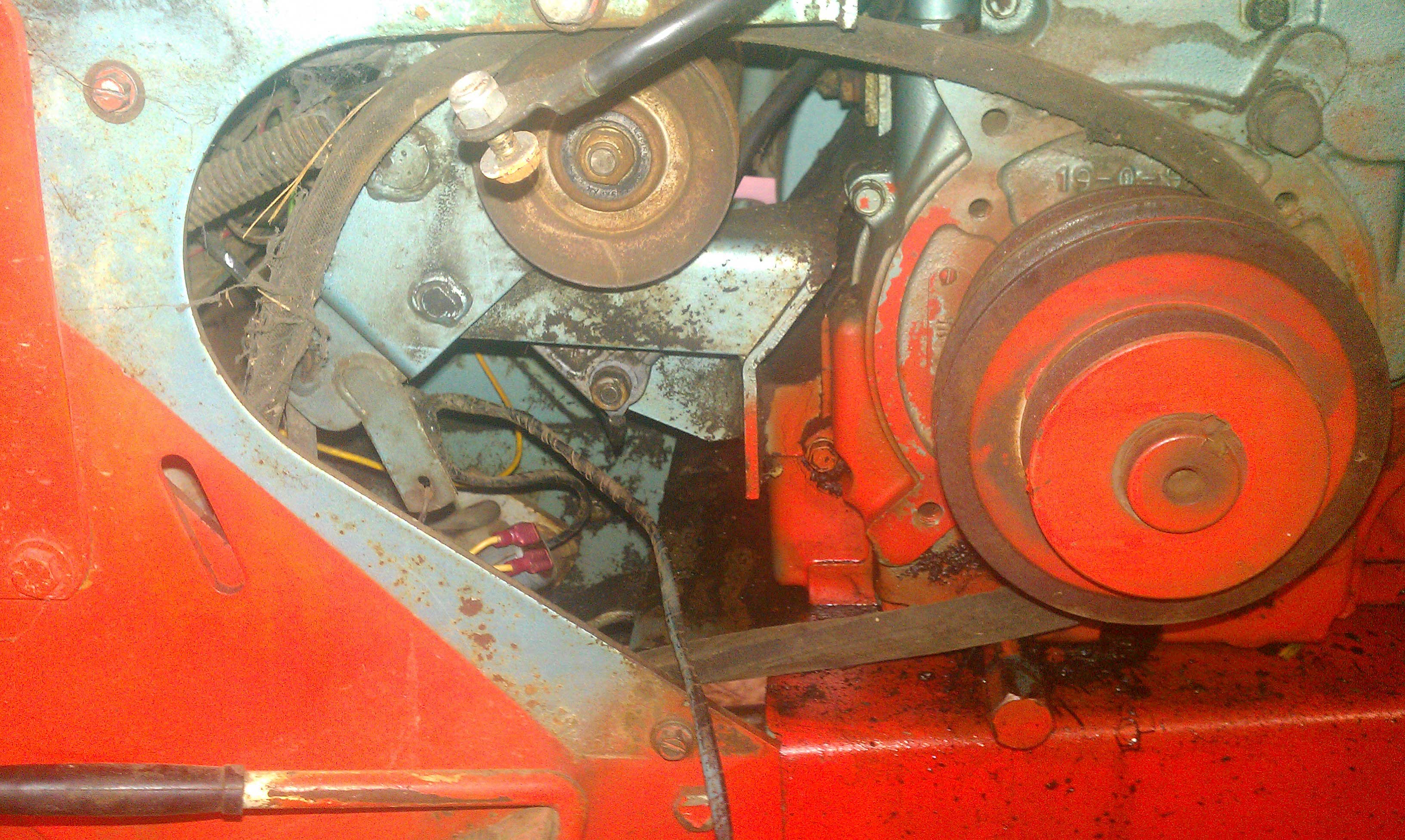

But in his disassembly he disconnected probably the only safety switch on the darn thing. I put new ends on the wire on the actual safety switch and plugged the wires back in to it, but I've got two other problems. I can't find where the other end of the wire is supposed to plug in. I'm assuming when the switch is depressed it is supposed to complete the starting circuit, but without knowing where this is, I have no idea if he jump it or not. Second, I can't figure out how the brake/clutch panel is supposed to engage the button.
I've looked on Sears' website for a manual, but the one for the tractor is some little cartoon like drawing, but the one for the plow and the mower deck are much more modern looking and go into much greater detail.
Anyone have any ideas on either of these? I've attached pictures so you can see what/where I'm talking about.

The first picture would be of the neutral start switch and should be wired into the starting circuit from the key switch to the solenoid or coming off the ground prong of the solenoid if it is a four wire solenoid. the second picture looks like a connector for headlights.
   / Old Sears Suburban SS12
It is the other end of the same wire that is coming off the neutral safety switch.

It was raining here Saturday afternoon so I had a chance to work on this some. Looking at the electrical diagram on Sear's website and the parts diagrams, I think I have this figured out.:eek: Looks like I was right on the brake switch, however there is a little tab held on by a cotter key that is broken off. Who knows where, when, or how, but it is gone. So it won't actually depress that safety switch. Of course, not available. I've sent a msg to a guy on ebay to see if he would have one, no repsonse yet. The second wire I posted looks like it goes to the attachment lever safety switch. Kind of weird on the Sears' diagram, it is inline with the brake safety switch (that makes sense), but it has a circle around it like it was optional. I see nothing on my attachment lever that would correspond to this. Since this tractor didn't originally have a mower deck, would they not have put that safety switch on it and just jumpered the wire? I don't know, but in the short term that is what I'm going to do for both of them.
I also found, that it looks like the ignition switch is bad. I can get continuity through the start circuit, but not on the run circuit. I'm going to stop tonight and pick up a new switch for it. I then found the one wire that goes to the motor from the ignition switch, I thought it was a ground wire, but now it seems to be the hot wire from the ignition for maybe the magneto? It is labeled on the diagram as M. The other 2 wires are B - coming from the battery and S - solenoid. There is then a ground wire with a loop that goes around the threaded portion that sticks through the dash.

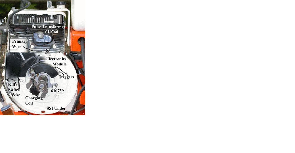

I worked on it a bit tonight. I pulled the flywheel and got to looking real close at the pulse transformer. I notice the wire coming from the magneto had been pinched at some time. I pulled it off and cut the end of the wire and soldered a new end on it along with a new connector that went on to the magneto. I then also sanded the magnets and got them clean. I look how to adjust the plate on the flywheel, but when you loosen the screws they just back out without moving the plate. I put it back together being optimistic. Turned the engine over and it didn't try to start. I pulled the plug and ground the edge of it to the engine. I can see a blue spark, just not sure how strong it really should be, but this one was decent. I'm going to stop and get a new plug tomorrow and put some more gas in it and give it a try. I'm also going to look and see how and if they can be to adjust the valves. I'm not sure if this has timing that can be adjusted or not, I don't really see how it can be as it driven off a woodward key in a groove on the crankshaft corresponding to a groove on the flywheel.

Gap the magnets to the coil with a business card between the magnets and the coil assembly. Loosen the bolts holding the coil assembly with the business card between and slide the coil until the business card just slips out and tighten the coil. That's the correct coil to magnet gap.

I'm still trying to figure out how adjust this gap. I've attached a picture of the mag, the flywheel then goes over top this and completely covers it, so I'm not sure how to tighten it down. I don't think I could even be able to get a business card behind the flywheel and up to the mag area.
