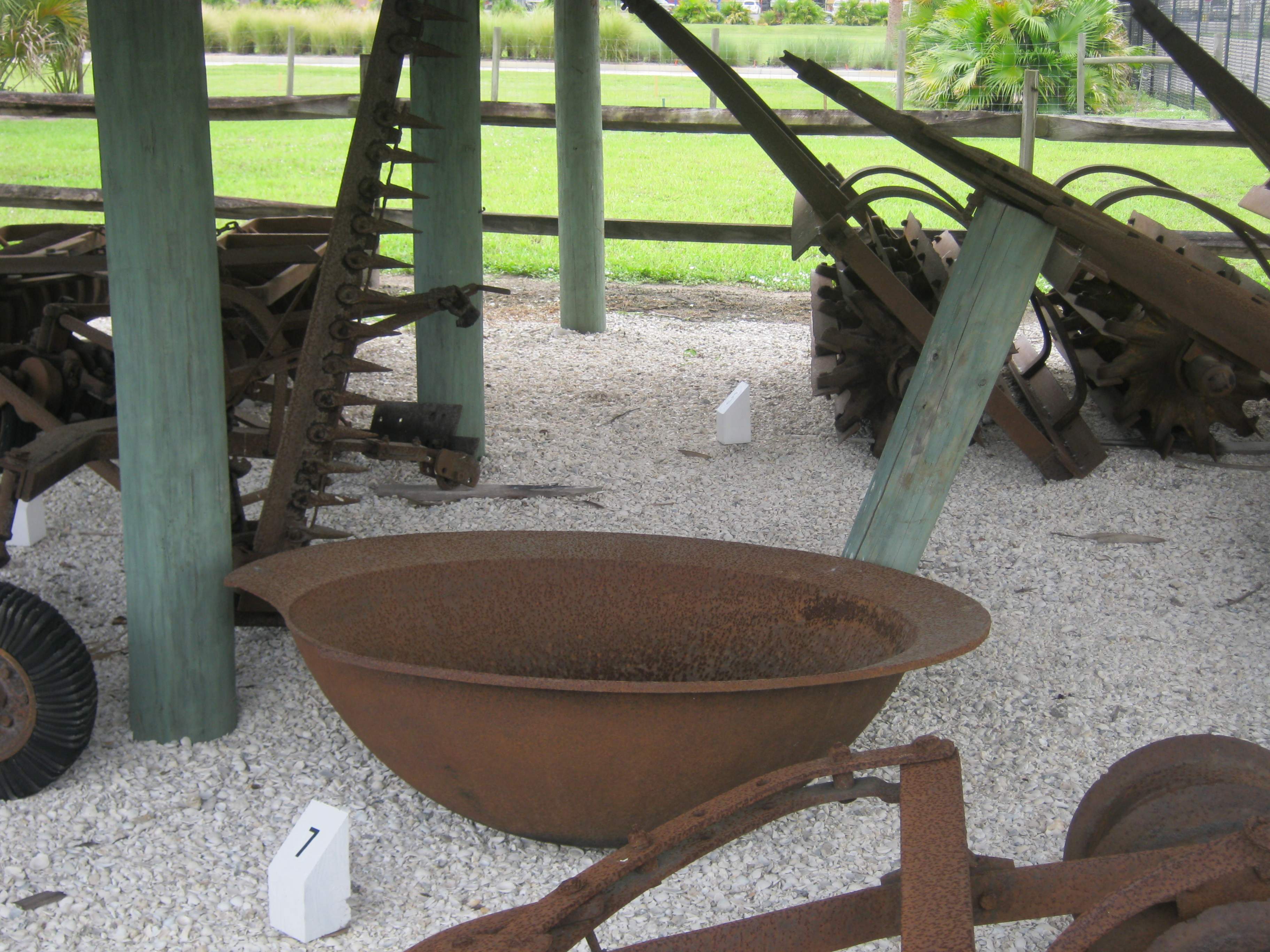

by some chance did you stumble onto a syrup kettle anyway to post a picture
Don't know anything about syrup kettles but heres a pic of what I believe to be a sugar cane kettle. If that helps.

yes that is a syrup kettle also known as a hog scalder when i was growing up in south georgia. our old family kettle my brothers and i found awhile back while doing some work at the farm and as strange as it seems ours is broke almost like yours. please keep this in mind also those pots are quite valueable i have seen them go for a low of $200.00 to over a $1000.00. in the past few years there has been a big comeback in cane syrup making in the south a lot of people looking for these kettles and you can make a few gallons of syrup from a small back yard garden and seeds are available from for real feed and seed stores or can be ordered if any want to try a hand at it good lacuk
