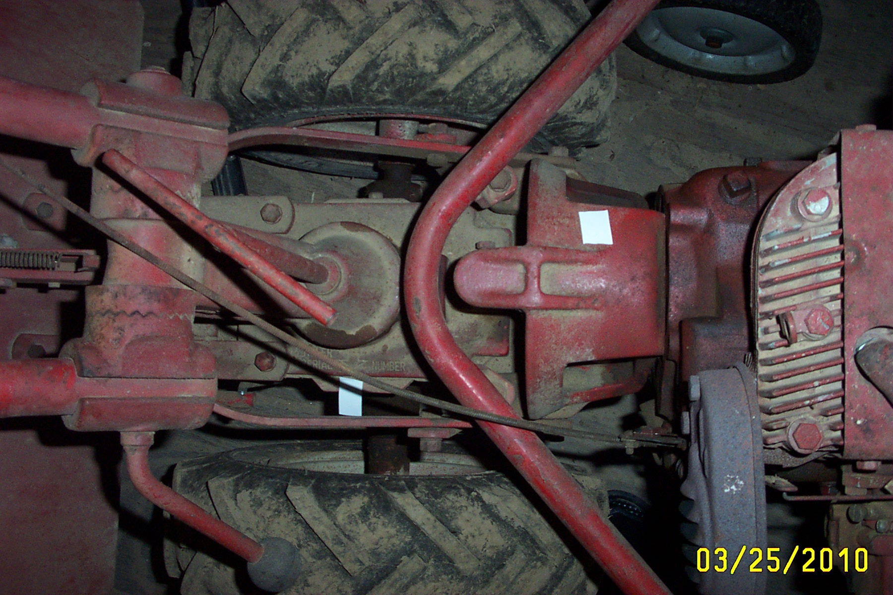

On older Troy Bilt Horse models, the tiller SN is on the left part of the engine mount as shown with the white tape in this photo. On newer models, the tiller SN is on a tab on the top right side of the transmission housing.
I think those numbers cast into the side of the cast housing are part numbers.
You have the Briggs engine model number 132232. The type gives further information, but that model number should be a good starting place to find more information at your Briggs dealer. I think you have an engine that someone swapped off another machine. I don't think it came with your tiller.
I bought a Briggs gas tank a couple of years ago and it wasn't cheap.

The serial # I posted came off of a tab on the right side of the tranny housing. Is this engine big enough to handle the task asked of it? Hope so because it's gonna have to this year unless I stumble across a deal.
