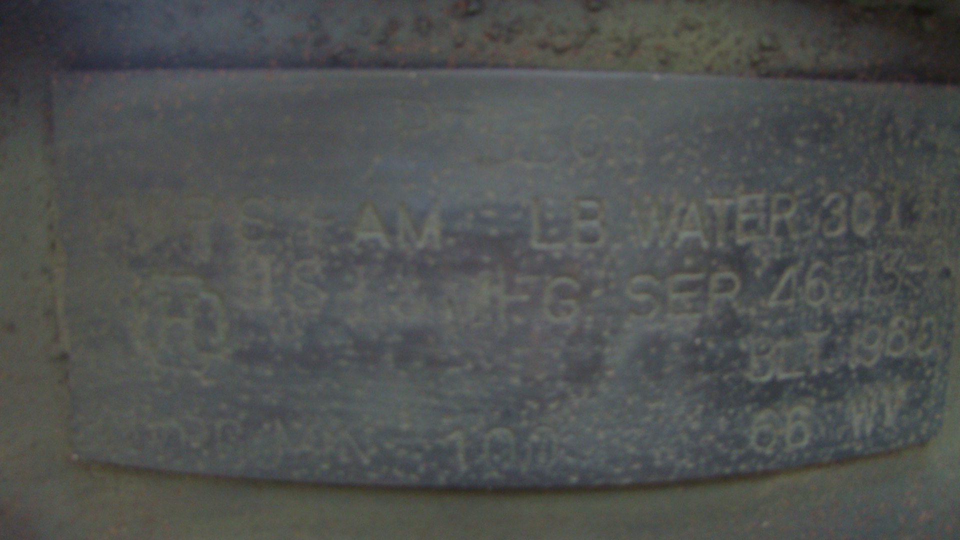

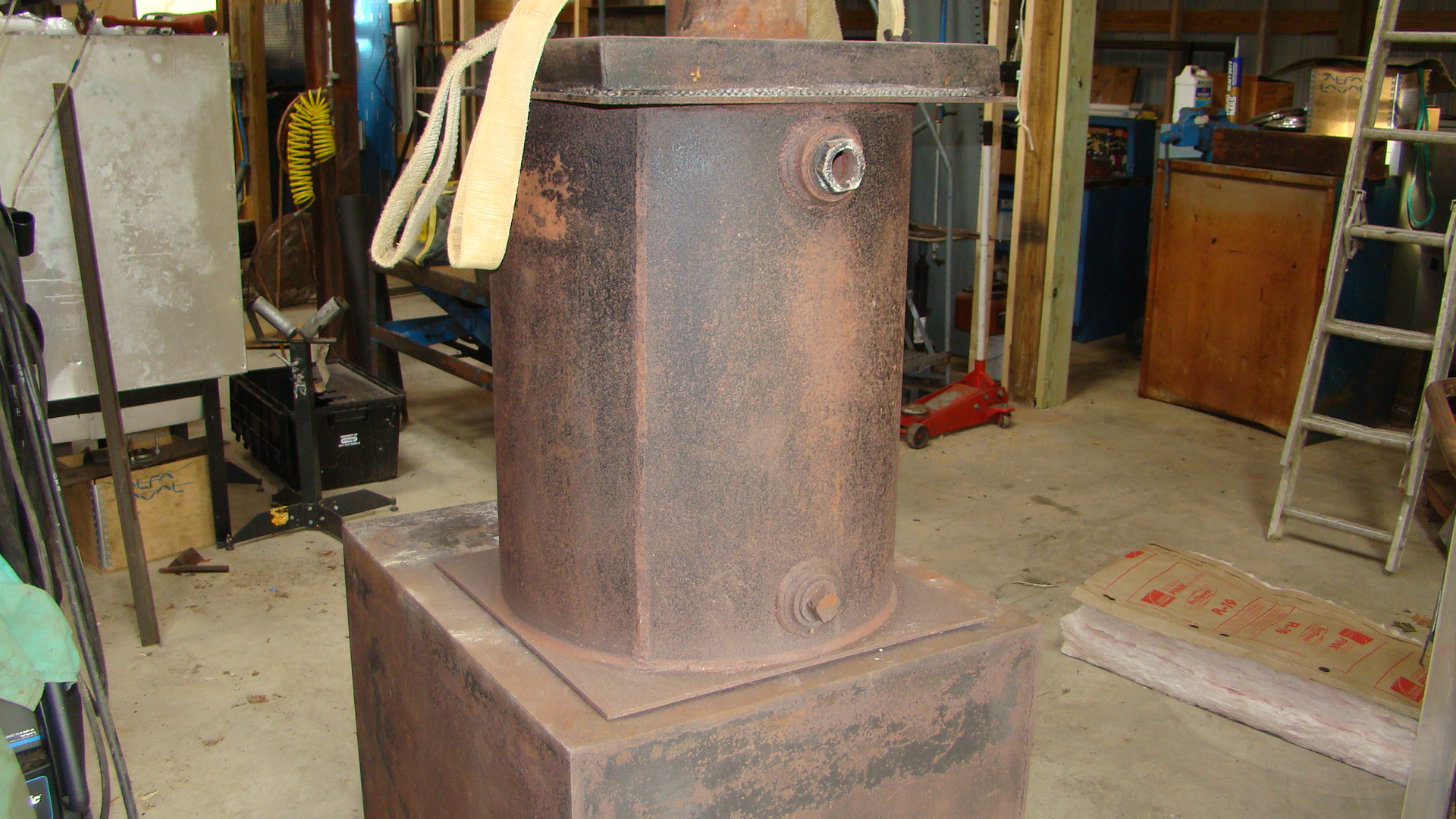

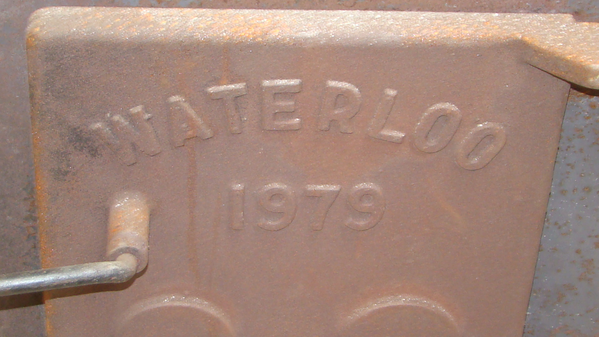

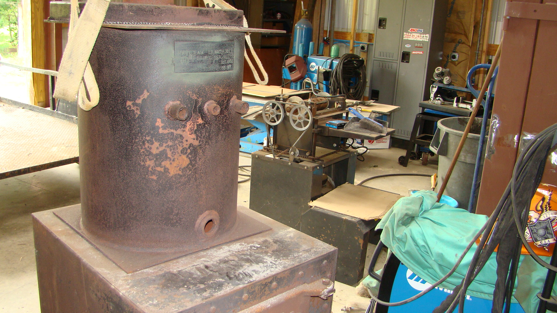

After I got it off the trailer and had a chance to look at it over it looks like the boiler and the stove are two separate units made by two different companies and just put together as one unit. The guy that had it said he had never seen it in action but the guy that had this property before he got it said they used it all the time. They had it hooked up to a big Cat radiator that heated a building next to the one it was in. The heat from the stove heated the building it was in. This guy was going to haul it to the scrap yard so I took it off his hands for $20.00 and he loaded it on my trailer.
I was thinking that maybe I could use it to heat the water for my floor heat for awhile until I could come up with a more permanent solution even if I had to put it outside and pipe the water into the building.
The pic of the plate on the boiler is hard to read so I'll put it here:
top middle..... PEBBCO
Under PEBBCO....... MWP Steam LB. Water 30LB
Next line.....there is some kind of logo, a symbol with an H in it and, [ H] LSL & MFG.........Serial 46813
Right under serial is,...... BLT 1960
bottom left........It's hard to make out but I think it says, SVRC Min 100 66 WV
Hopefully that makes some sense and you can get something out of it.

You have two totally different units there. The vessel (what you call a boiler) originally had no relation to the fire box below. It was made long before the fire box. I am guessing the fire box originally was just a manual wood fired boiler. Their should be a pipe bundle or coil inside hooked to those two pipe stubs at the bottom. They were capped when it was not used as a boiler any more when the top vessel(what you call a boiler) was set on top.. You didn't show what the firebox flue system looks like. The plates on the units are the manufacturer's nameplate and test stamp. The H should be inside the symbol that looks like a 4 leaf clover. That is the National Board of Boiler and Pressure Vessel inspector's stamp. Pebbco should have a record of the vessel and what it was originally made for. Hard telling what it was. Can you tell if those small pipe tapings on the side are the in and out of a coil inside. It may be a side arm heater. Both are long out of date for re-testing. If Waterloo or whoever may have bought them out is still around they should have those records also. Setting the vessel on top like that does not provide good heat transfer so it would be very inefficient. With out an insulated outer jacket you have one large radiant heater. They both were formerly insulated I am sure.
Bottom line: You have a pile of scrap iron you paid $20 for. To make something usable would not be cheap and it will still be of iffy from a boiler safety standpoint. If you have never seen the destructive force of just a small home hot water heater going up in the air or sideways; take it from me you do not want you or your family to be anywhere close. I have seen the results of a relatively small boiler taking a whole industrial concrete block building to the ground.
Boilers are not something for the novice or DYIer should be messing with. Boilers go through a very rigorous manufacturing, testing, and re-testing program to keep them safe. National Board inspectors have a long torturous qualification process. Certified welders and even the shop also have rigorous qualification processes.
Haul it to the scrap yard, Ron

Yeah, when I got it unloaded inside my building I could see there was some modifying that has been done. I can take the top part off the stove part and you can see where someone has cut a hole in the 1/4 inch plate for the boiler part to fit in to. There are boiler tubes running through the boiler part for the heat to pass through to heat up the water. They used stove rope to seal the surface between the two units. I won't go as far as you did in saying all I have is $20.00 worth of junk because the stove part is in good shape and has fire brick in it that's in pretty good shape. Some of it fell out of place on the ride home over the bumpy road but it can be put back in place. It has a real big firebox and would heat probably heat my shop fairly well if I wanted to mess with a wood stove on the inside of my building. If the boiler part doesn't work out all I would have to do is weld the hole back up and and I would have a good wood stove to use or sell if I decided not to keep it.
If I have time I'll take the two pieces apart and post some pics of what the parts look like.
