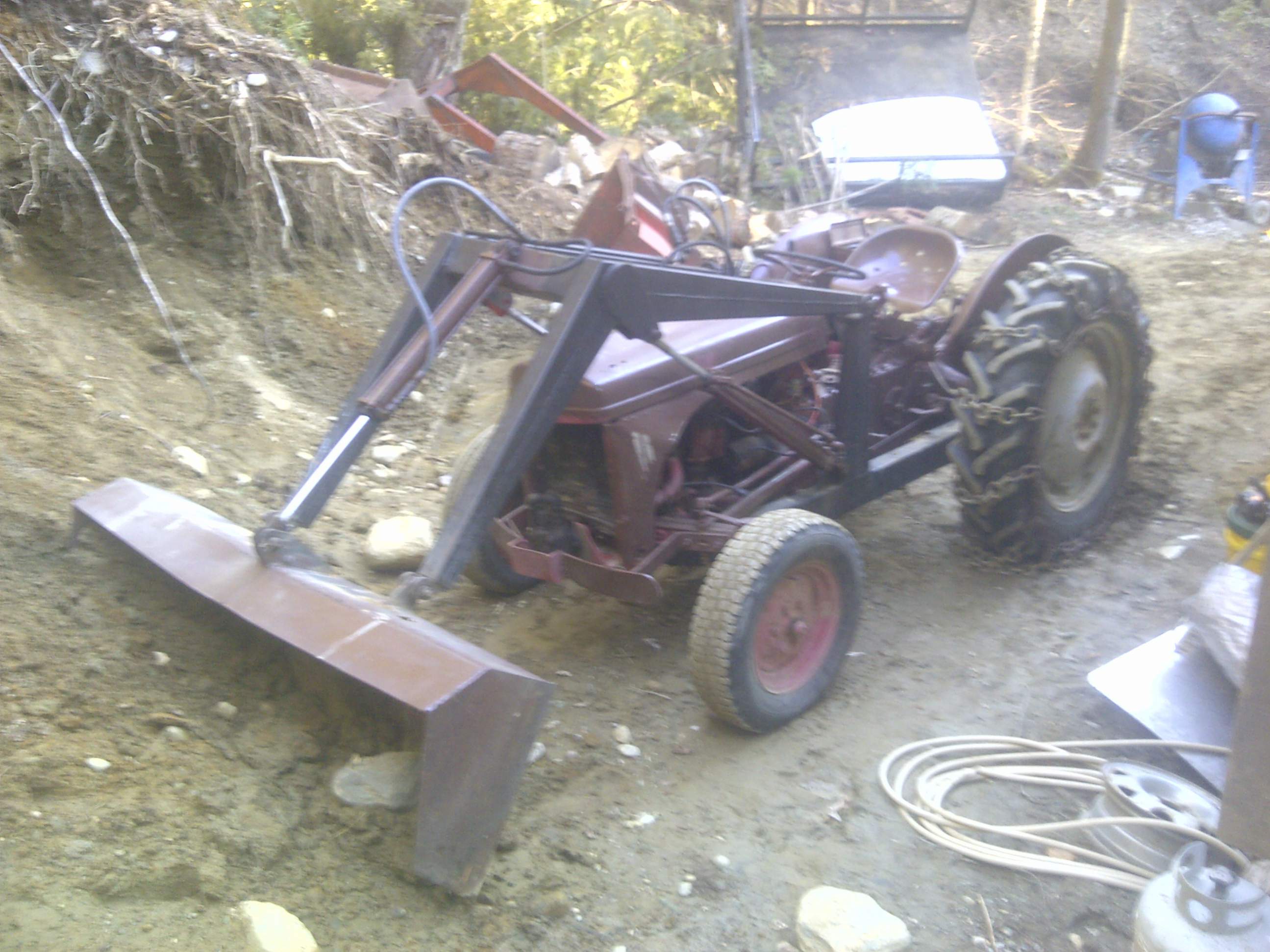

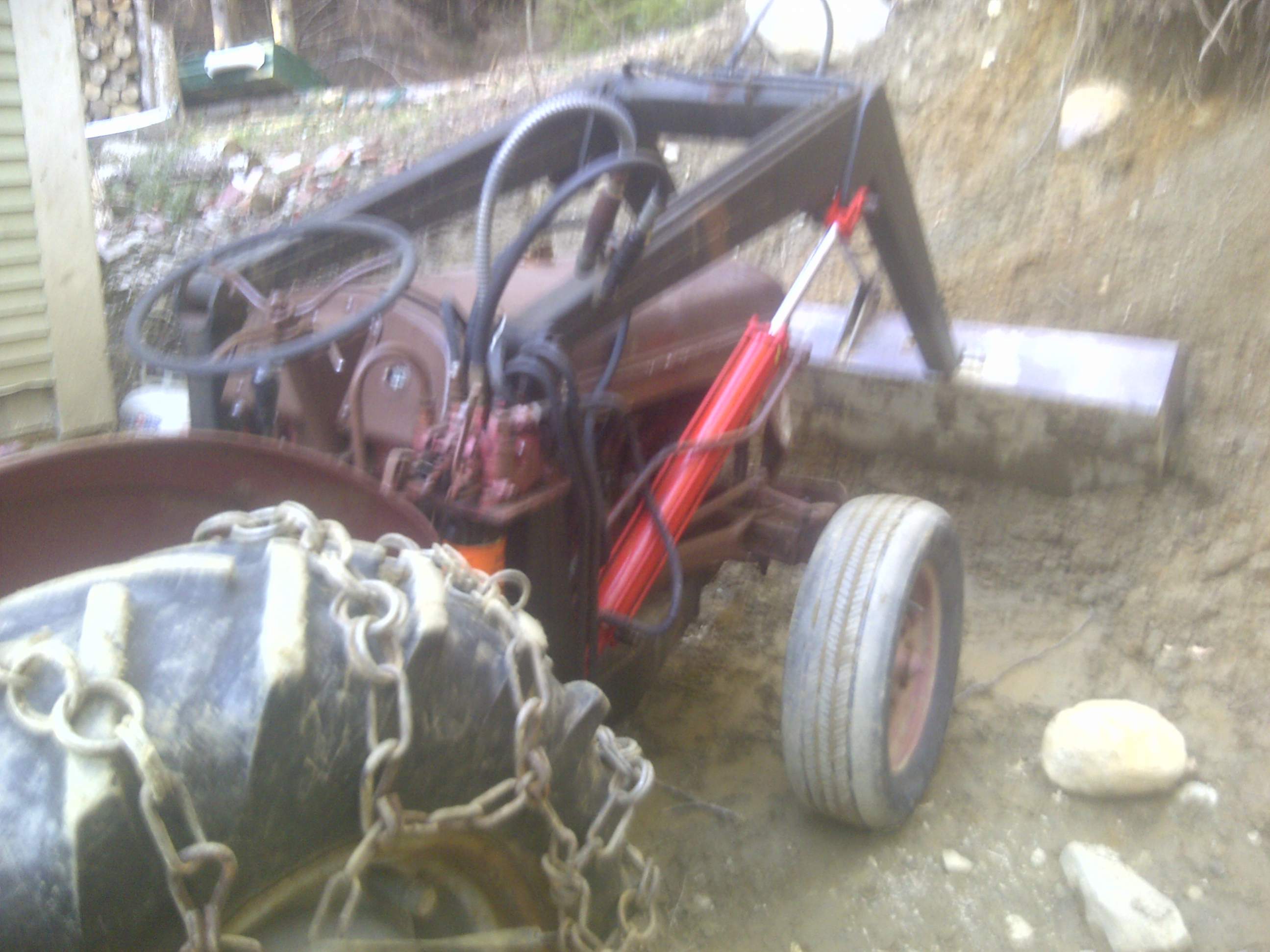

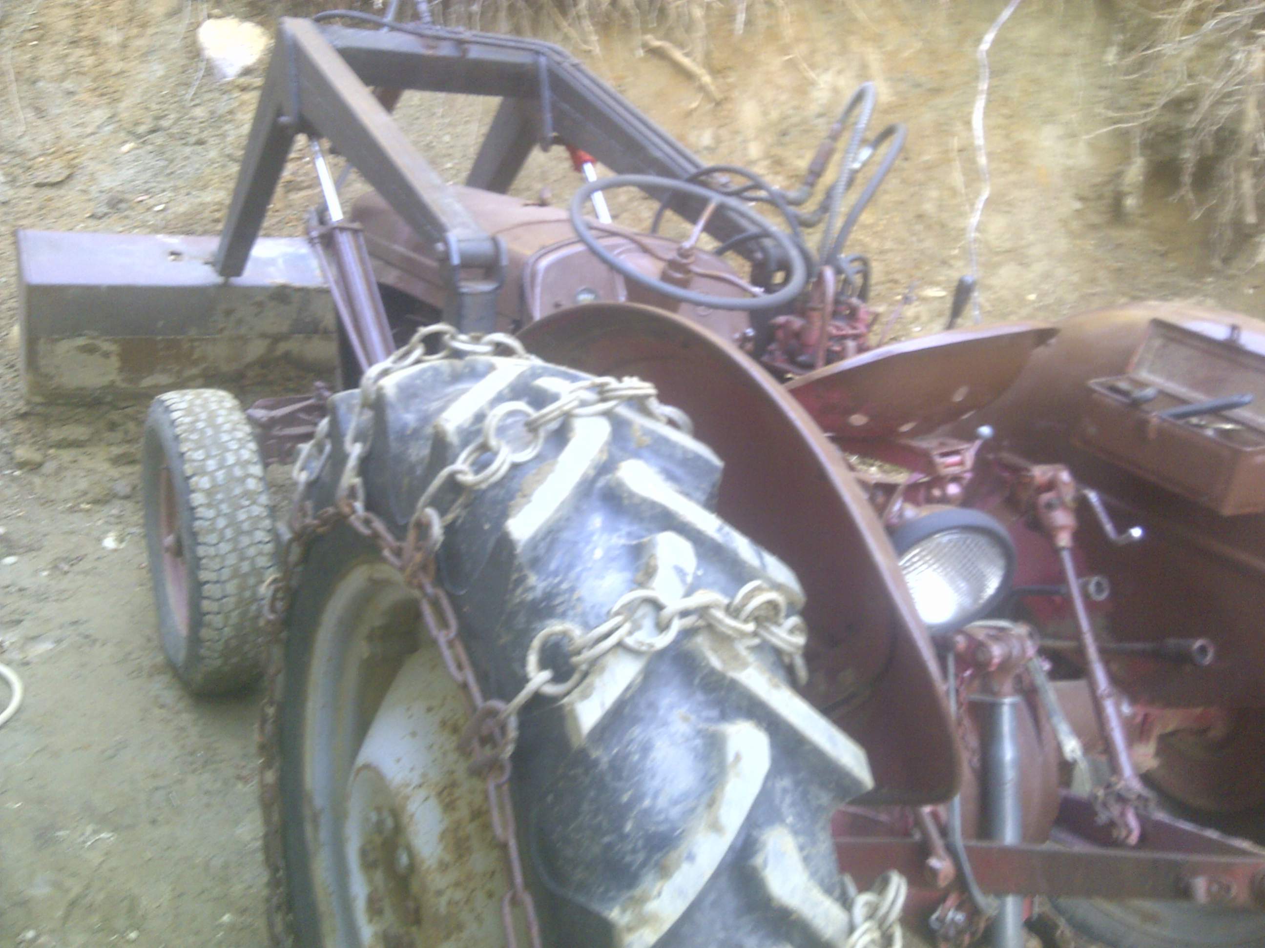

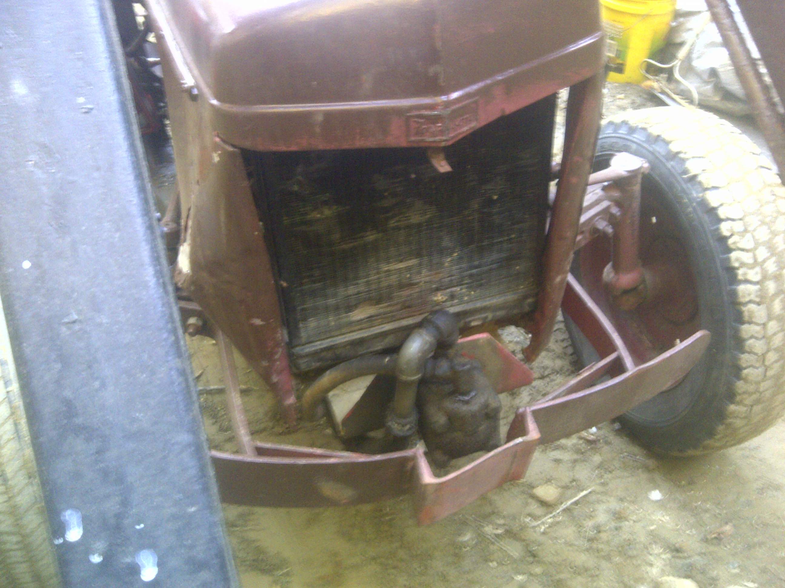

This is one of the tractors I was looking at owner is asking $2100 for it. He doesn't know much about it from what I can sumise its a TO-20 or a TO-30 not sure which but its only got one shift lever no hi-low so I think that limits it to one of these models from my limited researching. He isn't too far I think I may drive over and see if I can get some serial numbers and a better look. Another guy has a TO-35 with a loader with nicer paint but that doesn't mean its in any better condition underneath. He is a bit farther away at about 1.5 hours. All in all they look to be similar old tractors at identical prices. The loader on the TO-35 seems like it has a lot more parts in the way of working on the tractor. The chains on this one seem a lot more rugged than the chains on the other one which are just normal 4 link chains by the look of it.

With your mechanical background I'd vote you get the old cheap tractor and start looking for a good used 4x4 30 to 40HP tractor with FEL. You should be able to find one in good condition at half or less what a new one costs.
The older tractor will get you started and can always be resold, but two tractors are handy.
New is always nice but a lot of what we pay for new involves warranty, maintenance and shine. If you've got the mechanical skills and can read maintenance reports you should be able to weed out clunkers from the gems and get a good 30+ HP tractor for < $15K.

Power steering is not a modern convenience when you have a loader, it is a necessity. I would look for a tractor in the late 50's or newer if I was going to buy a older used. A NAA is not a bad tractor, it is a slight improvement over a 8N.
I think you are on the right track on the new tractors. A B series sounds like it would be a good size for you. As far as the firewood skidding why not cut the trees into firewood in the woods? That is what I do. I stack all of my wood on pallets so it can be easily moved. You could also pull a trailer or cart with the tractor for firewood.
I see a lot of old Ford or Ferg Tractors with front end loaders on them. I cant imagine farmers would take the time and money to buy or fabricate one if it rendered the tractor useless. I think your right though with a really heavy load I can bet you have to really muscle the steering at a stop or slow speeds.
