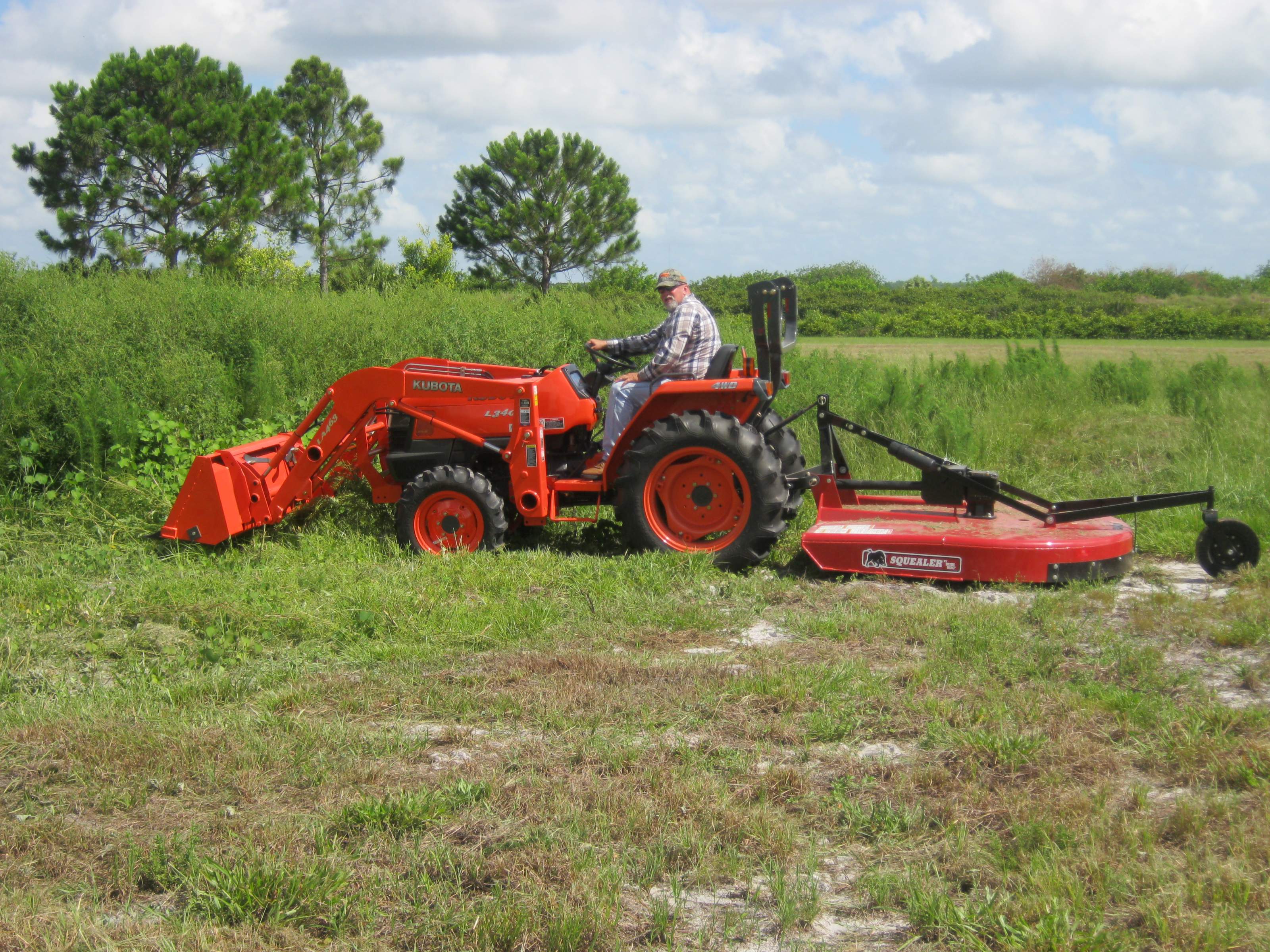

Post a pic or two of your final decision.
Boone
Squealer 172 / L3400 DT
