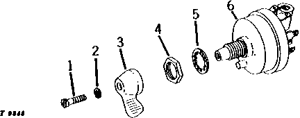

I've inherited this tractor from my dad. I have a silly question. Below the key/ignition there is a toggle the clicks into 3 or 4 different positions. Is this some type of choke? Unable to track down what this does - when it is in one of the positions the tractors makes an awful noise when I try and start it. Having troubles starting it this spring and was hoping this lever may be some type of choke. Battery charge on it right now to make sure everything is up and charged.

The switch you mention is actually the light switch. It shouldn't have any effect on starting... unless someone has changed things around. The 300 did not have any glow plugs.

Thanks so much - that's the switch -
Could be I turned on the light and that pulled the power from the battery.
Appeciate your help!
