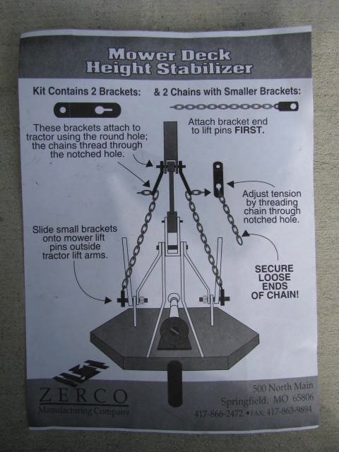

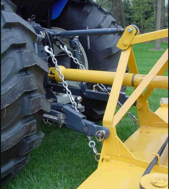

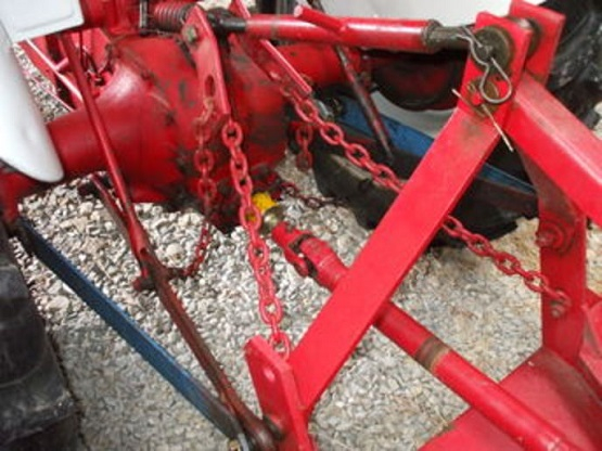

   / Older tractor with rotary mower gouges dirt #10
Put check chains on it so it can't go that low:
