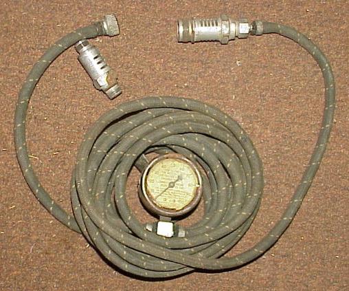

For the budget minded air solution, with those with gasser engines, borrow a cylinder from the engine under the hood occasionally. :D
