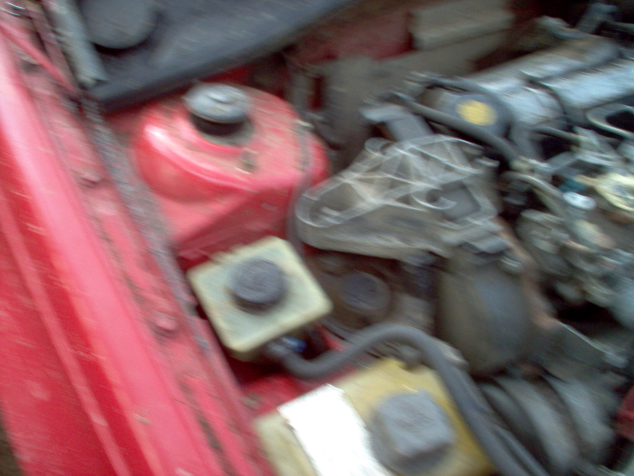

Another two pictures:
one of the broken engine suspension rubber (not only the engine popped up, i got a sore back and a friend got a sore neck from being skyrocketed into the car's roof...
