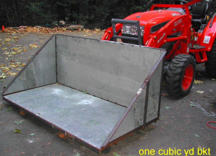

Ever wish your loader bucket was WAY bigger, like when you
want to haul trash or firewood? Well I've been there...often.
So I decided to build a replacement bucket for my loader, a bucket
that could carry 1 cubic yard of material (heaped). Of course,
this won't be a cy of rocks or wet dirt, and it lends itself to manual
loading, not driving into a pile.

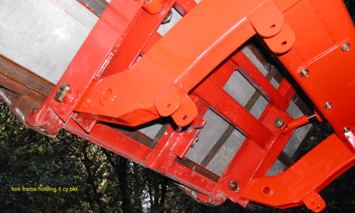

I needed to make this strong enough, yet not so heavy that I use
up most of my loader lifting capacity empty. If I built this of 1/8" steel
and thicker edges, It would probably weight 600-700lb. Too much.
The result is a bucket that is probably 300+ lb, constructed mostly of
1.5x1.5x1/8 angle and .060 galvanized sheet. It is welded to 2x4
rectangular tubing so I can drive my pallet fork attachment into it
for easy use. The paint job will have to wait for warmer, less humid
weather.
My use of this Kioti CK30's loader is what I call fork-centric. Since my
primary FEL use is lifting stuff, I have custom-built dedicated forks,
built for strength and light weight. They do not adjust side-to-side, but
I have not found that to be a significant limitation. Attachments fit on
the forks, which is opposite to putting attachmnts on the loader bkt.

That looks larger than a yard. What are the dimensions of the bucket? Looks like it's 36" tall, 36" deep and 72" wide. Wouldn't that make the capacity a yard, not heaped? Maybe a yard and a half heaped? So confusing!

Dims are 30x36x72 for a volume of 22.5 cf not heaped. That's .83 cy.
Heaping needed to get that last 4.5 cf. Heaping split firewood is
generally what happens.

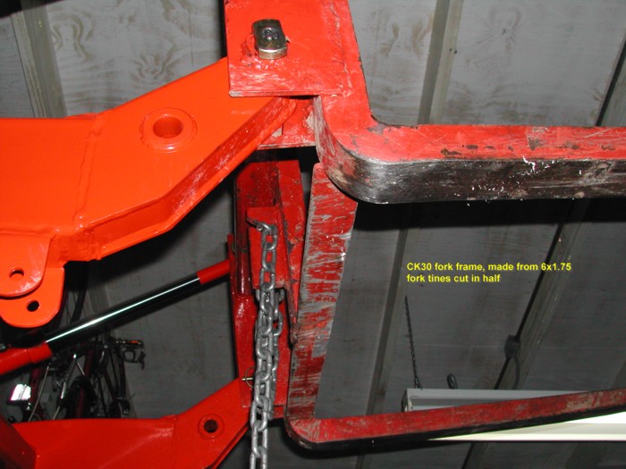

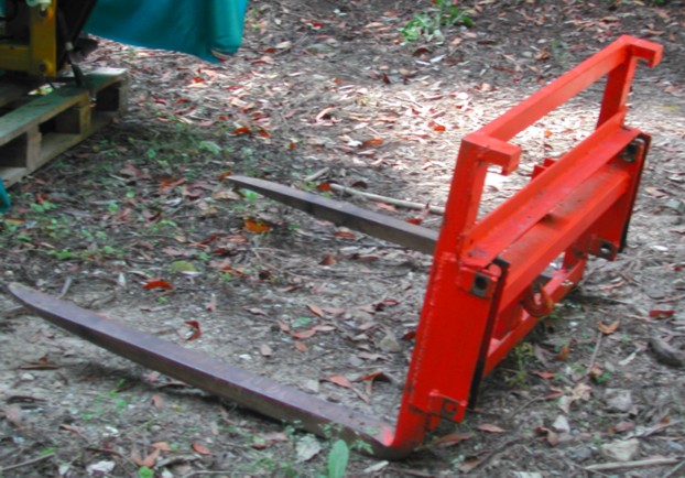

3RRL said:
I'd also like to see more shots of those forks when you get a chance.
Here is the first set of these I did for my earlier main tractor (Kubota).
The fork tines were 1.75x6 originally and were HEAVY. I first adapted
them to hang from my FEL bucket, then decided I do not like bucket
forks (can't see what you are doing!). I paid a steel warehouse to
use their large plasma cutter to cut the forks the long way. Then I
welded up a pin-on frame with lifting hook. Works great!

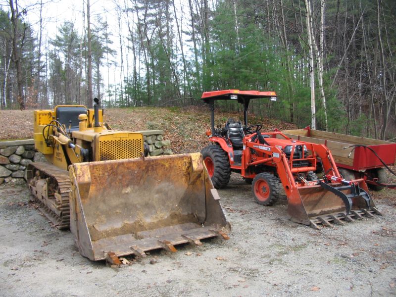

Here is a picture of a side by side comparison of a 1 1/8 cu yd dozer bucket and a 60" Kubota bucket. There is a BIG difference.

My first impression of seeing your new bucket was to think the front should have been a 6" to 1' high lip. Since you are not pushing this into a pile, it doesn't really have to have a thin lip, does it? I think it's a terrific idea for all kinds of carrying jobs, but I think if it is sitting flat on the ground while you are filling it, you may have things falling out the front until you get it curled back. That's my only suggestion on what seems like a great idea to me.:)
