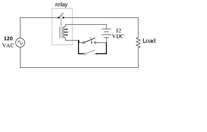

Our garage has two doors and two openers. We usually close the garage door and walk into the house thru a door in the center back wall of the garage. The lights on the openers are on their front and so the back of the garage is always gloomy if not completely dark. I want to put a single fixture over this door that lights with the garage door lights and goes out with them. I would probably be better off getting two cheap fixtures side by side wired to each opener. RSKY

I think it could be safely done with a low voltage circuit triggering a relay to operate the light. You could install a alarm contact/reed switch next to each door with a magnet on the door(s) to trigger the relay.
Like this:
