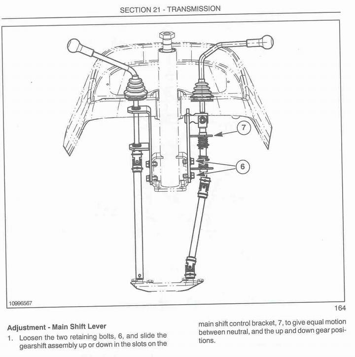

I have a one year old TC40. The H-shifter to the right of the steering wheel and the 4WD lever that pulls strait up on the left side of the seat are very VERY difficult to engage. The H-shifter is getting stiffer every week. The 4WD shifter is completely stuck and I can't get the tractor out of 4WD.
Is there a lubrication point for these two shifters that perhaps I've missed? Do I have to take the cowling off below the steering wheel to get to a lub point for the shifter?

I checked my Repair manual and it shows you shifter is mounted to the steering column and the shaft has two universal joints. There is no mention of lubrication, so my guess is that something may be out of adjustment. Is your tractor still under warranty? The bracket attached to the steering column is supposed to be adjusted up-and-down so you have "...equal motion between neutral, and the up and down gear postions." You will have to remove the cowling to get at the shifter. There are two visible bolts in the operator platform area and two more on the "firewall" under the hood. The diagram looks like you only have to take off the right-hand cowling if you want to check out the "works" yourself. I hope this helps. Another member who has the same tractor as yours is Mike (Mikim) but I'm not sure if he has a email shown in his profile so you can PM him. He might know something in addition to what I've found.
   / Ooooohhh, I need help with my shifters #6
Check out the attachment for a drawing of your shifter assembly.

Thanks for the diagram!! That's very helpful. I'll take it apart and check it out. Yes, it's under warranty, but I have no practical way to get the tractor back to the dealer. If it's a simple lub problem or a simple adjustment, I'll attempt that before I pack it in and take it back to the dealer.
The 4WD is working much better now. I did as the other fella suggested and rocked the front wheels up off the ground using the FEL and it shifted very easily. I've worked it a few times since and it seems to be playing nicely now.
