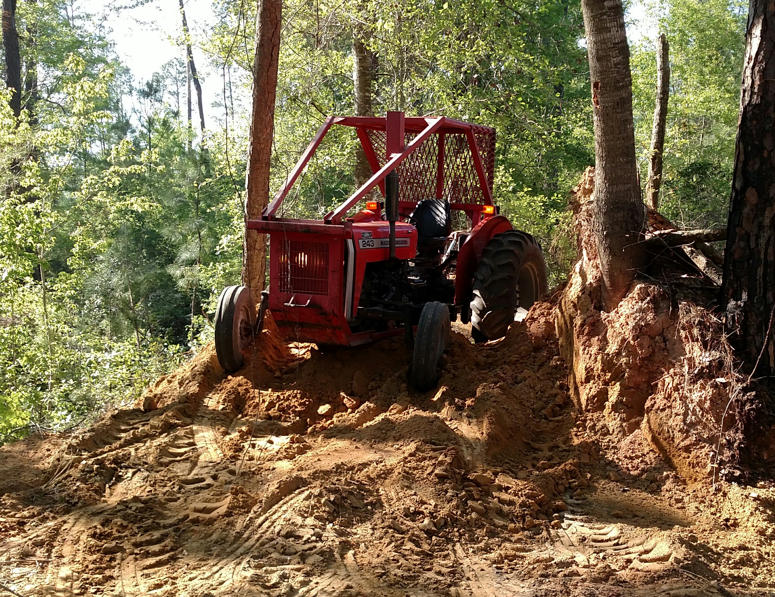

Good Evening Folks:
Like the title says, oops, I did it again.
The exhaust system on my mf 65 comes off the manifold and runs under the side of the tractor and out the back. I managed to rip out the exhaust pipe from the muffler back. I have no idea what I caught it on.
I have noticed mf 65's have two ways of venting the exhaust: out the back under the tractor or straight up. Does it make any difference which way it is vented? If the exhaust was originally down and back, can I change it to a straight up without any issues?
My acreage is primarily forest with some pretty rough ground with all the deadfall. Since I now have to replace the exhaust system, I am thinking of doing it straight up rather than down and back. Any advice would be greatly appreciated.

I like vertical exhaust on haying tractors but horizonal for most. #1 problem with vertical is rain entering and damaging engine. #2 is exhaust fumes hitting in face. 3rd is louder. Vertical is twice as likly to be torn off when operating in the woods.

My MF 231S has a vertical exhaust. As for rain, a Molson beer can over the top of the pipe remedies rain damage (drink the beer before installing the can).
Next, as mentioned, it will be louder but, I use ear muffs hearing protection or listen to music with a headset cancelling out most of the exhaust noise.
Most vertical pipes have a curve at the tip to deflect the exhaust away from the operator. I am never bothered by fumes.
I do have some low branches that I trim to preclude contact with the exhaust and my head when mowing around trees.
I like to be able to observe the exhaust when cold starting the diesel engine and when the engine encounters a load.
I also have changed the colors of the pipe and muffler, silver, copper, black...next, I think I'll have it ceramic coated.
If you go vertical, you'll likely see no performance difference. The vertical is a straight through system on my 231S.

You can probably get a verticle muffler manifold realitively easily from the MF dealer.
Some manifolds have a water drain in them (MF135)to fit the rain issue. Also there are after market exhaust raincaps.
Last alternative is to put a bend (30 - 45 degrees)in the end of the exhaust, so rain can't enter. Turn the bend away from the driver seat as this helps reduce the noise.
