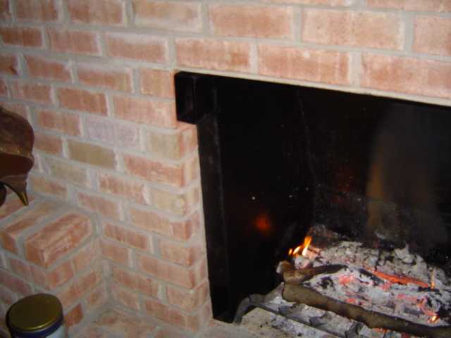

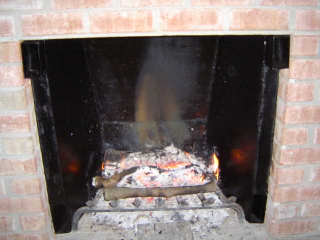

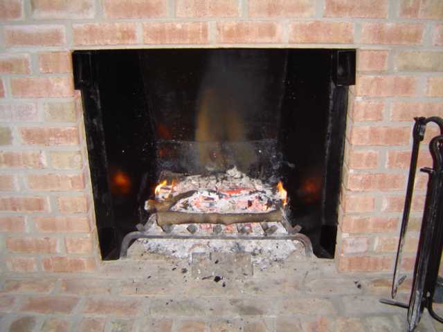

The fireplace, which I built in my "marital residence" had a Heatalator insert, where the back and sides were double walled steel. It made a lot of heat, however it came down to the fact, that I could use the heat, but couldn't be there all the time to watch and tend the fireplace. So, I eventually, installed an airtight wood stove in front and used the chimney.
Where I live now, I built a regular masonry fireplace, which burned like mad, but didn't throw that much heat. So ... I built a double sided steel insert (similar to the Heatalator), with front, top and bottom sealed, to slide into the fireplace. The outer wall fit right against the inner firebrick. The inner steel wall is 3" from the outer wall. There is a pair of openings at the bottom for cold air in and a pair of openings at the top for hot air out. I also included baffles between the two steel walls. This insert made a huge difference in the heat output of the open fireplace. I had gotten glass doors, but the directions said "the doors has to be open, while burning". Since I would have to modify them to fit, I took them back.
I like it! :thumbsup:
Also, note in the pictures, there is an outside air damper in front of the fire.
