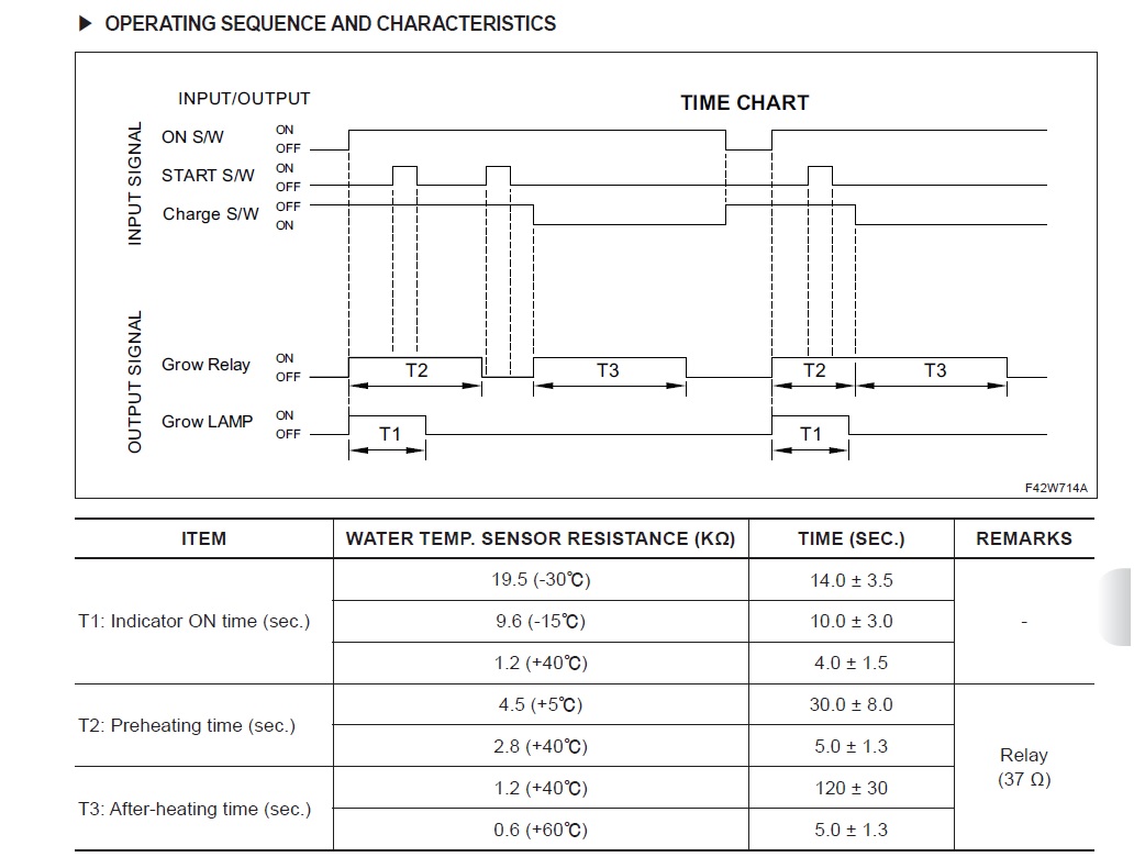

Do the glow plugs continue to heat even though the two lights go out and the key is held in the glow position on an rk37?
   / Operating key to glow on a rk37 #2
Page 2-12 of RK37H operator's manual: "(7) Preheat indicator T h i s c o m e s o n w h i l e t h e engine preheating function is activated. It goes off as soon as preheating is completed."
Sounds like it has a timer on it.
My NH has a timer- and relay-controlled glow-plug cycle, which means if you want to warm them more than a few second, you have to turn the key off to reset the timer and do it again.
I have yet to mess with pre-heat cycle on my RK55H which sounds a little different - page 4-2 of my tractor's manual: "8. Operator need to turn key to the "ON" position. The glow circuit automatically activates. Operator need to wait for glow light to turn off .As the lamp goes off turn the key to the start position to start the engine."

To really KNOW whether the glow plugs are getting power connect a voltmeter to one of them and the other voltmeter lead to ground. It will indicate when the glow plugs are receiving power. Of course a test light will do the same thing.

Most of these newer tractor will use a glow plug controller.
Once you put the key to Run position, it will cycle the glow plug for X amount of time, then once you start it, it will do an after glow for X amount time also, even though the glow plug light if on.
The time that the glow plugs will work, varies accordingly to the coolant temperature.
Here is an example from my tractor manual but I would say it's the same for the Korean tractors:
