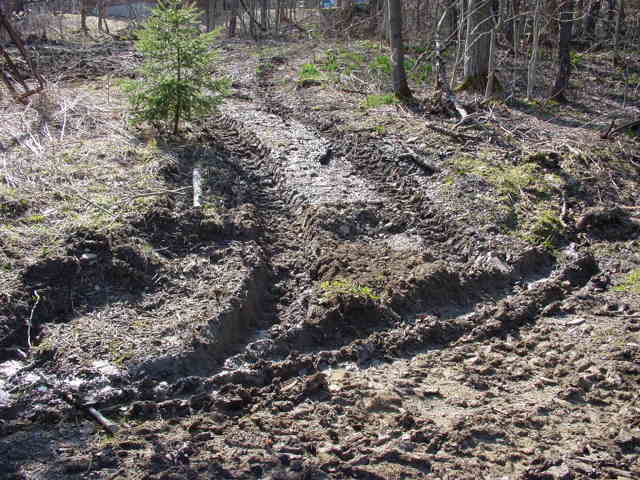

I run mine in 4 wheel drive 90% of the time at my place. It's always slick and I'm always in the grass or mud. I would more about tearing up the lawn when turning then I would about wrecking the gears in the tractor. On lawn etc the drivetrain won't bind because the grass will give. Just like driving a 4 wheel drive vehicle, Jeep etc with the front end locked in. Use your head. If the wheels can't slip don't use it. Concrete, pavement etc. 4 wheel drive diff lock and a prayer needed prior to this pic....

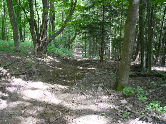

I used diff lock only a few times myself as I was backing up my firecut in in 4H reverse ready to drop the box scraper when traction was lost. I have a hill about 40 degrees for about 120 feet that is really scary going up. I back up it because if I lose traction I drop the box scraper and level an extra 5 ft behind my wheels and haul up there again and again until I get to the top. Going forward I would be scared to flip and if I lost traction I would sure have a stiff neck backing down. When I got to the top I put 6 hrs on the tractor because I had fun dragging the trails and didn't know when I'd make it up there again.
   / Operation in 4 Wheel Drive? #8
Heres a few pics but it really doesn't put the angle in perspective. I hold on the hangrips of my quad tightly let alone my tractor.

   / Operation in 4 Wheel Drive? #9
Another.
I have a lot of pics on my website under the tractor album if you care to view it. I think there is about 40 or so pics.
